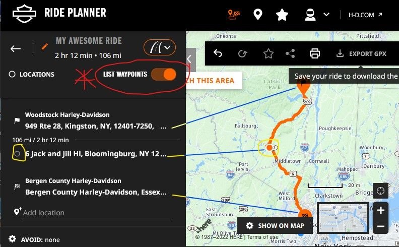

Originally Posted by Highwayman99
I created a Ride Plan on my laptop in the Harley Davidson Ride Planner program with roughly a dozen stops identified on it. I transferred it to the bike though my phone like I read to do. When I tried to use it while riding it only displayed the starting point and the first stop then it showed the ride was complete when I reached the first stop. In the map view on the bike display I can see the full route with all of the stops and each of the stops are in the Saved list. What did I do wrong?
You likely made one or both of the following mistakes.
1.When creating the route, in most cases you only want two "destinations" the start point and the end point; everything in between should be way-points.
(If you use multiple destinations, when you export it from the planner and import it to the bike, it creates a ride with multiple parts, which is a PITA).
In the diagram, Jack-and-Jill hill is a Waypoint. To see Waypoints, you will need to flip the toggle.
2. When importing the ride, via USB or through the phone, to the bike (or when you choose the route to ride on the Boom.. I don't recall when you are given the option) be sure to choose the options "Select All" (I don't recall the exact wording, you will recognize it).
Otherwise, it only gives you what you selected, and most of the time, you want the entire ride. (I tend to use the USB).
After doing it this way a few times, you may want to experiment with adding a 3rd destination in the middle, e.g., where you will have lunch.
When doing multi day rides, I create 1 route per day.. the routing app gets very sluggish after adding about 12 waypoints.
One thing (I call it a bug) is that the router app and the H-D nav system use different algorithms for mapping the the route between waypoints. The Boom 6.5 seemed to prefer shorter routes than the planner, the GTS seems to prefer going out of the way to find a highway (if it is not too far out of the way) than the planner.
