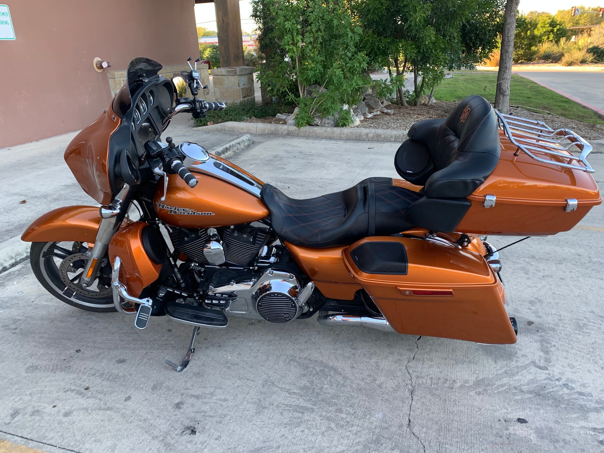

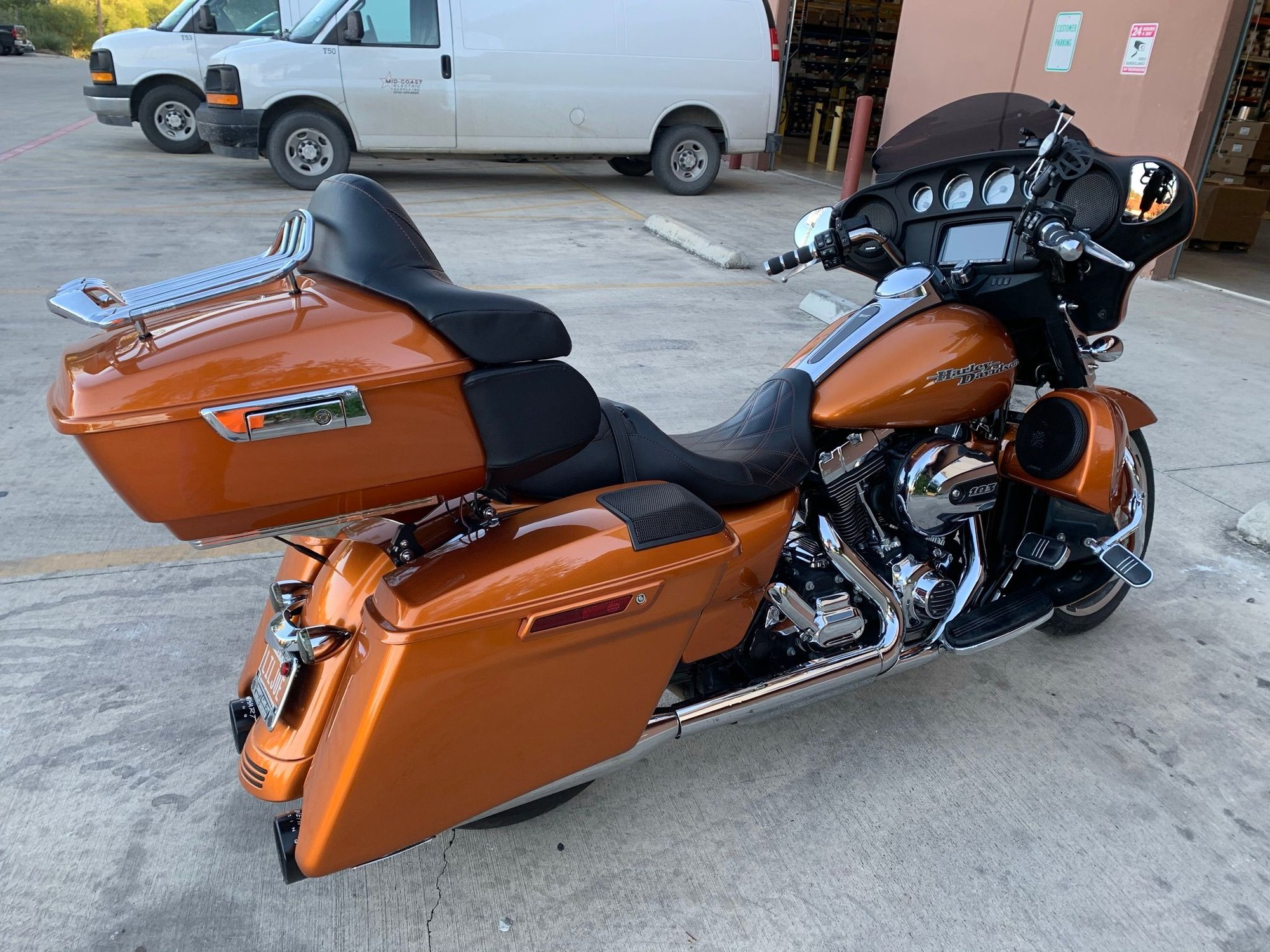

Z
I was running 8 speakers on the 1 amp.
