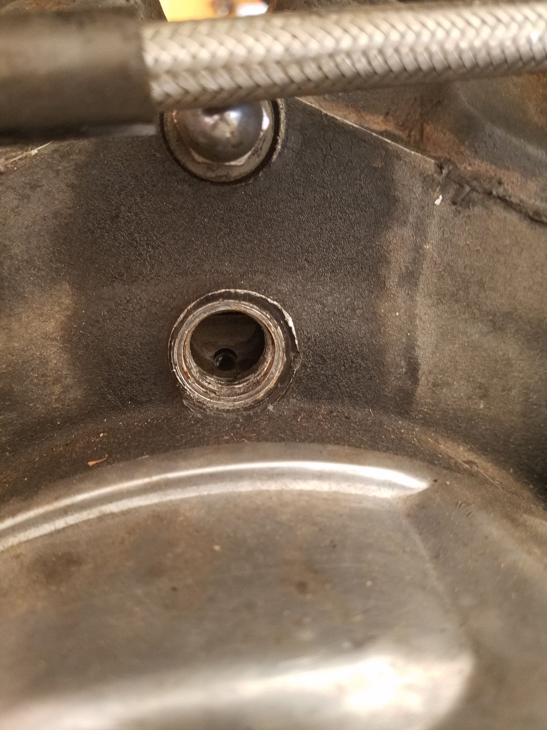

I have a 79 fxe. And have 3 marks on my flywheels im uncertain of which one is what...... everything online is very unclear. No solid answers in the book or online

if you have the flyweights full advanced ,you looking for the vert line when the points just open .If you doing it with the flyweights collapsed use the single dot for the front cylinder
