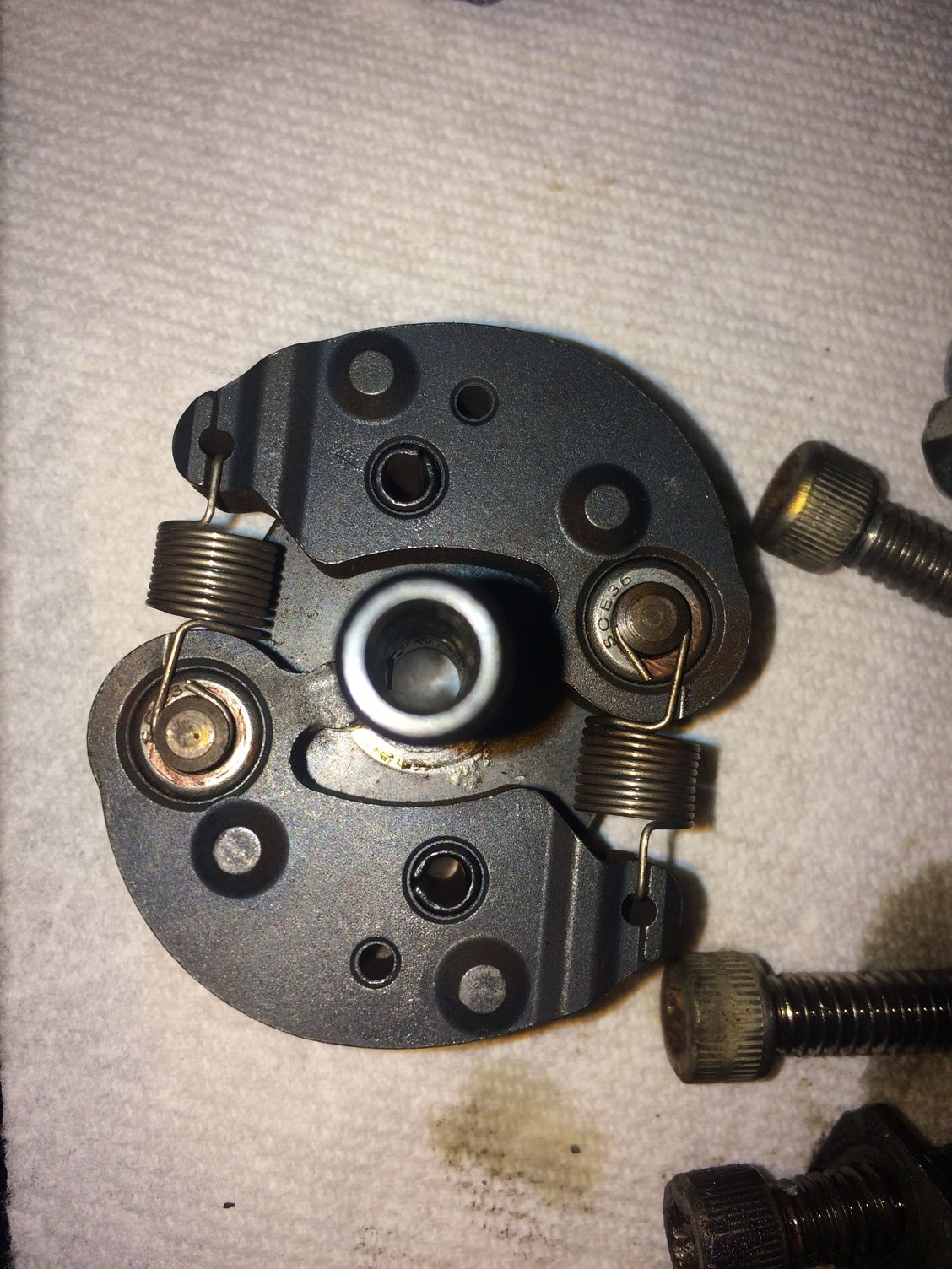

I've seen a bad advance unit act the way you describe. I did not see the condition of the centrifugal ignition unit mentioned in your post. I've changed out worn ones for new and it was like night and day with the way the motor starts and runs. Might be worth a check-see/ change out.
Also, hard to believe no flywheel timing marks, especially for full advance, front cylinder. I'd look into that farther too. Should be about 35* BTDC
I致e played with the spark advance a little, challenging though without the TDC mark. I致e taken the plugs out, put a skewer stick in the front cylinder and gotten pretty close to TDC, no mark. I called Truett and Osborne the other day, they said there痴 no way they didn稚 put the advance and TDC marks on the flywheels.
As for the advance unit, I checked it today, the springs seem tight and the weights snap right back. Not sure if replacements vary in weights or spring stiffness, I値l need to do some research. I致e attached a photo of the unit
^^ Good advice... and it is Not that difficult to find TDC... pull a Plug!!!
Do Not kick it so Damn hard... especially if it has a Bit of Compression... a well tuned '80" mid to high compression Shovel, is likely to Start just rolling over to find "Stroke"... Walk up to it and simply put the boots to it like a DirtBike????= Failure...
