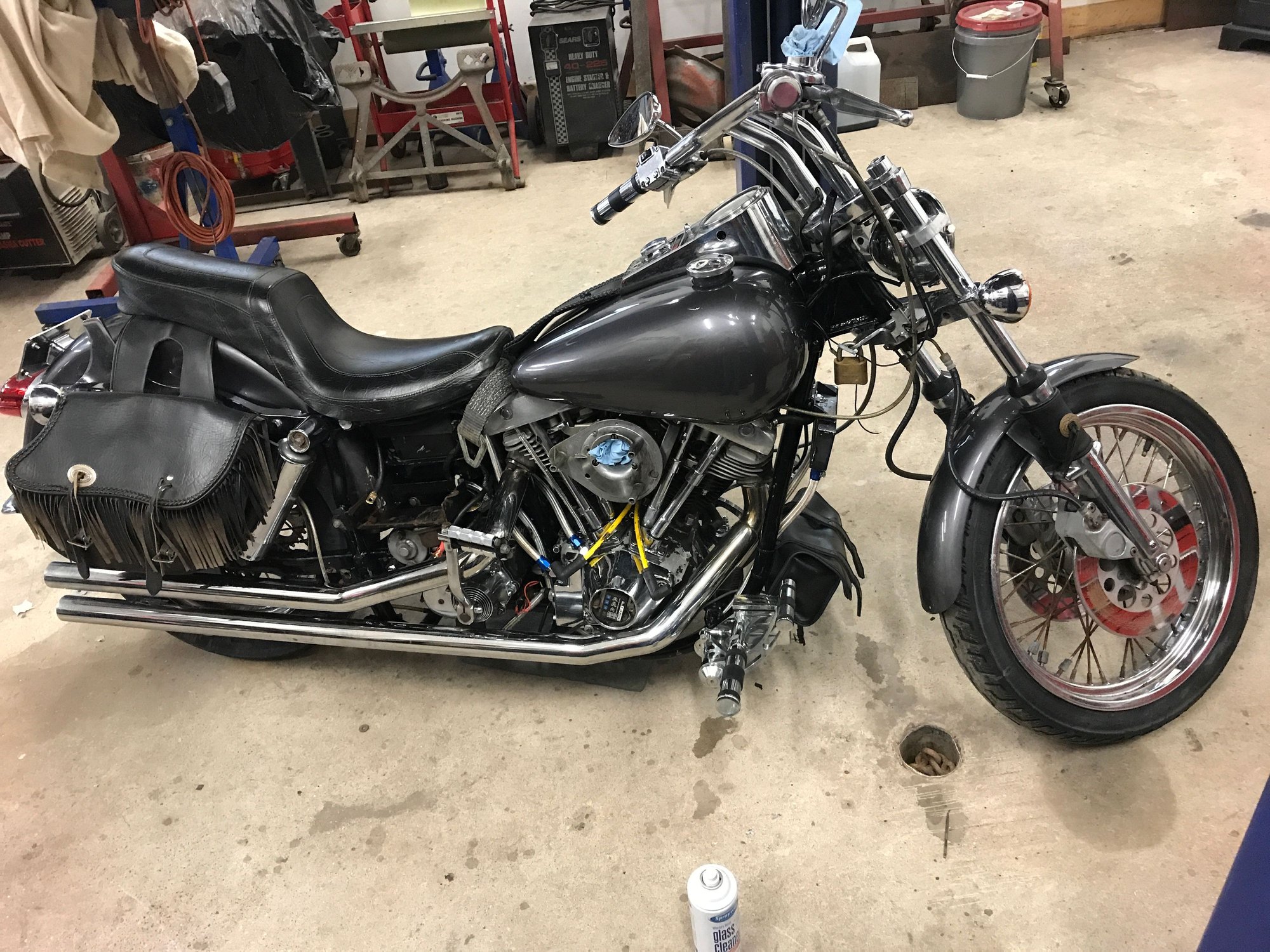

Figured I would post this ole dawg on its own instead of high jacking others posts.
Made a deal for this 77 that was left to rust in a barn for 20 years....3 hour drive later it was home hanging from the cherry picker and get hammered with pressure washer

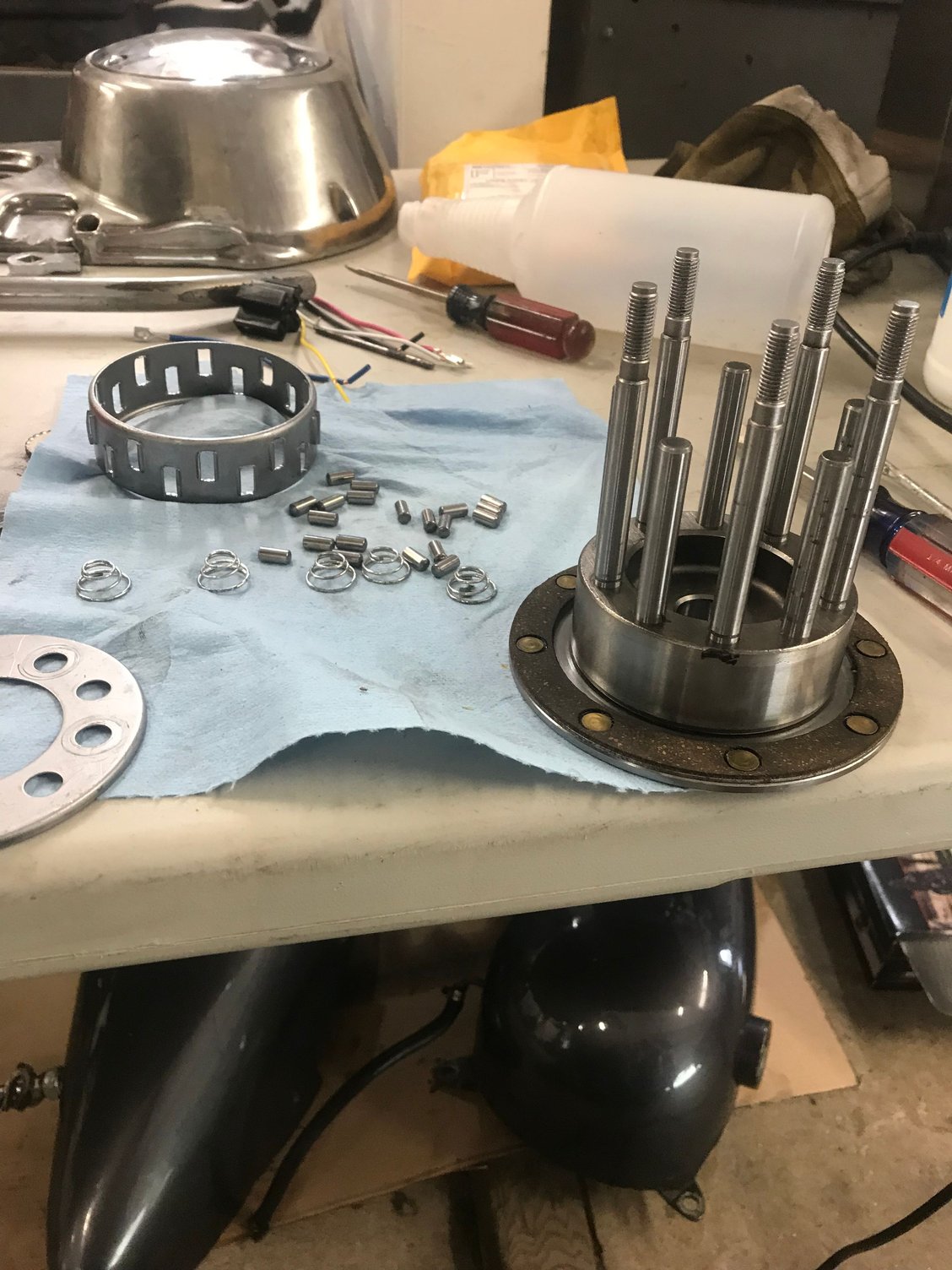

As it rolled n shop after serious degrease and pressure wash. Than all the garbage that I don’t like started coming off. Tanks pulled and soaked.

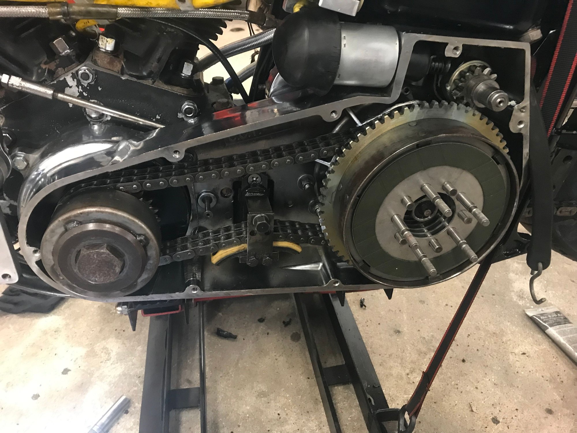

Starter was locked in would disengage....told it had a new dry clutch..lmao.....must had 2 quarts of 90gear oil in primary .
pulled apart and it must have had 4 open holes in inner primary. Tapped and plugged them all.except breather.
Rebuilt starter. Got lucky it had a brand new starter drive...again installed wrong...
Turned arm in lathe and cleaned up.....did buy a new solenoid it was cracked and a mess. Had a new ring gear laying around so welded it to clutch basket after cutting ole one off that had a few teeth missing
