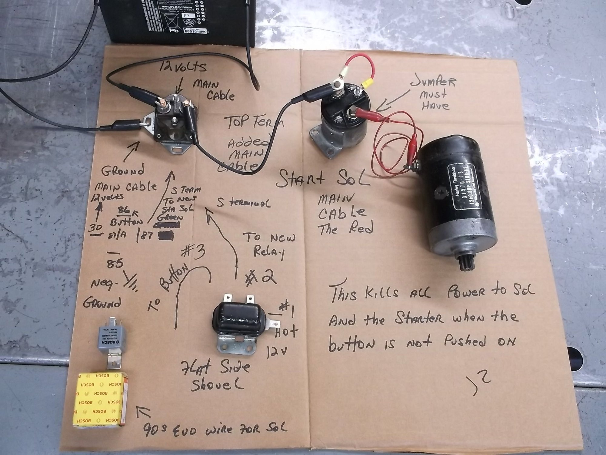

they do Make USA Bendix mid usa sells them - we also today re wire the system this way as it stops the run on when the solenoid sticks
