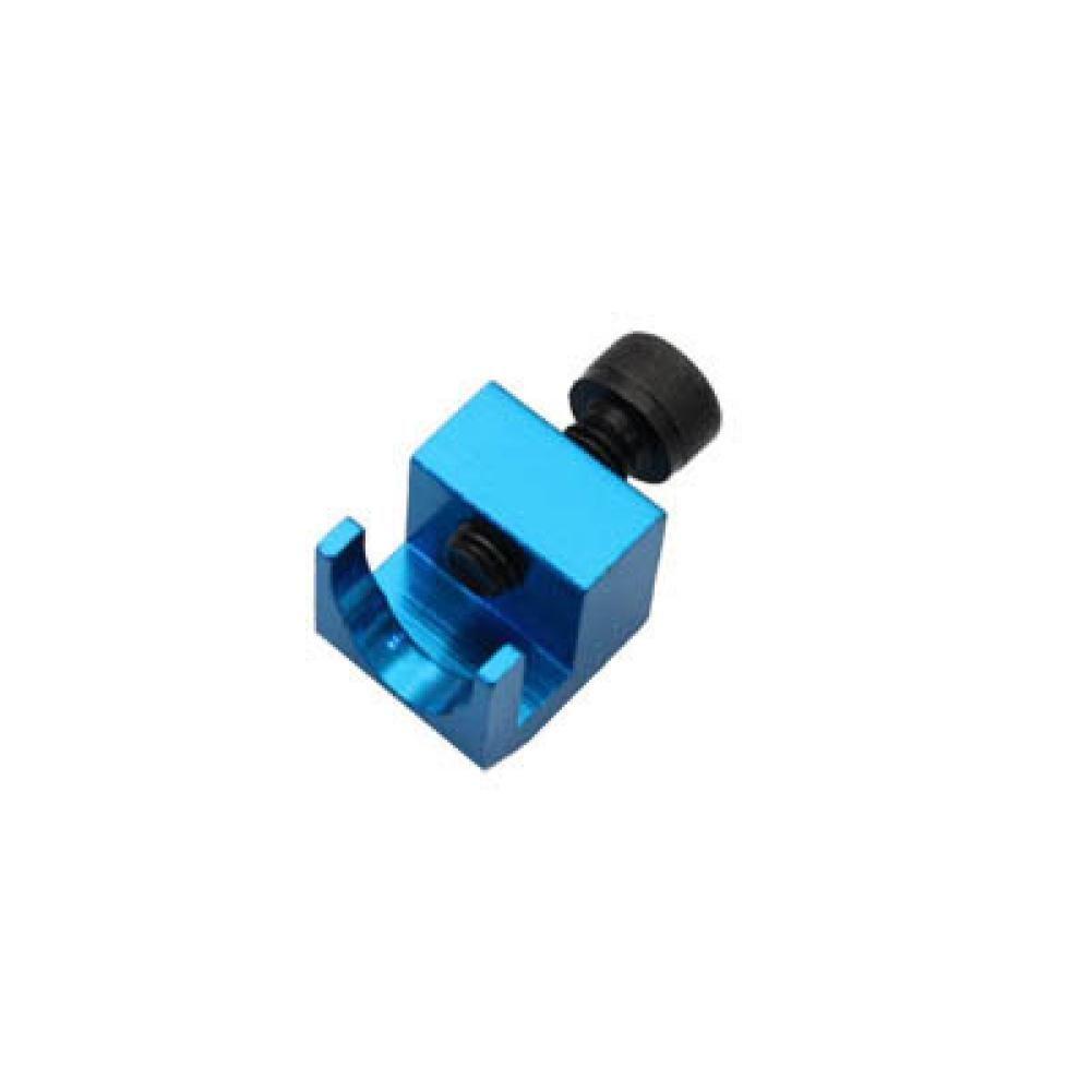

You do Know there is a Tool for Holding the advance unit at Full... No Drilling required... Looking for a Picture... looking at it reminds of the old "beaver tooth" chain tool!!!

No cone motors with weights in my garage, but yes, I do know about it and vtwin sells a knock off pictured below. Looks like it might also work with a timer. I generally don't have much problem static timing enough to get it to start and then using the kicker to dial it in the rest of the way.
Tool is $25 and wait for it to be delivered, drill bit is in the drawer for immediate satisfaction.
