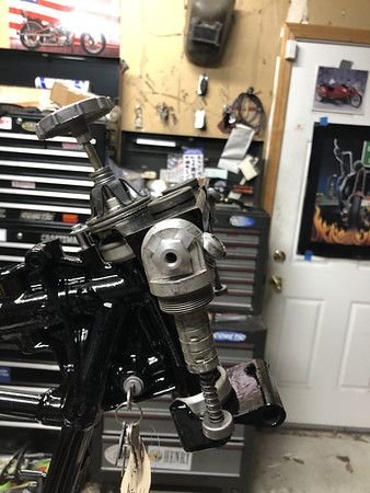

As said they aid stability to the front end when a sidecar is attached to the bike. It is not a "de-rack". In use it extends the front end. When not running a hack the rider must readjust and bring the bike back to stock configuration. It came into use in 1950 for Pans and continued thru Shovel FL/H models.
Upper & Lower triple tree. The bolt on the bottom allows for the needed adjustment
Plugs for the slider tubes are different from non-adjustable trees. And using adjustable trees necessitates the use of a steering damper when running a hack. Once assembled it looks pretty much like a normal front end.

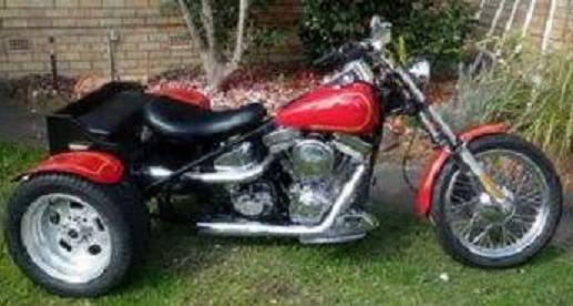

would you agree my trike would steer around corners easier if it was de raked somewhat. the rear end works as it should
Old Sep 25, 2021 | 06:56 PM
johnjzjz's Avatar
johnjzjz
Posts: 12,878
Likes: 5,448
From: la la land jerzey
NO
you could invite a wobble
put 40 pounds of air in the front tire - try that
Old Sep 25, 2021 | 07:22 PM
john lee's Avatar
john lee
Joined: May 2018
Posts: 2,159
Likes: 432
From: australia
Originally Posted by johnjzjz
NO
thanks john that makes sense ive been running 30-32 i just thought maybe i could run a more rounded tyre
