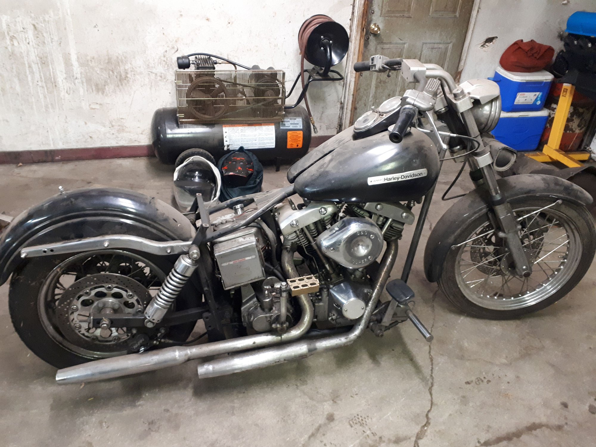

From: Ontario Canada
Dug this out of the back of the shop today after a 10 year hibernation. The engine is blown so I might start a thread when I discover whats toast and do the engine again when I get to it if anybody is interested.
