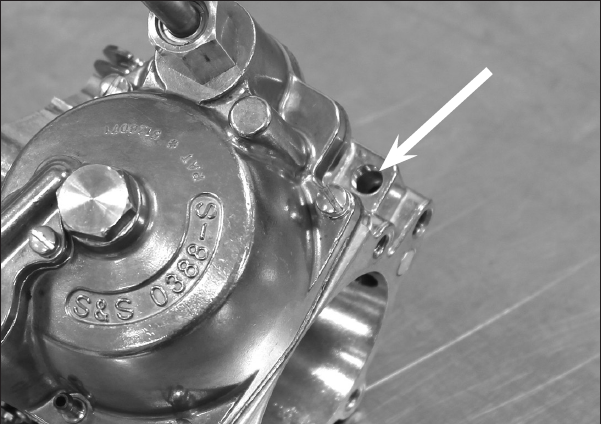

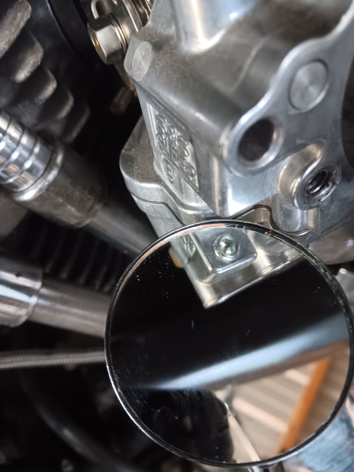

If my carb has an air cleaner, which it does, shouldn't this screw be removed to allow air flow??
The screw shown in the mirror should be removed if the carb has an air cleaner right!?
Old Jun 26, 2024 | 05:44 PM
Ohio HD's Avatar
Ohio HD
Joined: Mar 2012
Posts: 985
Likes: 948
S&S says no.
