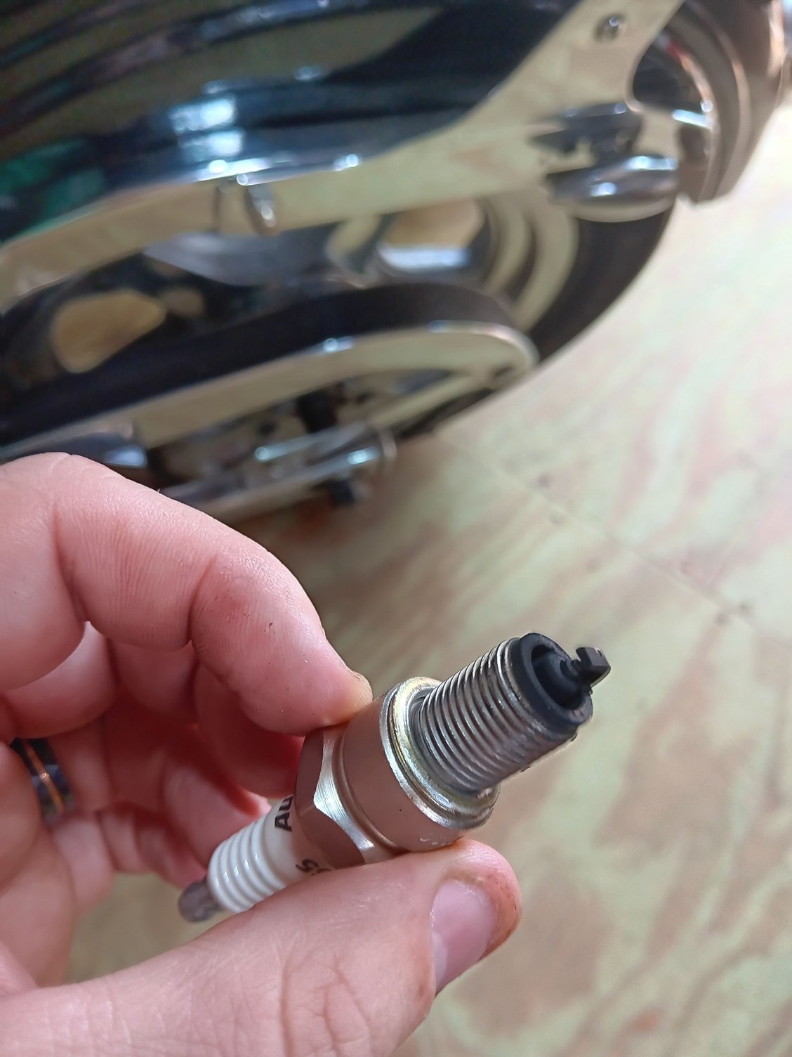

Here are what the plugs look like. I couldn't post a pic sooner because I didn't have the tools. This is off the front cylinder. The back is no different other than it was soaked in gas as well.
It's going to be a project and that is fine. I have the service manual and just about every tool I need now. I can get others as I go.

Originally Posted by DeweyCrowe2
When I first got my bike it had a Super E on it and the wrong manifold for my heads. My heads are the O-ring style and it had the straight manifold and band seals. When I stroked it, the kit came with the carb and I got the right style intake then, with the kit.
Not just the wrong style. Lot of times they don't align evenly at the heads. Gaps or the meeting surfaces will be misaligned. Only been a few I've dealt with that ever went on without a bit of playing first. I'm overly **** about carb and pipes fit on shovels, seen so many with issues that get traced back to one of those two being the problem
I'll definitely look into the carb fitment when I get a chance.
