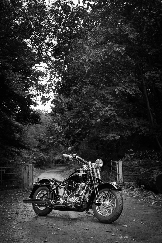

So - I've been waiting for all the registration docs to come back ..... they did this morning
Did about 2hrs getting used to handling and everything and it performed great - big smile time !!
Couple of issues ...
The engine management light came on about 4 times ... I stopped, switched everything off and back on and it was fine for ages - couldn't see any pattern and one time it just went out on its own ? Any ideas gratefully appreciated - nothing changed running wise on the bike that I could tell
On full RH lock the throttle cables brush the tank - I can't see any way of rerouting and have twisted housing each way to see if that helps - but it doesn't .. so any tricks to stop it marking the tank would be good
Couple of pictures .... Its got new black mirrors ... new black air cover and round black horn cover ... replacement OEM rear pegs ....
Bassani fishtails and Wild Hog seats etc are on order

Great looking Bike.......Good Luck with it !
