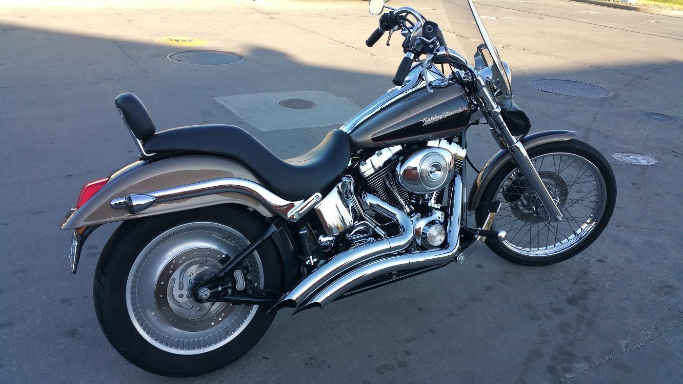

just got 04 deuce has vance pipes, if it had a tuner where would it be?

under seat

I assume it has stock air box, can u tell by pic?, programmer needed? seems to run good

What do the plugs look like? Do you get any popping on decel or between shifts? ALL bikes will benefit from proper tuning, stock ones included. If your air cleaner is stock, get a high flow one of your choice and get it tuned to complete 'stage 1'.

I agree needs an air cleaner and tune unless the program has been burned into icm.

no program under seat, just stock box mounted to fender under seat, looks like stock air filter? ill take lid off tomm see if filter is aftermarket or not, rode only 10 miles or so today as I got it late this evening, seemed to run fine
