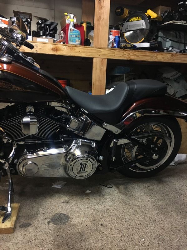

I finally did the 30/70 gearing on my Custom and it is awesome. Now it's just limited to the 96" motor which will change soon.
Anyway here is what I bought
25700337: black inner primary gasket set
83595-11: Tri Glide front pulley
40599-06: 2006 Night Train 70T 20mm rear pulley
17369-06: primary gasket kit, comes with all seals
9231: Inner primary bearing
Drag specialties 1/2" pulley spacer
I also bought the rear axle chrome spacer kit, put new tires on, new HD floating rotors, new brake pads and a new HD chrome front end kit (forks, spacers, covers) and rotors and pads. While I was in there I added a SE clutch spring, and Hayden M6 primary chain adjuster. As for the rear top belt guard I took other members advice and pulled the grommet out and used a small allan head bolt which lifted the guard for enough clearance.
Also the trans pulley is on super tight, I had to use an 18" breaker bar with a 4' pipe cheater on the end to break it loose. Also I did not pull the oil tank to reach the starter bolts, just pulled the oil tanks bolts out and used a long allan with a socket, worked no problem.
As for the VSS, I have a Thunder Max ECM so I just went into the speedo calibration part and added 8 teeth to the rear pulley number, because I went up 4 plus the 2 in the front equals 4 more on the rear, speedo works perfect. Now I just gotta tweak the 6th gear indicator.
