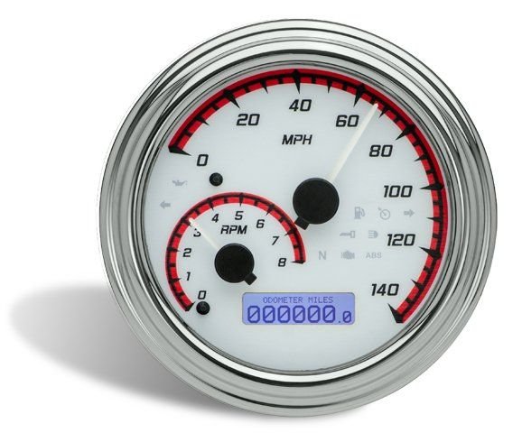

You know Dakota Digital makes an analog combo for the Deuce now?
It's pretty pricey but looks awesome.
http://www.dakotadigital.com/index.c...rod/prd977.htm
