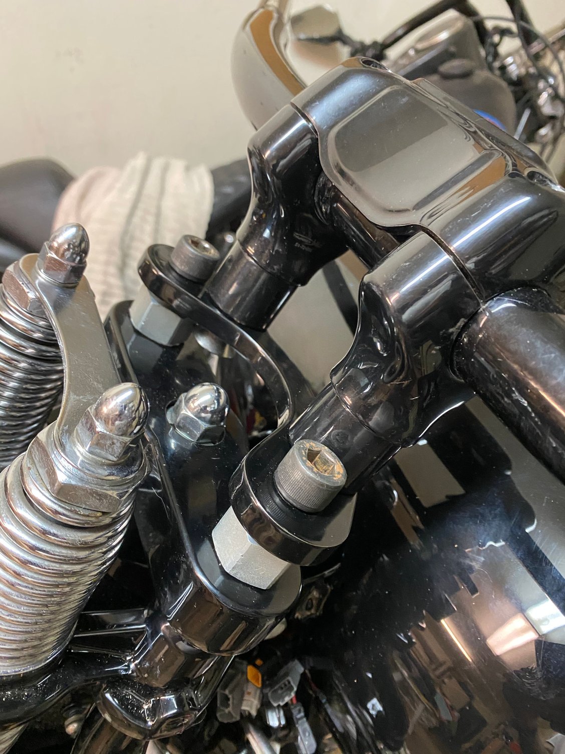

Springer is on ( Vulcan Rake stem fixed the HD De-Rake), Breakout Front Wheel, 5 Gallon FatBoy Tank, 2009 11” wide CVO Springer rear fender. Front Fender & Mounts will be here tomorrow
Ever wonder how to use the Breakout risers and Gauge on a Springer?

this one is taking a bit of time, all these parts weren’t made to work together. But, I’ll get the recipe down in time. Any Advice/Suggestions are Really appreciated. 😃
