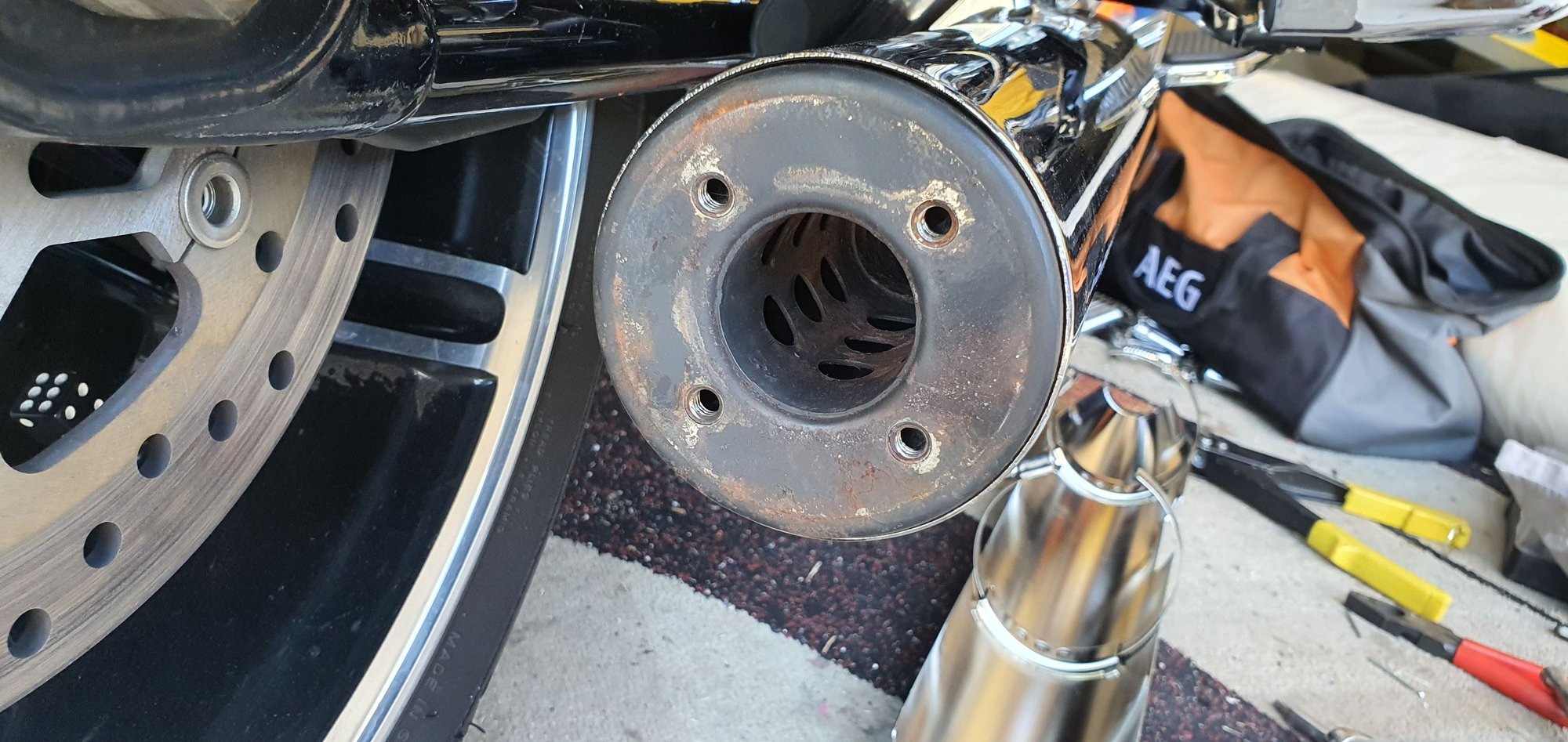

Definitely in the muffler:

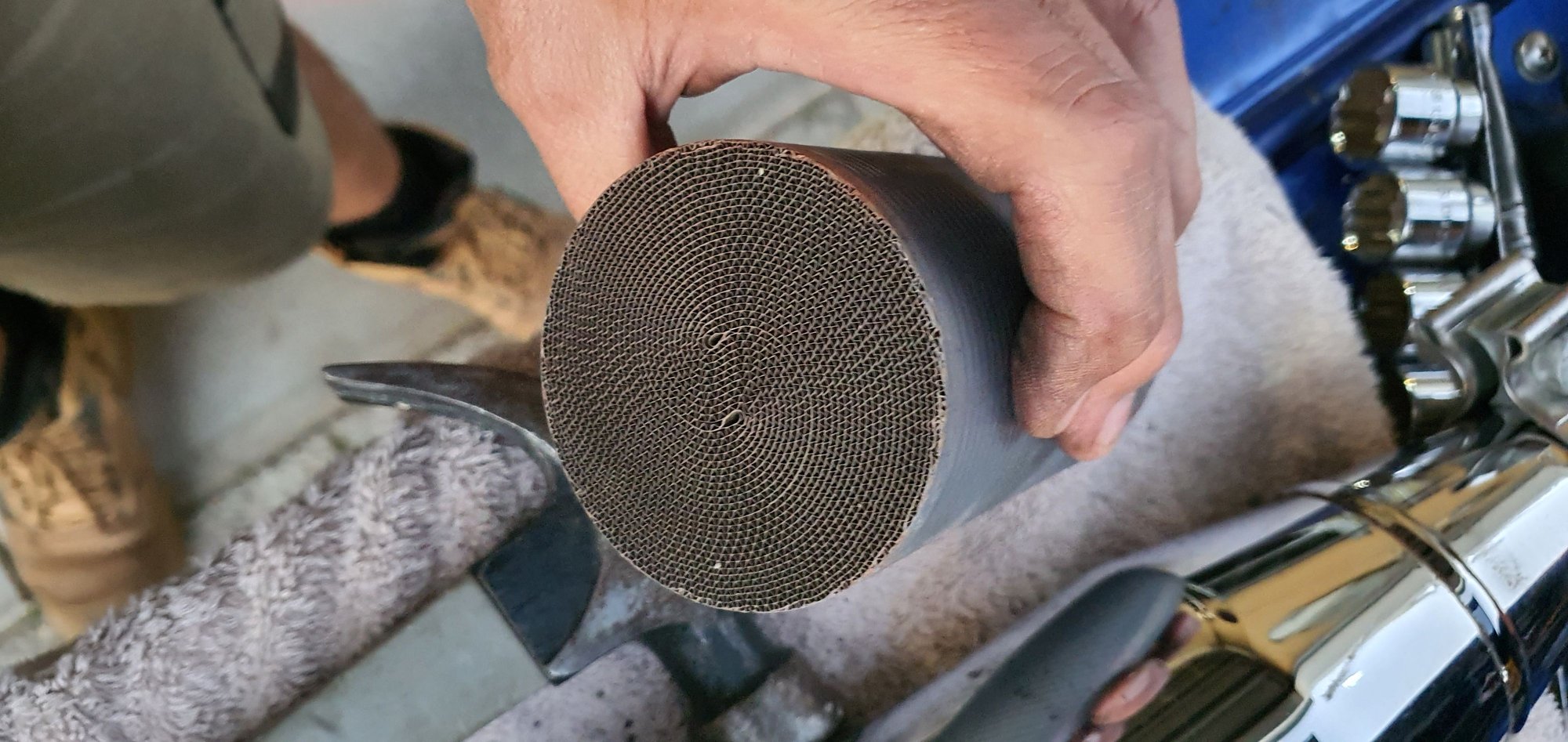

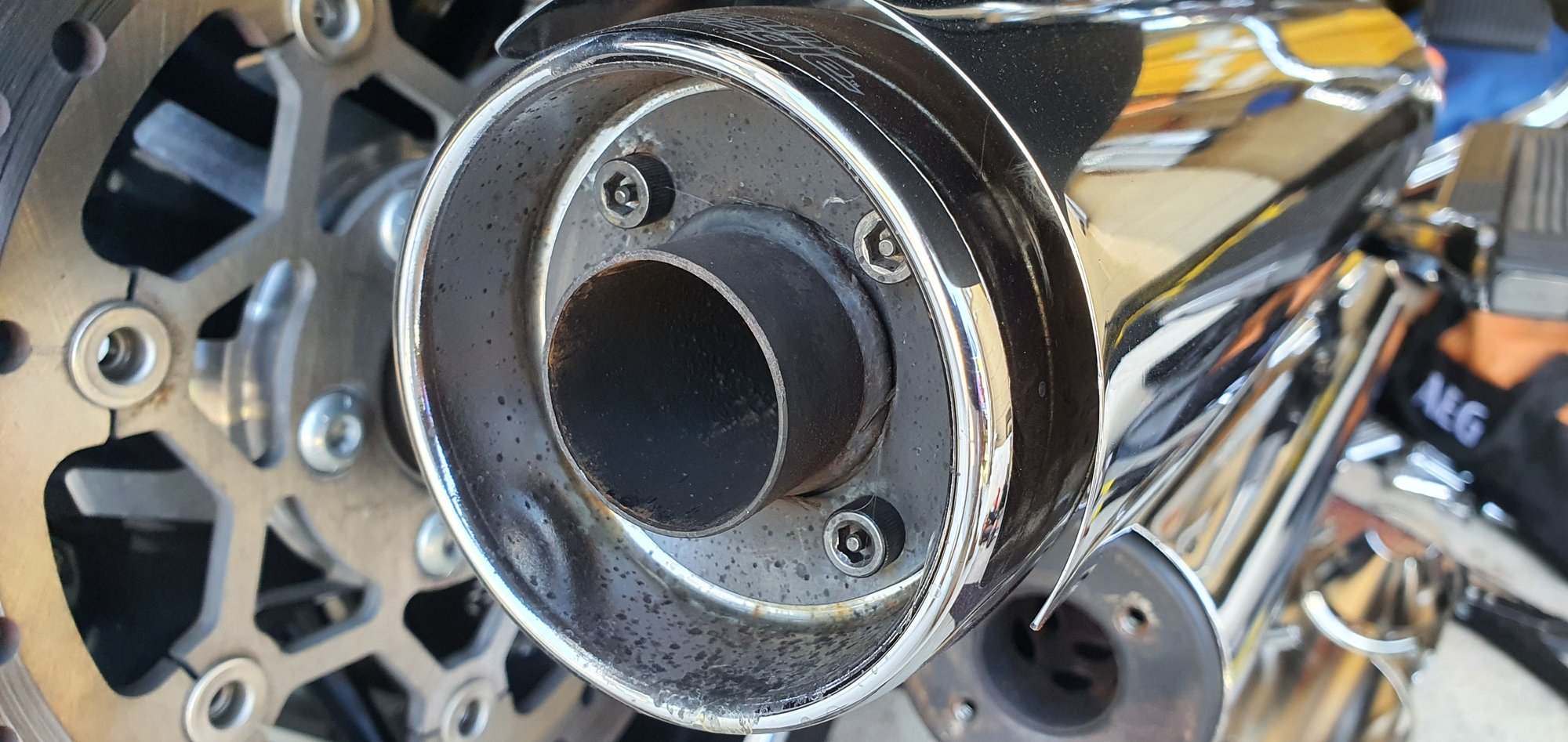

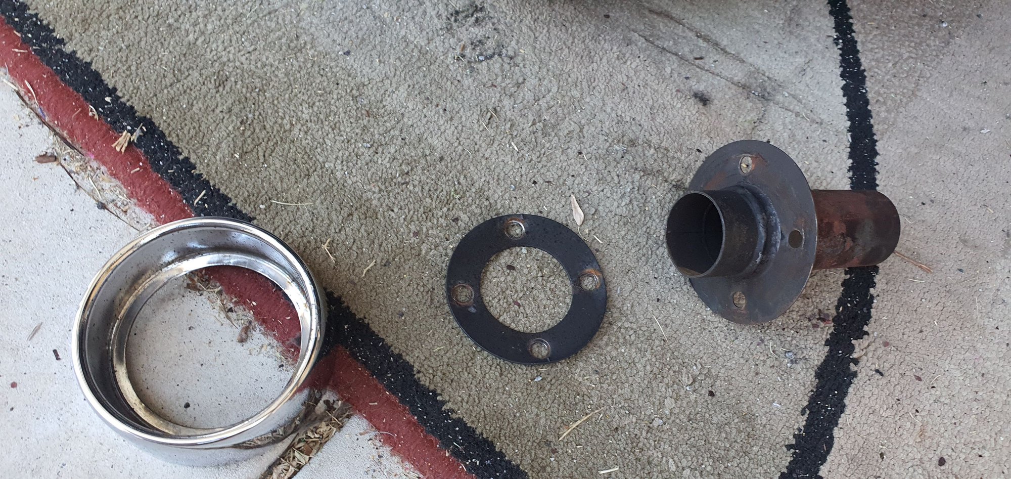

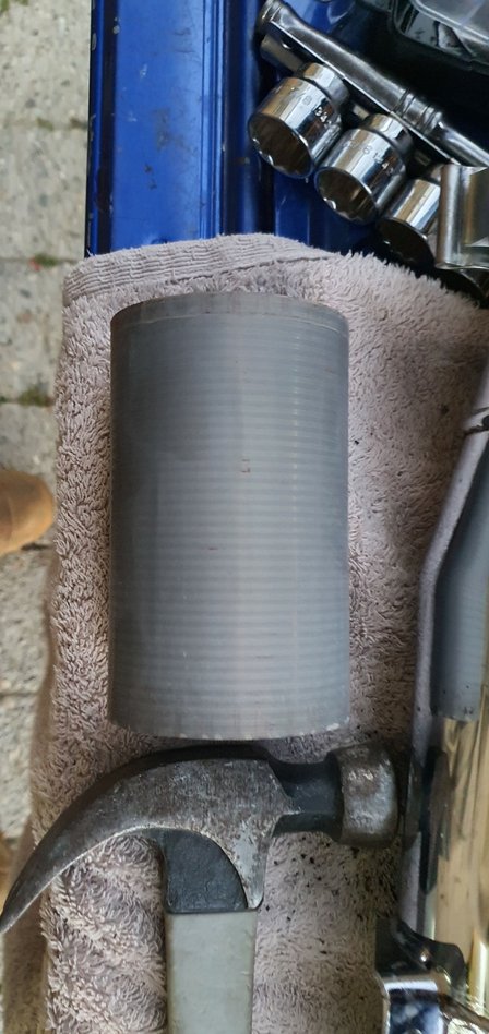

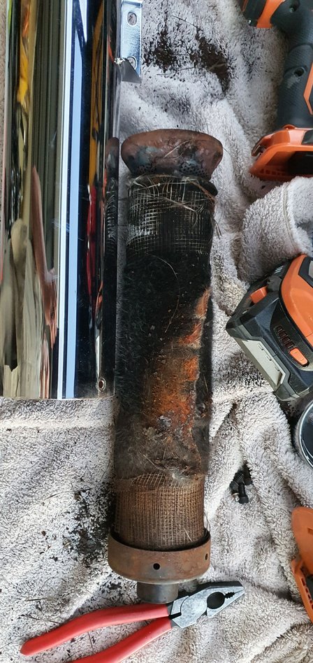

Ok ladies, the SE Street Cannons come in two versions, one with a DB killer and one without. It is removable by the 4 bolts at the back. Australia, California and the EU get the quiet version. Domestic US get the normal one...
