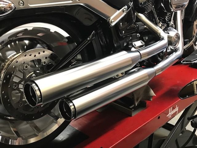

2018 Fat Boy Street Cannons DO have the cats in them....
'18 Fat Boy S SE Street Cannons Slip-ons
