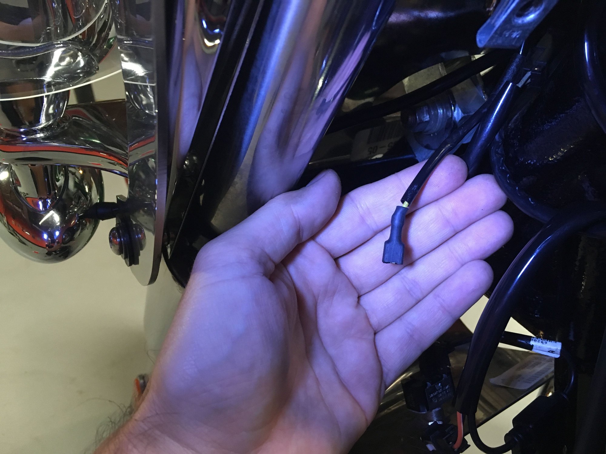

After installing the HD harness to allow the passing lamps to stay on with the bright headlight, my red dash light is on. I have have LED bulbs in the passing maps and head light. Not sunpie or daymaker but bulbs.
If I reconnect this power wire to the toggle switch, that the instructions say to leave off with the new harness, the red dash light will go off. So how do I fool the ecm into thinking the wire is plugged in? Would a in-line resistor correct this?
