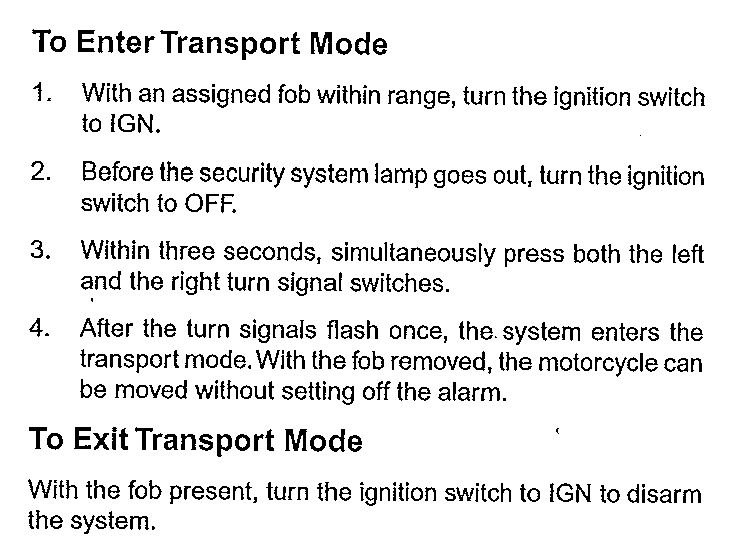

How to you turn the security system off on a softale in order to transport it?

Keep in mind that transport mode does not "turn the security system off". It simply disables the motion sensor only.
For my 2012 Heritage, this is from the Owner's Manual
