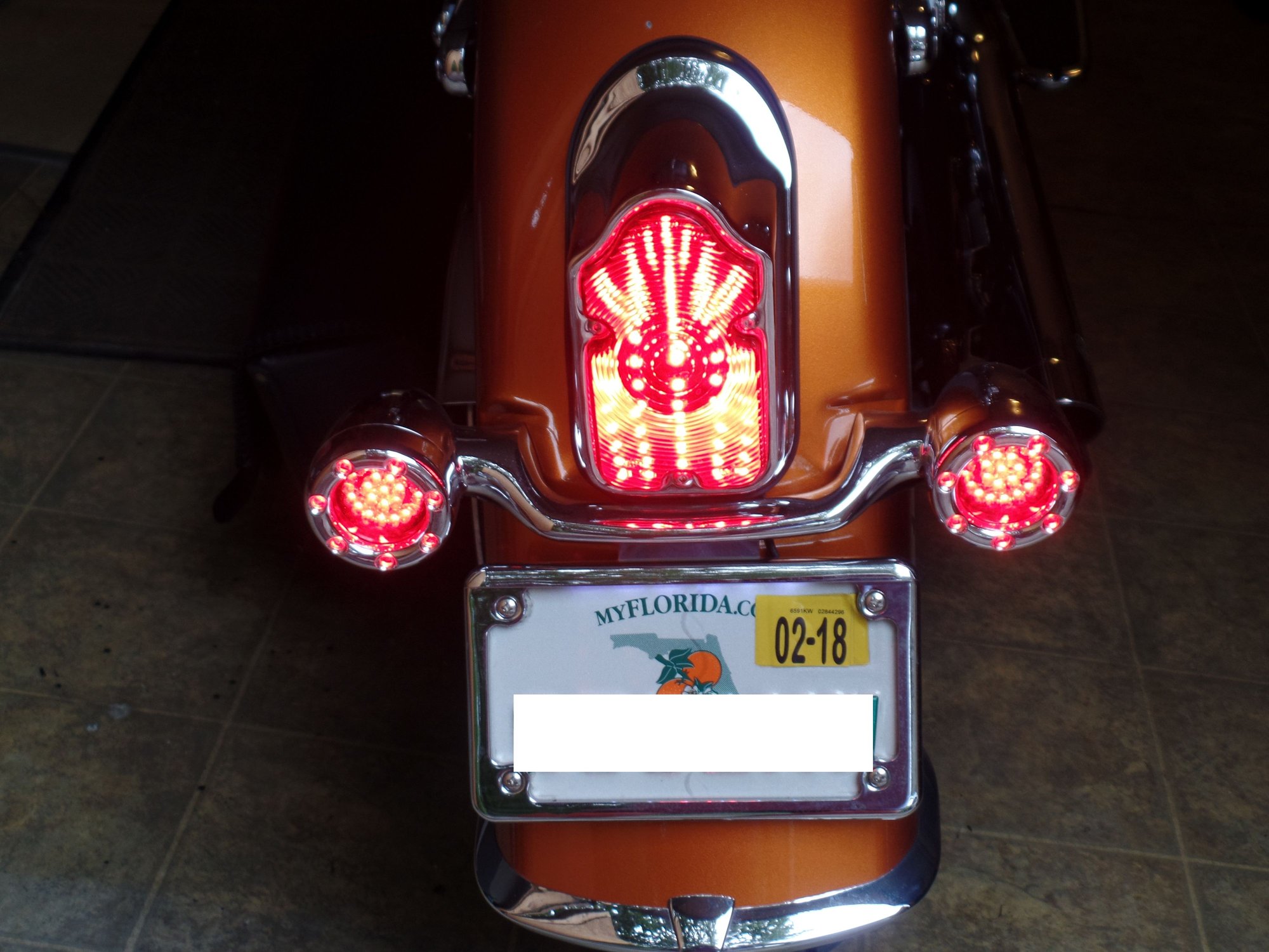

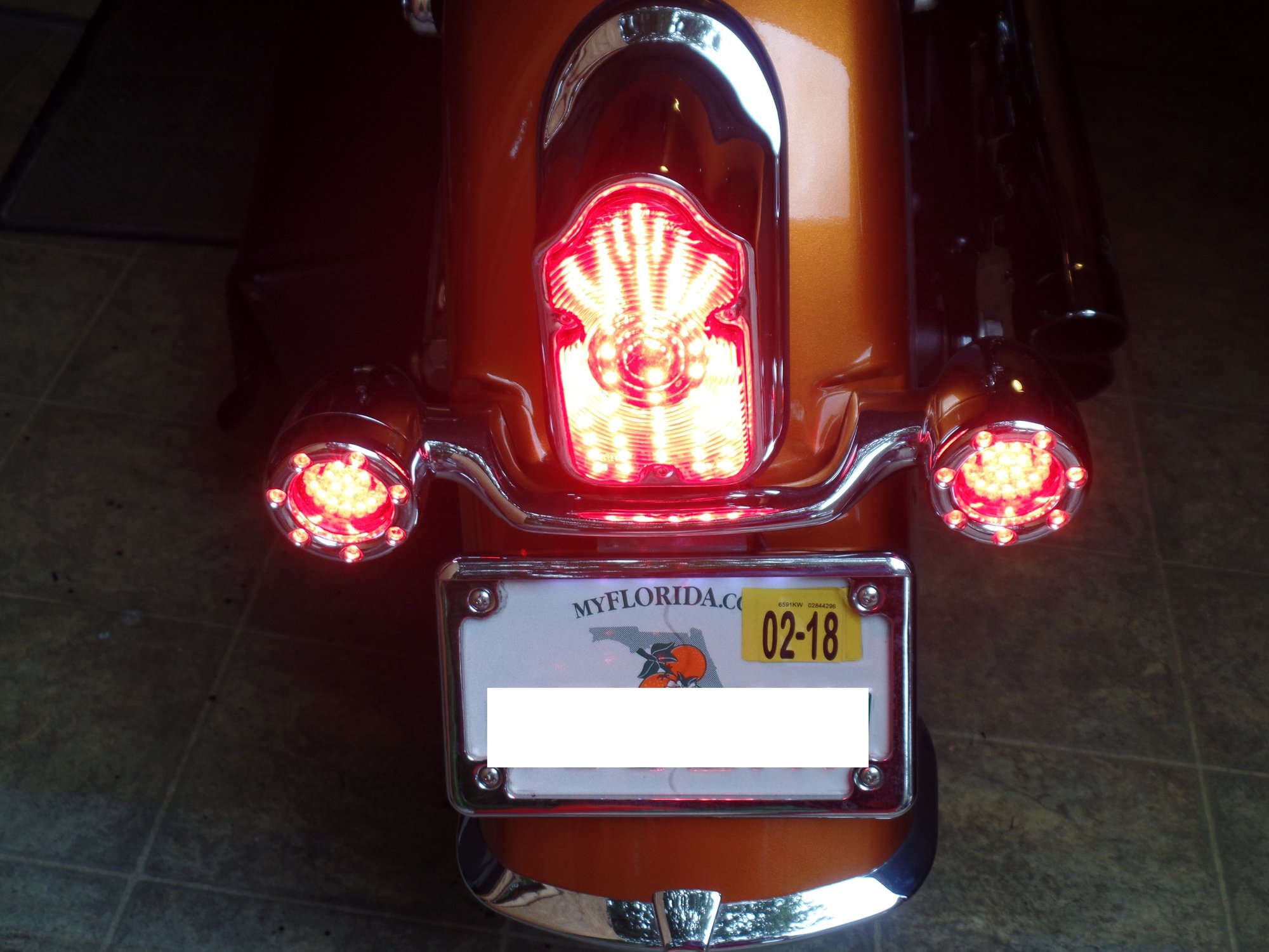

The HD r/s/t adapter needs omitted, you'll lose the stop feature on the signals. If you want the r/s/t feature you'll have to purchase a smart triple play adapter for leds. Custom Dynamics makes one and HD usually has one in stock. I ran leds front and rear with the triple play on my '14
