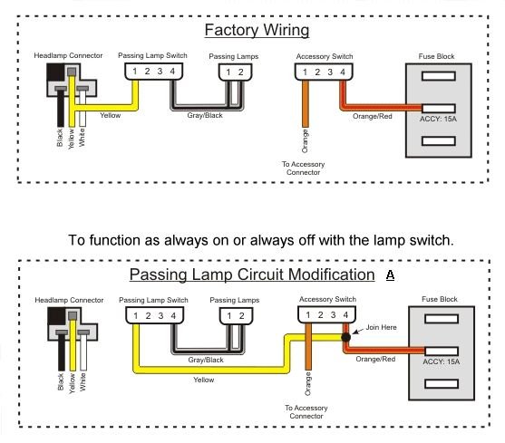

Congrats to your wife on her new to her '05 Deluxe. It's a beautiful bike.
Originally Posted by dab102999
... do they make or is there an easy way to wire driving lights to stay on with high beam? (I have a kurtakyn harness on my ultra to do this but didn't know if they have one for a softail line).
HD does make a harness for this purpose for Softails.
http://www.harley-davidson.com/store...200442--1#tabs
You can directly modify the wiring to allow the auxiliary lights to remain on with the brights.

Good for her. She seems to be happy with a nice looking bike. Are you asking about the aux lamps on bright or the regular front headlight always on bright? If aux., follow Docs example or buy the kit(wire assembly) from HD.
