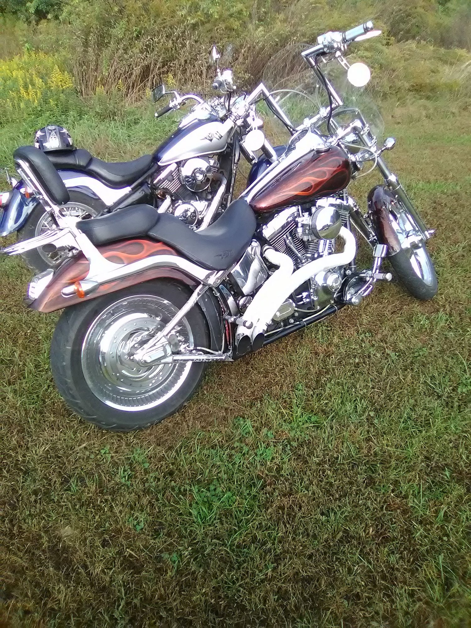

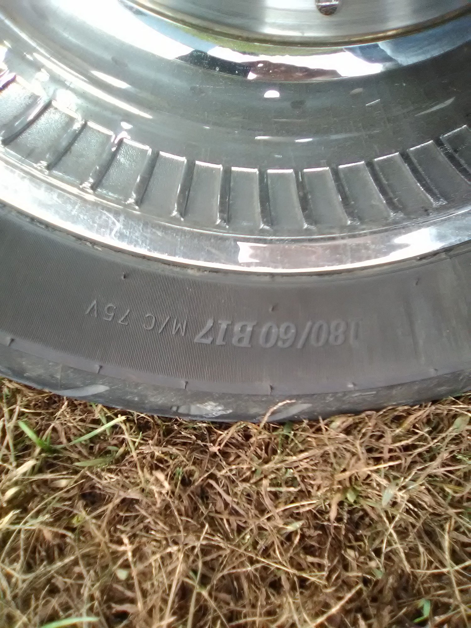

Hope I ain't too late to help out. I have a 01 duece, jus put a 180/60/b17 Michelin scorcher on it
