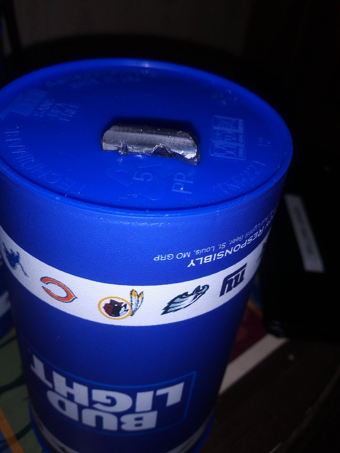

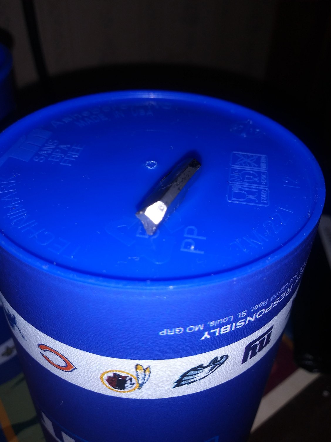

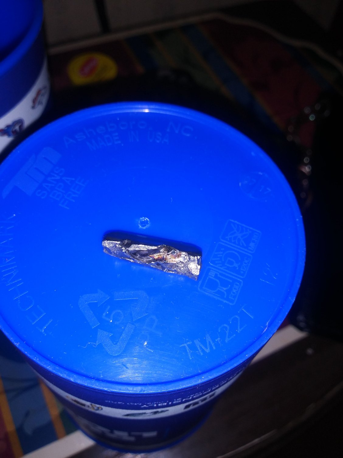

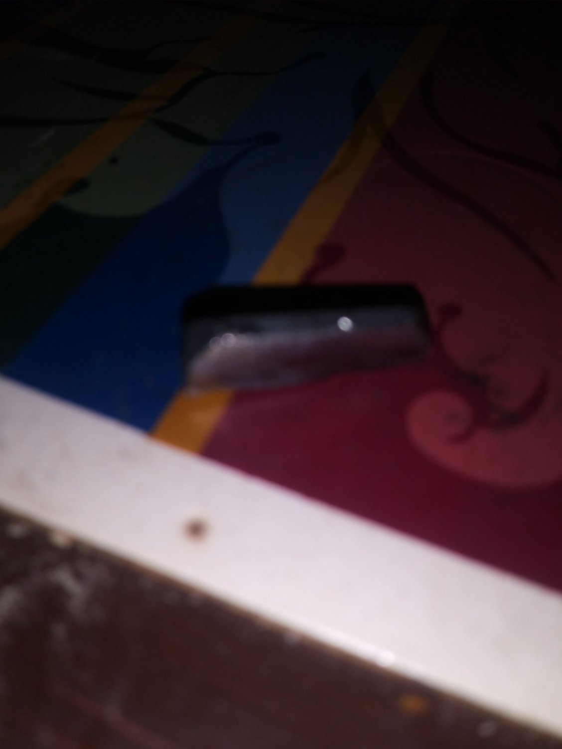

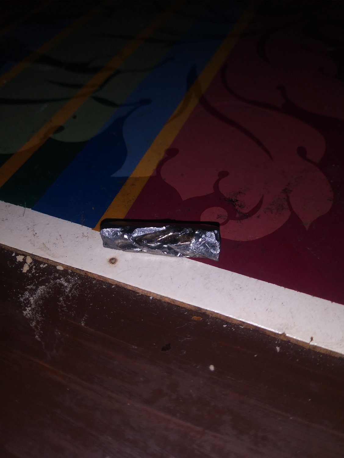

Hello thanks for approval . i have a 03 night train . I couldnt get clutch cable to adjust right tried everything but i ended up checking cabel connection the oil was milky so i was changing it when i removed the drain plug a what looks like a broken gear tooth fell out any help is appreciated thanks

that's sucks time to take it a part

do u work on your bike? trans not that hard to take out. mite only need a new gear.
