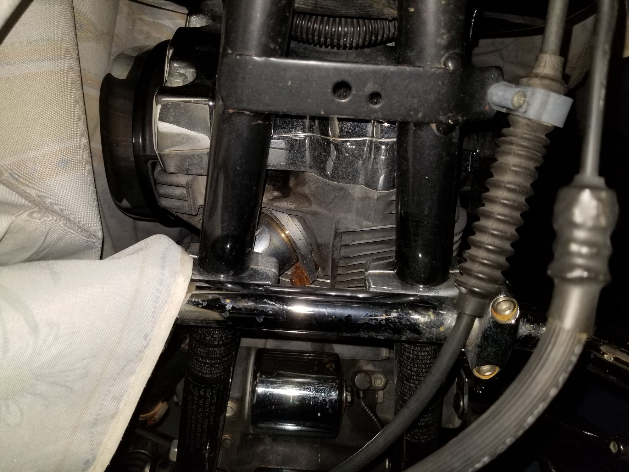

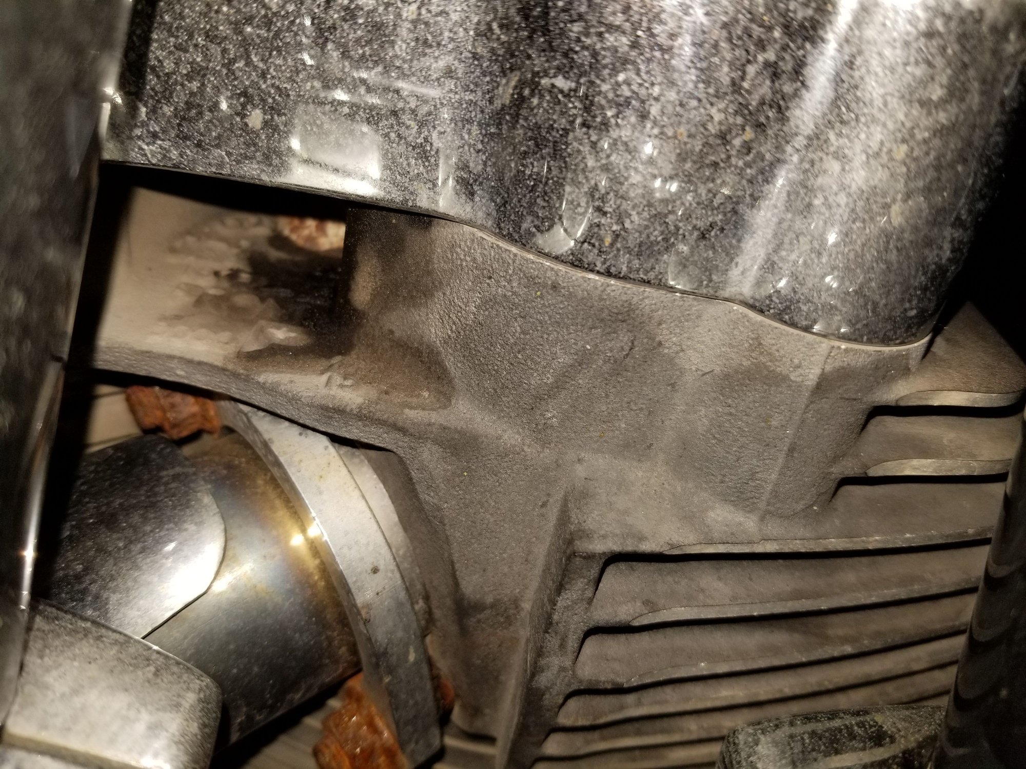

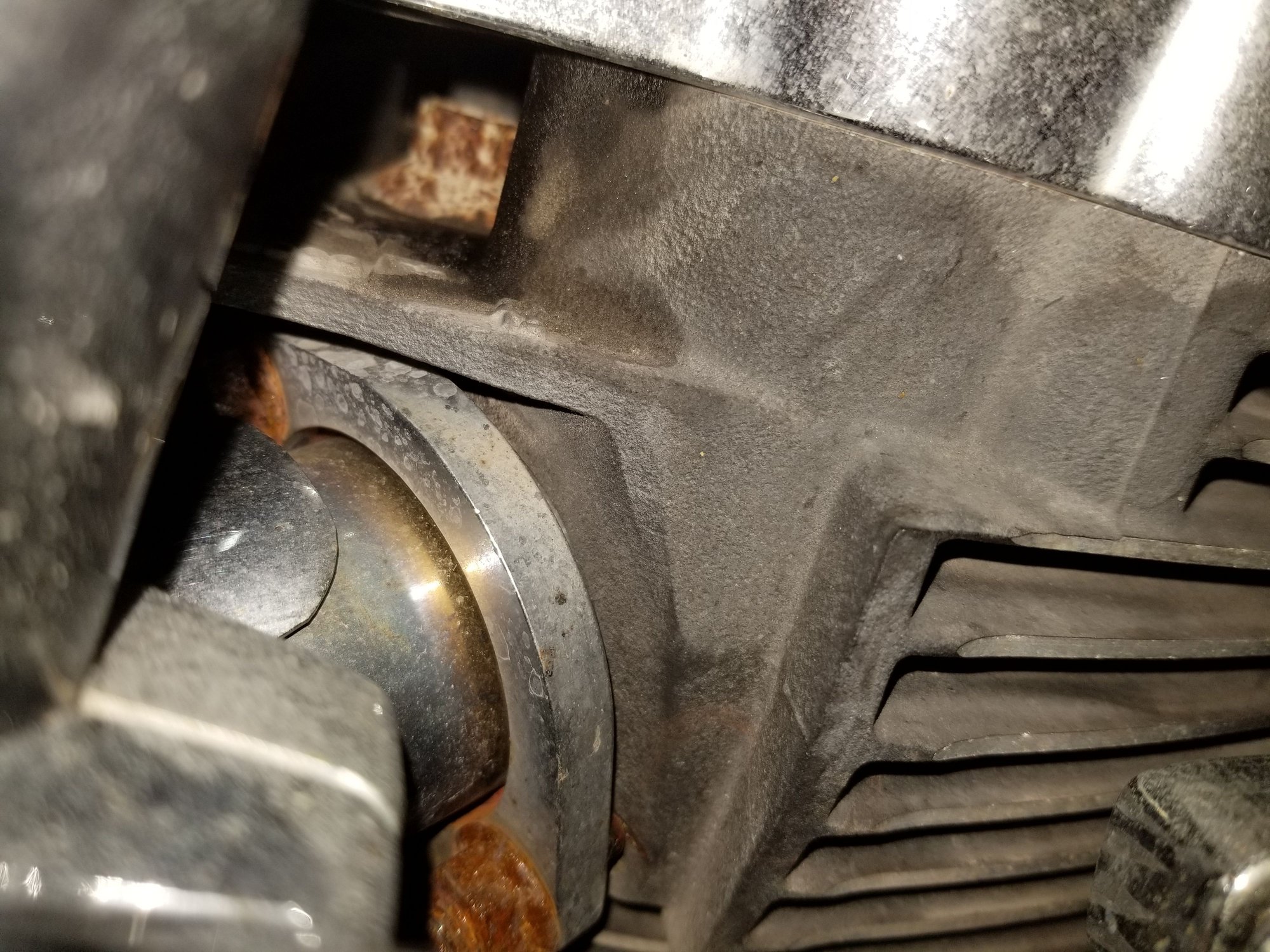

Hi guys.. seems like I have a leak ,anyone know if it could be the head bolt thats leaking? It's right under the rocker box. Bike is a little dirty due to transport. Sorry for that I usually keep them spotless.
Hopefully it's not an expensive fix.. what do u guys think?

It's a 2003 fatboy. In good condition.. besides this leak.

A seep that leaves a little trail like that is not a leak. If it's not dripping, leave it alone. Even a drip really needs to be bad enough to justify fixing it.
If head gasket was leaking, would think you would see it at slit. That could be assembly lube that wicked out years ago and stained that area. See it all the time on new bikes.

Spray the nut with crawl oil and simply replace them, I see that your motorcycle is also under a kind of blanket, this is the worst thing you can do.
The moisture is absorbed by the blanket and more will rust than that nut.

Going to clean it today and run bike for a while to see if it drips, maybe its coming from the rocker box gaskets?
