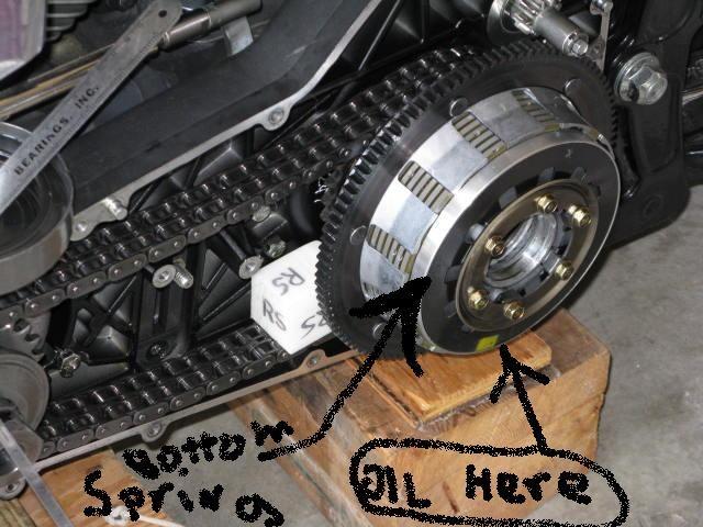

With bike standing vertical, this is the proper primary lube level, all big twins with wet clutch (mid `84 and later).
