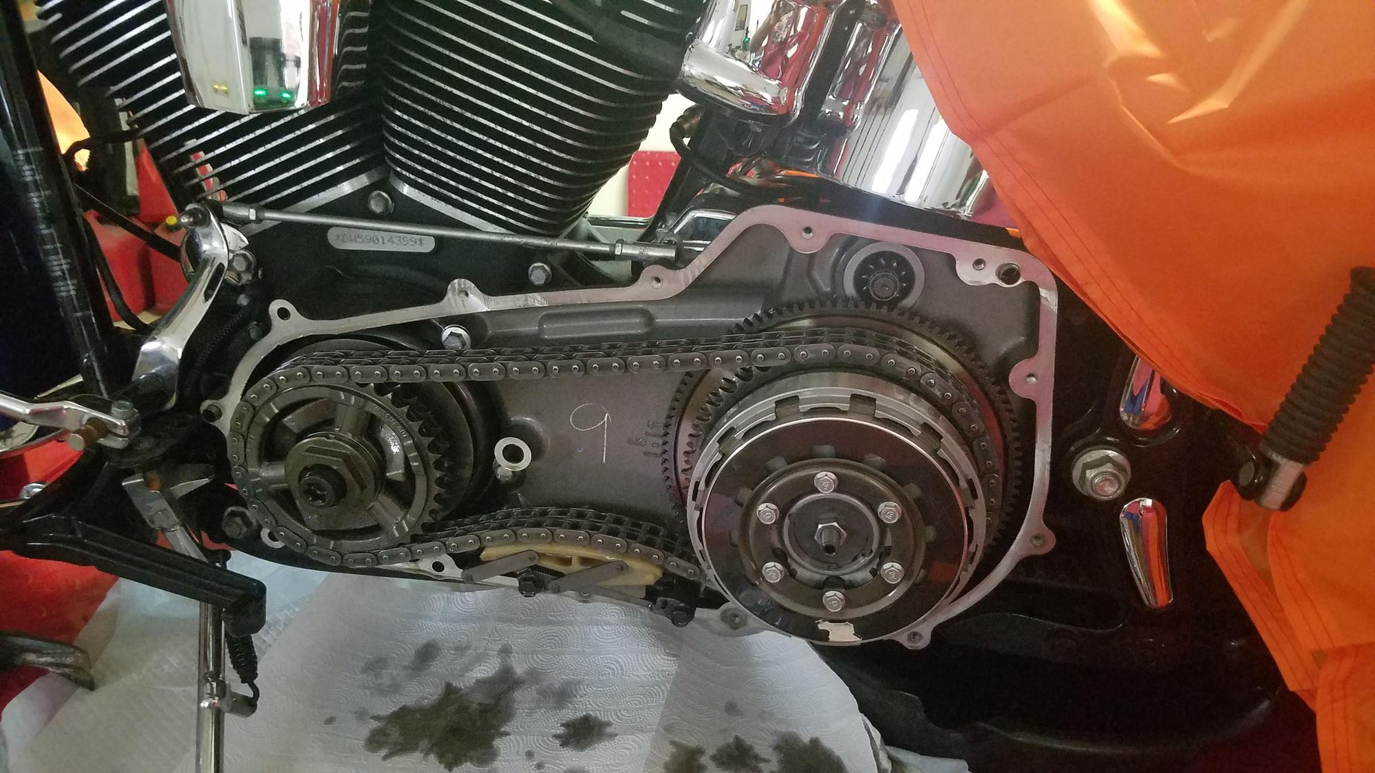

I have an .09 Heritage. When I replaced the stator a few months ago I was able to remove the outer primary cover by removing the floorboard only. I did not have to remove the supporting bracket, if I remember correctly there was just enough wiggle room to make it work but it was tight. And the jiffy stand mounts to that bracket too so if you don't have a lift or jack that could be an issue...
Primary cover removed with floorboard support bracket attached
Just to clarify my reply from last night, if you remove the entire assembly, (support bracket and floorboard), you are removing the jiffy stand as well. So obviously you need a lift or jack to accomplish that. If you remove the floorboard only, you can likely still remove the primary cover and the jiffy stand stays attached to the bike.
