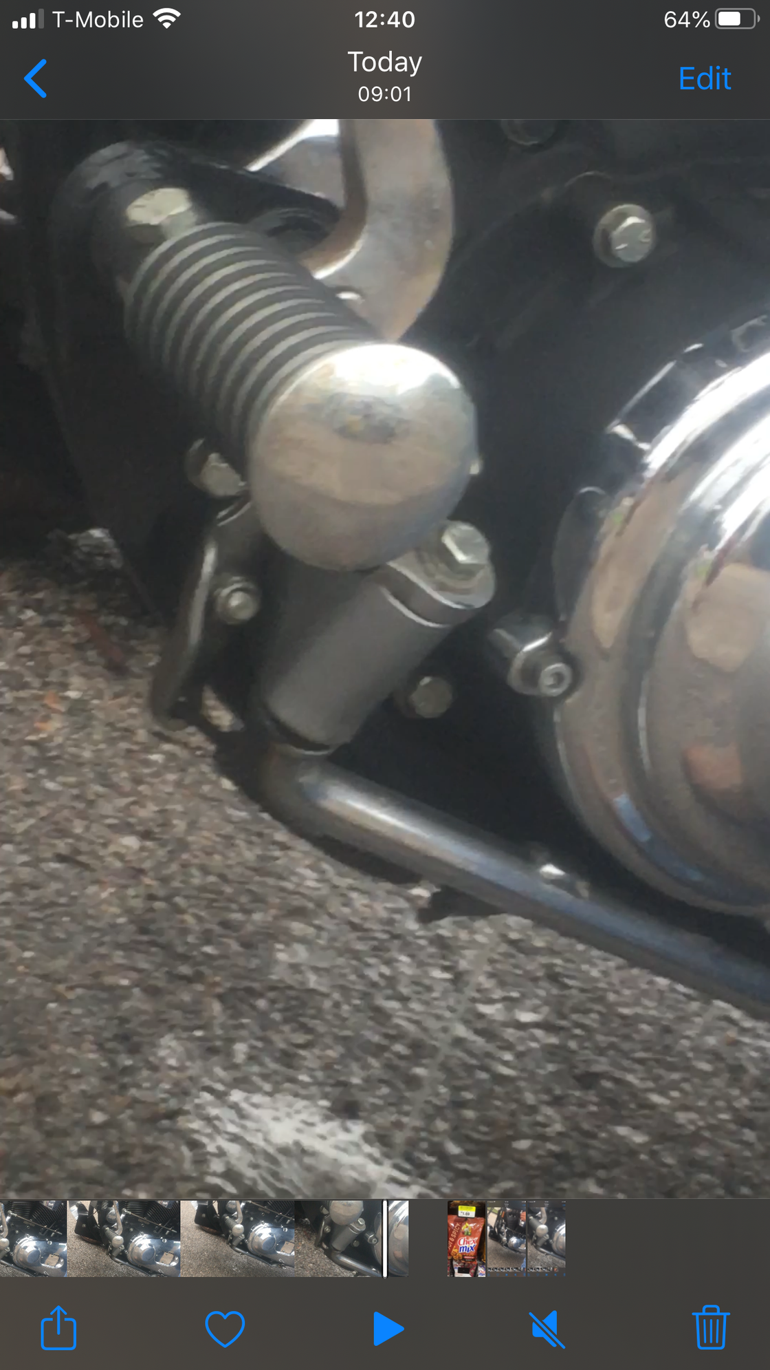

Trying to get back into riding, especially now that a friend has just bought him a bike, Im posting this for a friend of mine, who just purchased his first bike, 1994 Softail. Bike was sitting for a while and ran fine yesterday. Last night he parks it, shuts the fuel off and lets the bike run until dies. This morning he turns the fuel to "on", and its a steady stream of fuel being dumped from the underneath, out of the overflow line. It also looks to be flowing out of the carb. Trying to attach the pictures
Petcock off, no leak....
Petcock on, pours out.
, but any thoughts?

ok...........So heres what we did, and it has seemed to have stopped it. We took the air cleaner assembly off and tapped on the carb assembly. Seems to have stopped, but I'm guessing its a temporary fix. Were assuming either rebuilding the carb., (new float etc..) or any other suggestions?

If your going to take the carb off , then doing a complete rebuild makes sense . What you have there is a stuck float , a small pin / seal that slides up and down through a fuel inlet . When it starts to wear down , it will catch , so by tapping on the carb , it released the float and stopped the flow of fuel . It may not be necessary to replace the carb , just a complete cleaning and rebuild kit .
