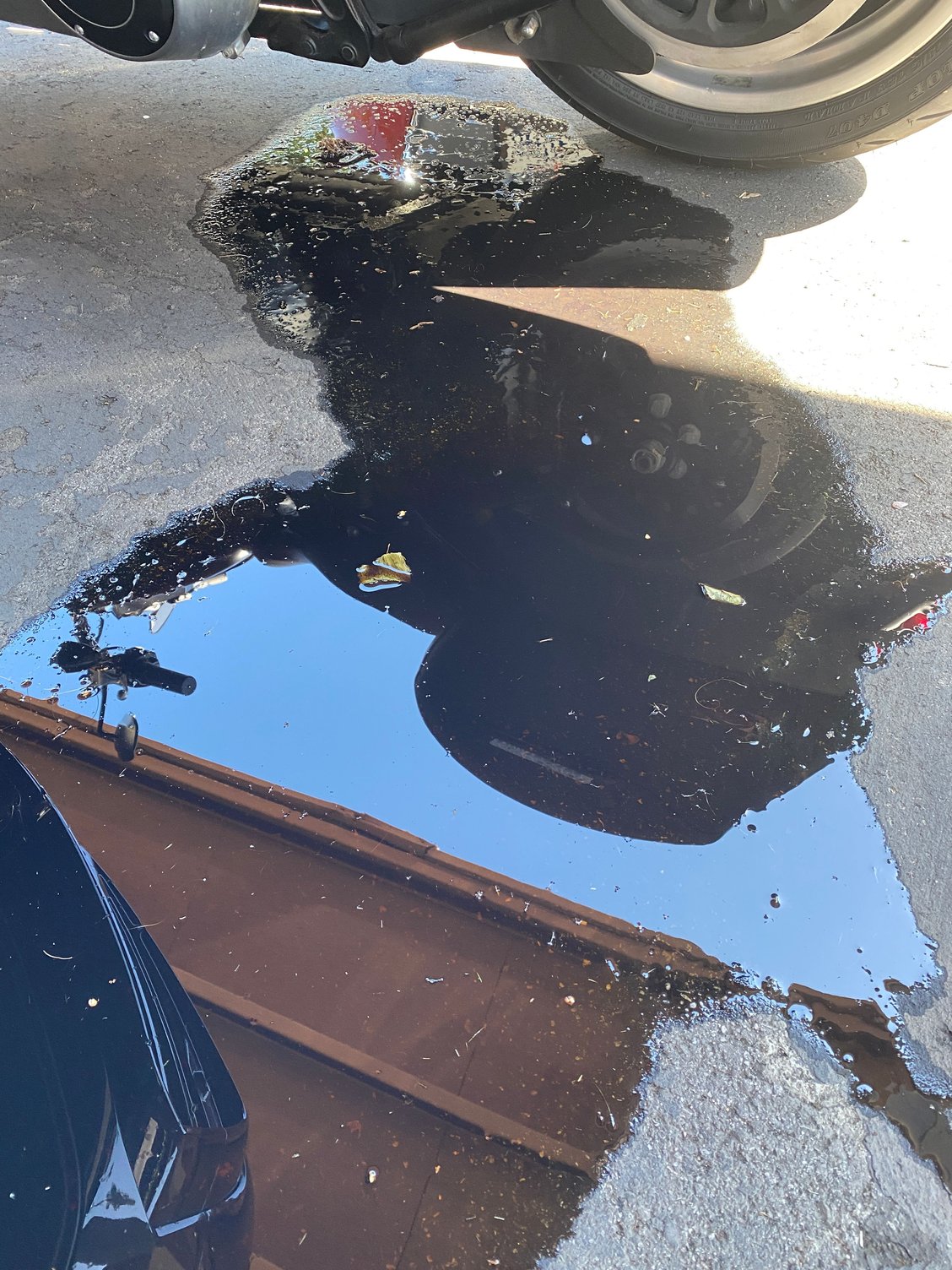

so, I went out on my bike last Thursday (2013 Fat Boy Lo), came home parked it up...today I went out and found this

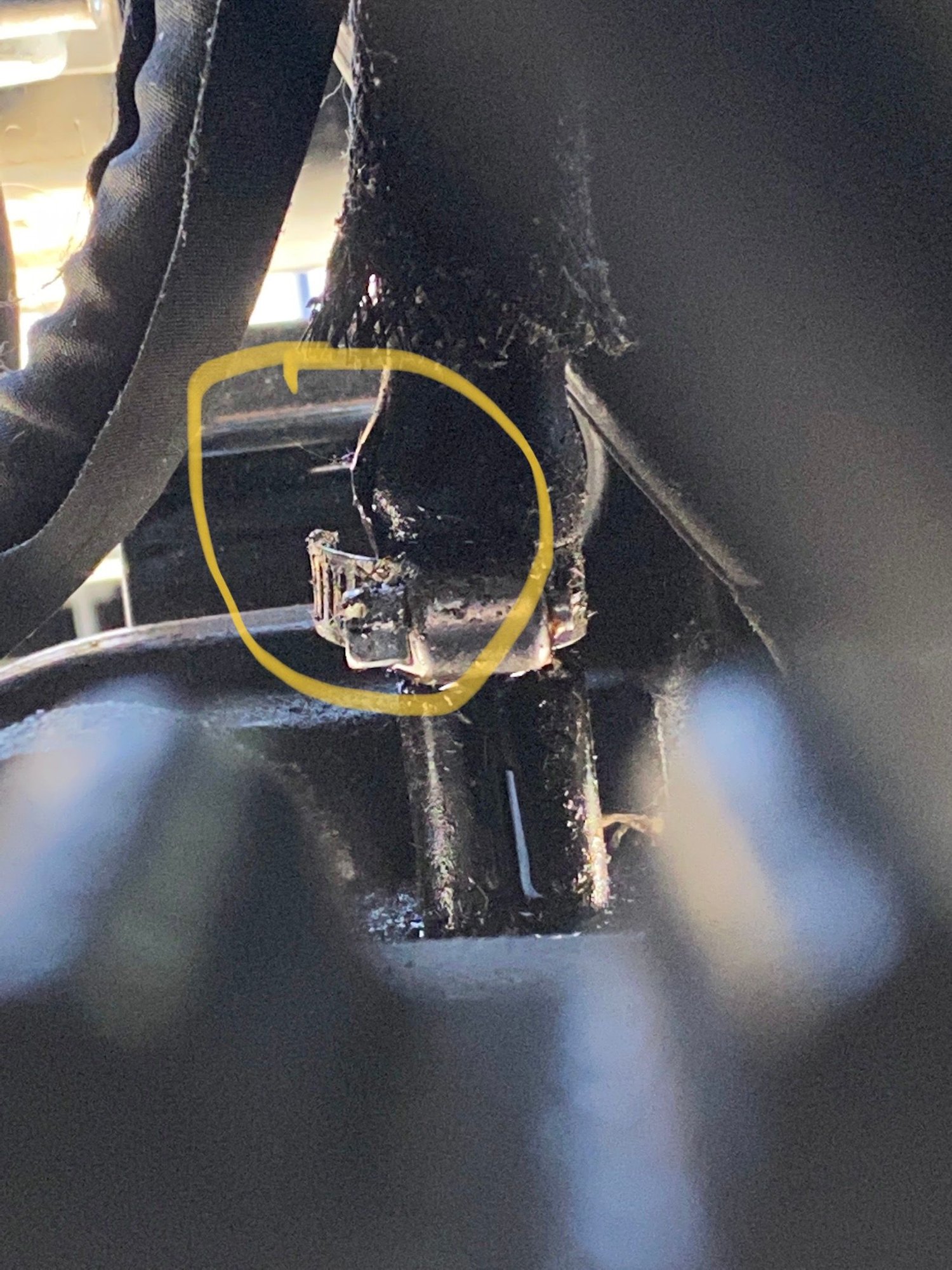

I don't image the apartment complex managers are going to be too happy with me but at least it's clean oil (only done 200 miles since the last service). I looked around under the bike but couldn't anything obvious until I pulled back the braiding on a hose and found the culprit
this hose seems to lead directly through a frame cross member to a plug. Am I correct in assuming that this is the plug for draining the oil?
I didn't have a good look to see where the other end connects to, but hopefully it's an easy job to replace the hose.
Yes, that's the hose that goes from the oil tank to the drain plug... should be a fairly easy fix...
NOTE: They are usually connected with an Oetiker clamp (#5 in pic below) from the factory... yours has a screw-style hose clamp on it... so it's been messed with at least once before...
The hose is #18 in this pic..
Good luck with the repair...

yup..all replaced. 30 min job. I suspect a previous owner didn't have the tool to remove the drain plug and so decided it was easier to disconnect the hose and replace the single use oetiker clip with the hose clamp. The hose is in pretty poor condition all along it so I don't think it would have been too much longer before it failed somewhere else. At least it failed at home and not 200 miles away on a trip

Clean up, use baken soda poor it on the spot then poor on coke (soda) and it will clean it up.

There's a real good chance it wasn't the dealer tech who was messing with that hose & OEM fastener... probably a prior owner...
Most times I change the oil on my softails.... I don't notice that hose, look at that hose, or bother to inspect that hose... It just doesn't come in to play when changing the oil, and is kind of out of the way unless you specifically look for it...
I suspect that unless you mention to the service writer you think there's a problem with that hose, a service tech won't notice it either...
NOTE: Just noticed the OP said the prior owner used that clamp & hose to change oil instead of the oil drain plug.... some people...
