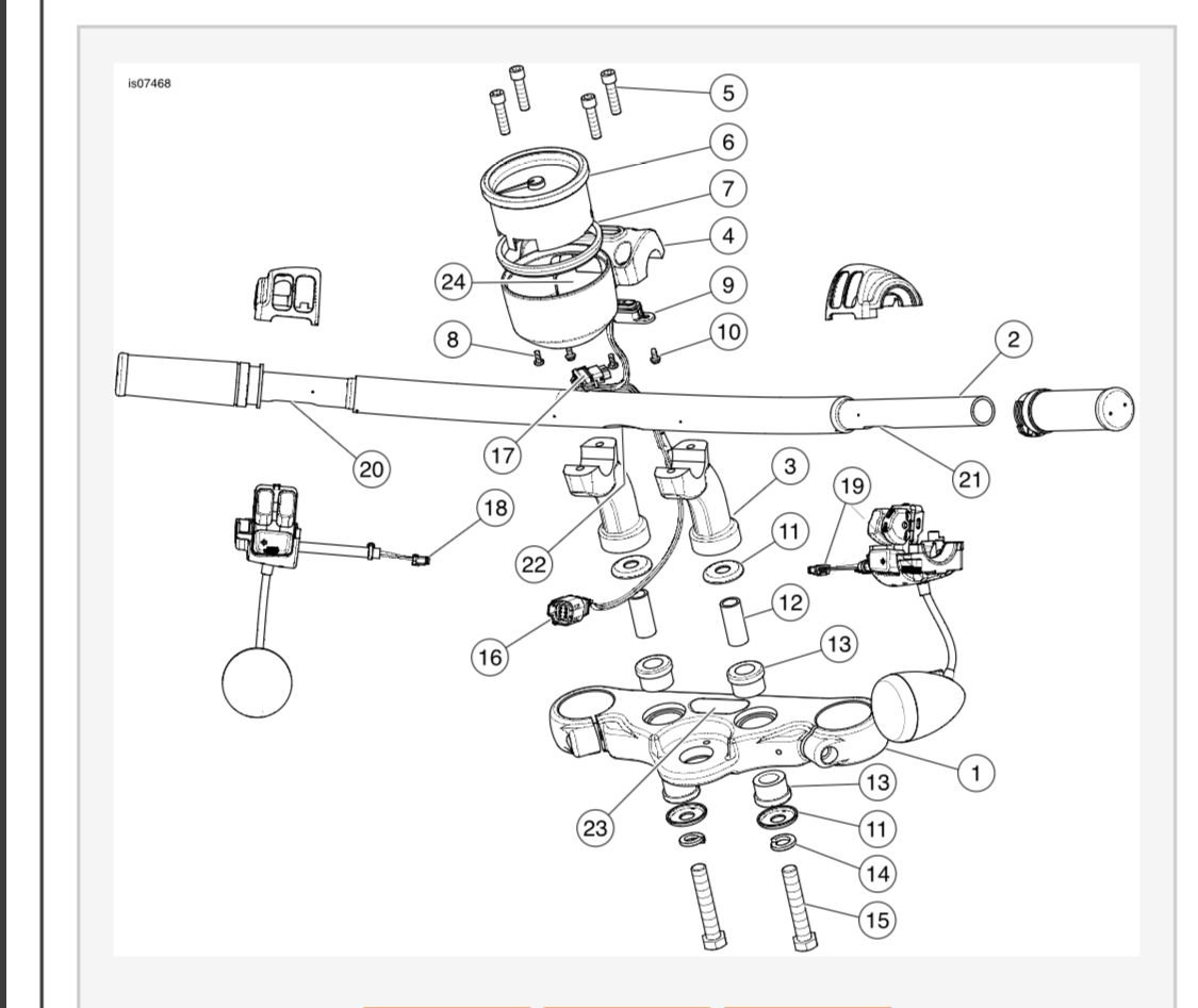

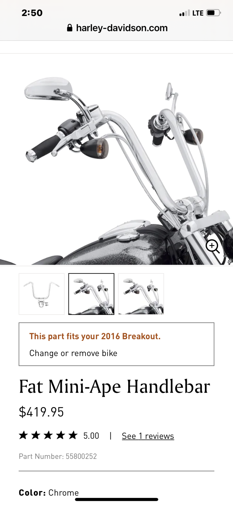

I recently purchased 14 inch it’s for my 2016 Breakout. They are 1.25 Diameter. I do not want to use the stock lower risers. I’ve seen thunder bike cells 2 inch risers for the breakout that are over $200. Is there another way to use 2 inch risers that a 1.25 inch diameter they are compatible? I know about the CVO conversion that is also $300. I’m curious to see if the softail slim fat riser conversion kit to 1.25 inch diameter will work?
These are the risers I think would work with stock 2016 1.25 Breakout upper clamp.
These are the CVO risers that come with the kit from Harley.
Diagram of stock bars.

The Softail Slim kit you posted should work.
Dark Parts makes some short risers, I used a set on my old Breakout. Nice quality parts.
Couple height options:
https://www.dark-parts.com/product/f...akout/?lang=en
or...
https://www.dark-parts.com/product/s...akout/?lang=en
