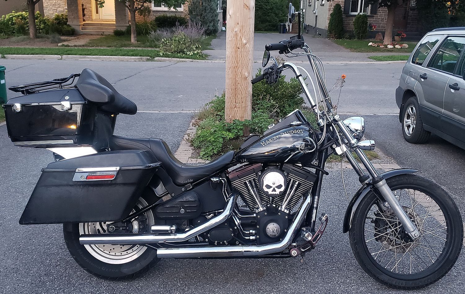

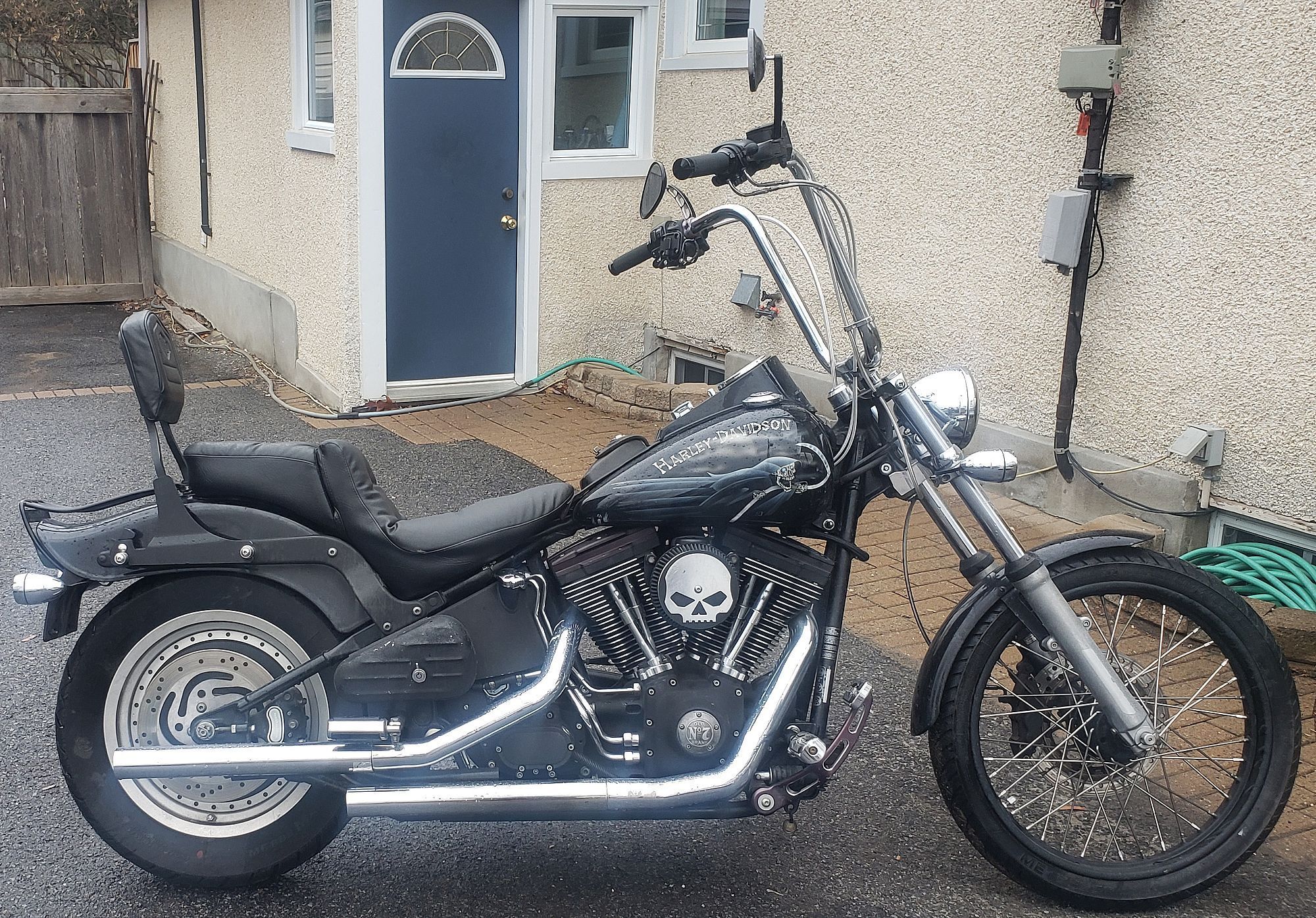

I have a set of touring hard bags mounted on Ghost Brackets (no longer made, but EZ Brackets are pretty much the same), that go on and off Reaper in seconds. I also have a King Tour Pak on a quick release bracket that goes on and off in a few more seconds. i can transform Reaper into a "Baggetail" in less than 5 minutes.
If your looking for a permanent solution, there are a lot of options out there.
Reaper as she is daily:
Reaper in "Baggetail" Mode (except for the Mustang Wide Touring seat not in this pic) :
