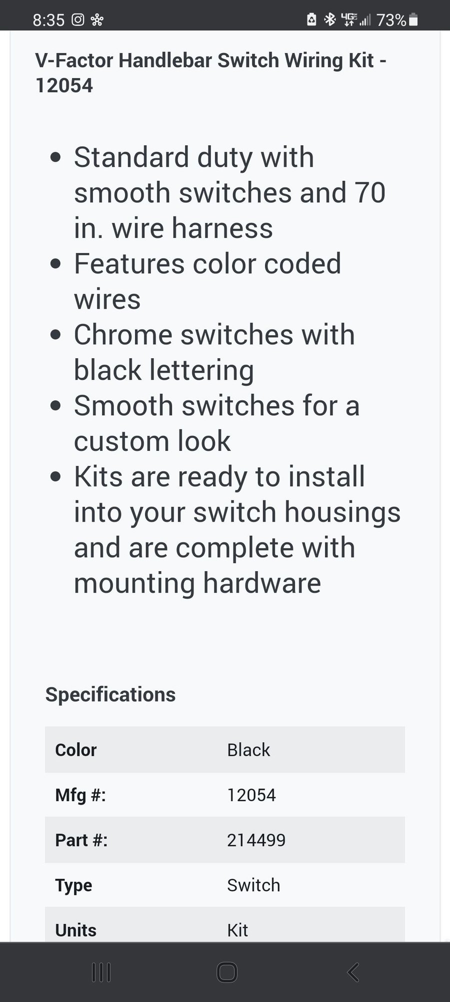

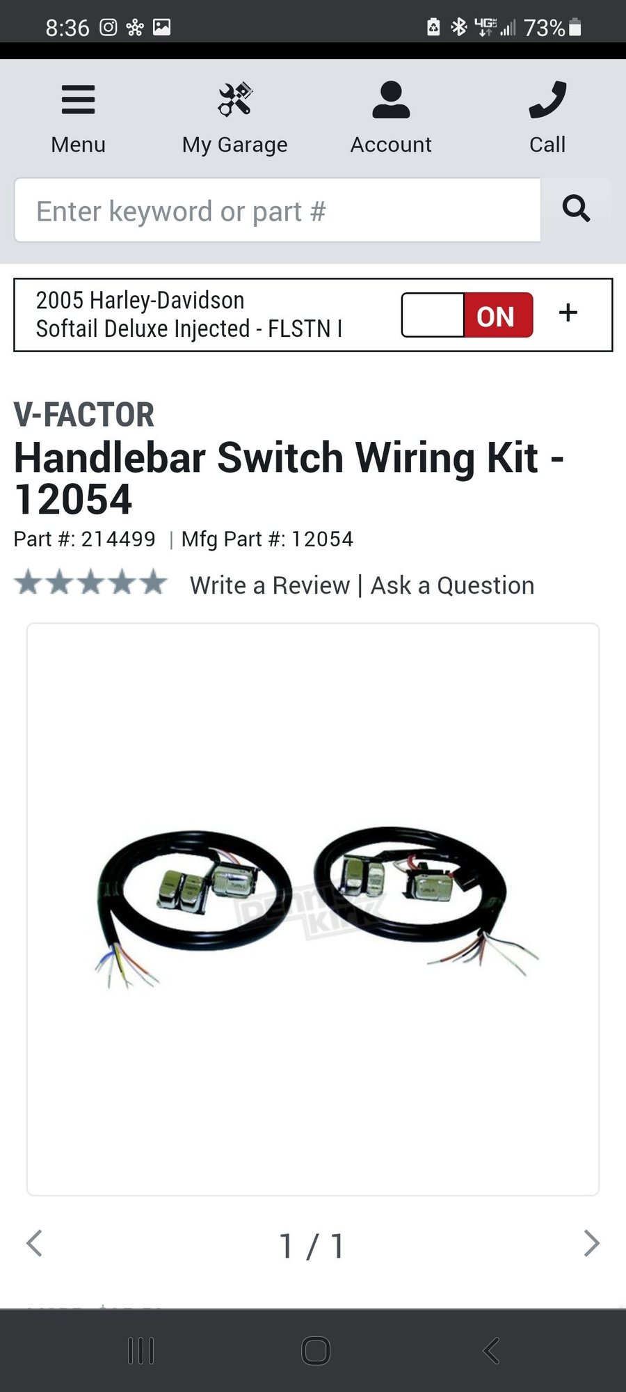

I found this set of switches that comes with 70 in of wire. I figure that with that and the right set of connectors I should be able to just cut it 2 length install the connectors and be ready to go before I ever take the other bars off.

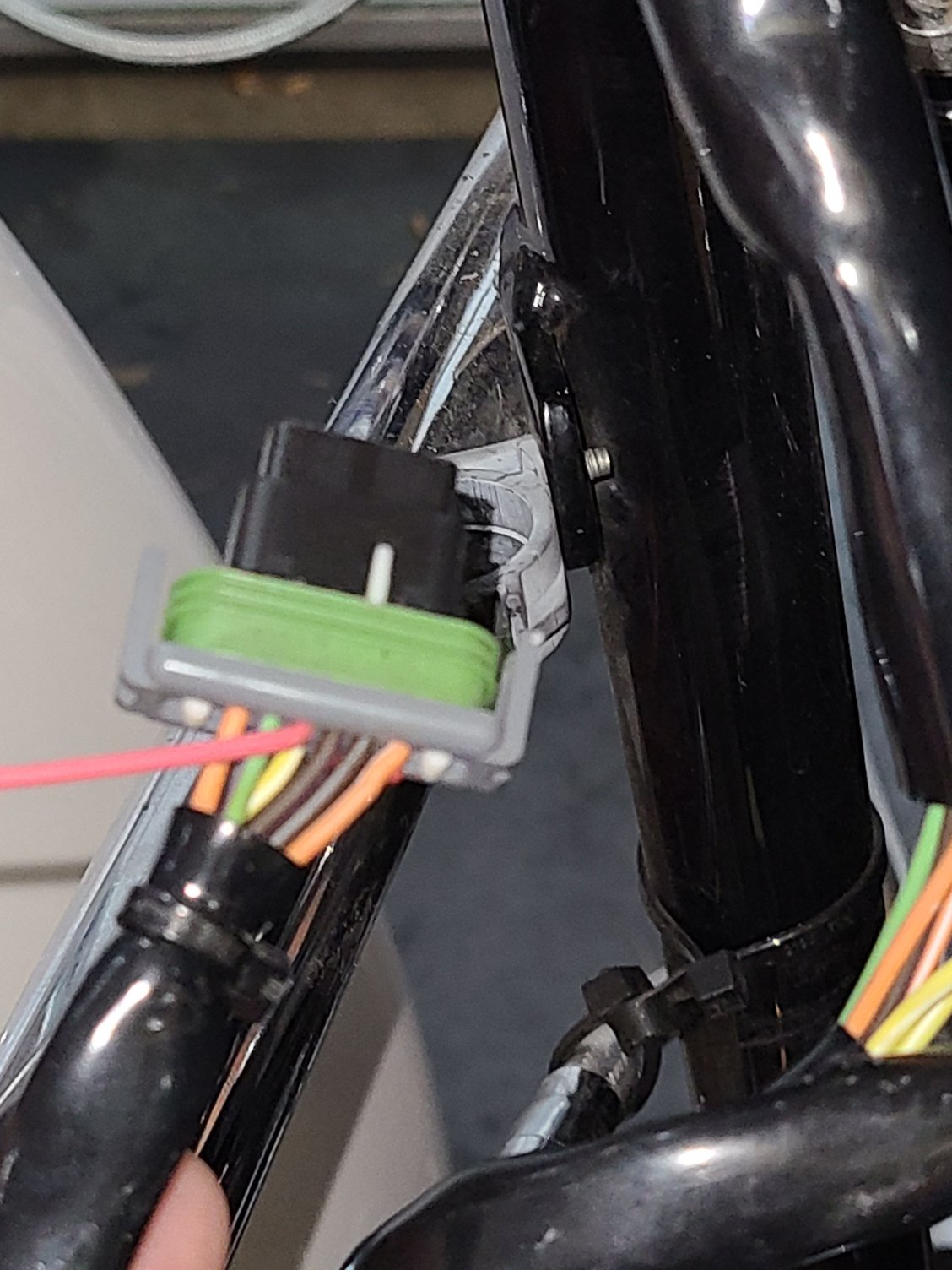

I use these wire extensions anytime I do a handlebar change, when longer wires are needed....
https://namzcustomcycleproducts.com/...yourself-kits/
The CanBus bikes are super easy.. on your year, you'll need to learn to unpin the various connectors involved, then re-pin them after running wires... not really hard once you get the feel for it...
The HD Service manual for your year/model bike, has a section in the back, telling you what connectors are used and how to unpin & re-pin those connectors..
The extensions you posted should work, but if you look close, I believe you may find pins attached to the ends of the wires. If you trim the wires, or if the wires don't come with them, you will need to add pins to the end of the wires that will fit into the connector they are using...
Again not a hard job, but different connectors need different pins & often different crimpers...
I have the various crimpers & pins needed for most of the different connectors used on the twin cam Harleys; Molex, Deutsch, Mini-Deutsch, AMP Multi-lock, and Packard connectors... The types of connectors used seems to vary a little, between the various years of the twin cam bikes.... it takes some time/money to collect those various tools/parts and learn to use them...
Good luck with your mod...

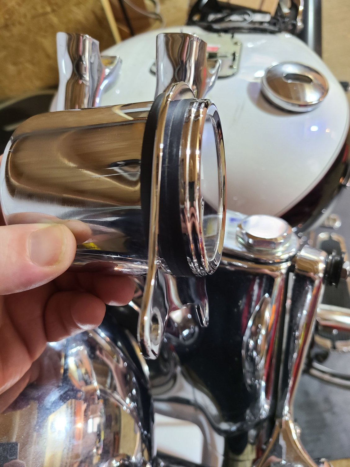

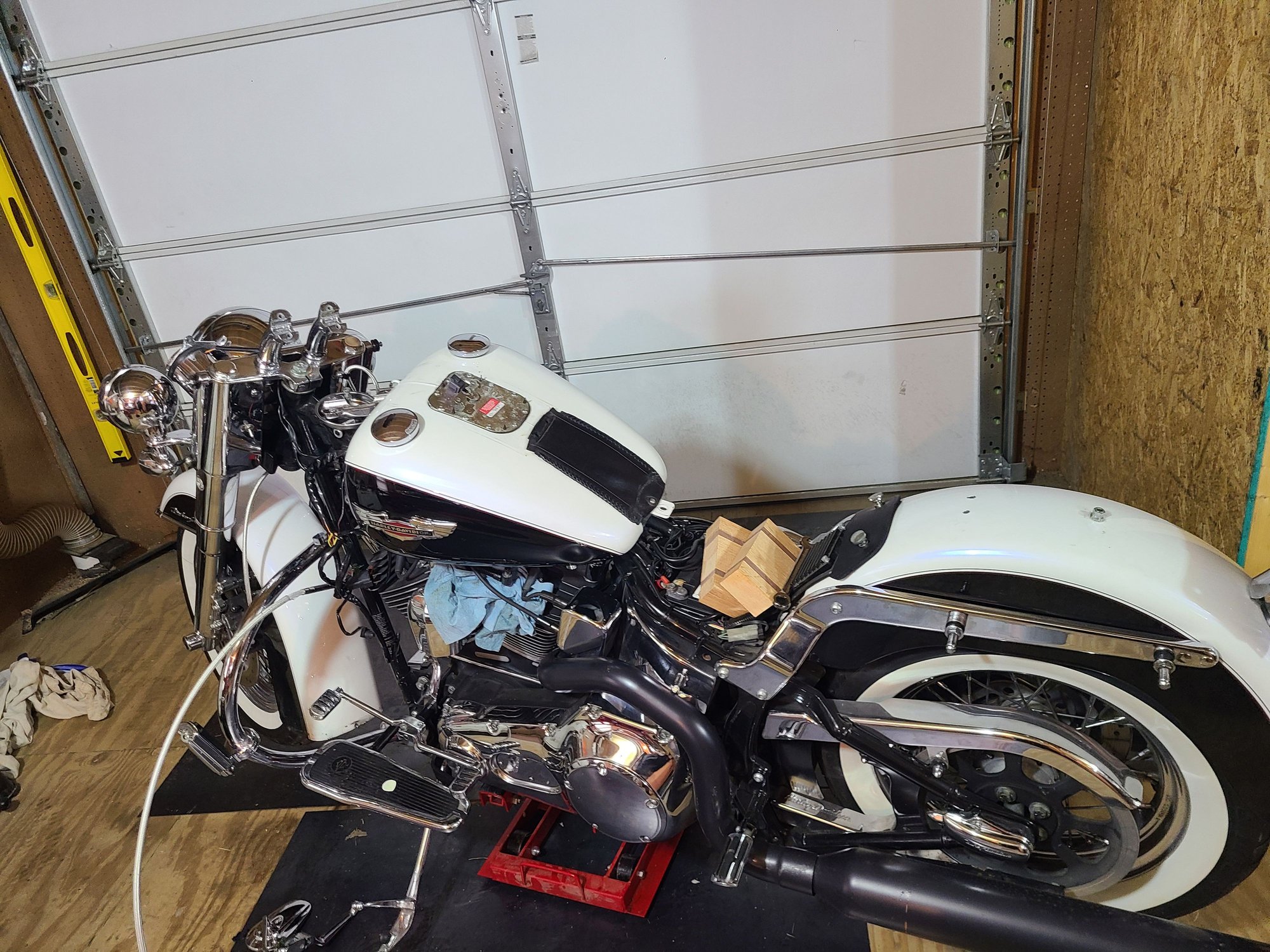

So not only did I get the wrong risers but I didn't figure it out until I already had everything unhooked. The risers I bought are for the style of clam that has the rear to bolts closer together than the outer two bolts while my top clamp has the bolts equally spaced like a letter H. The worst part is I can't even seem to find any other risers that use the style of clamp I have and I'm not sure that the bolt holes on the other style of clam would be the right distance apart for the tach mount so I'm stuck in limbo bike on the jack with no bars untill I figure it out
I'm not even very picky I'm just looking for something that is compatible with clamp mounted tach, Chrome, straight, 1" bar at clamp area, and between 1½ to 3 in tall and preferably under $100
if I can't find something in the next couple of days I'm going to need to decide between completely eliminating the tachometer, trying to figure out how to install one of the cheap mini tachometers, or spending almost three hundred bucks for one of the Plug and Play speedometer tach combos. Either way the priority is having a functional bike again ASAP.
if anyone could point me in the right direction to a set that are in stock somewhere and ready to go I would really really really appreciate it

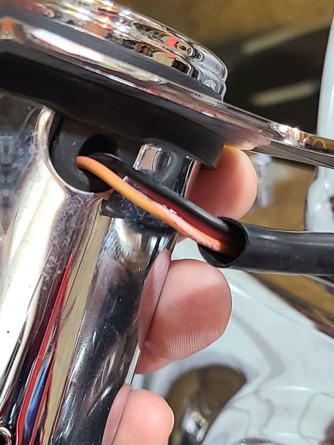

so riser problem is solved but to do that I had to switch from inline 3.5" clamp bolts to offset which means the tach can't go back on the clamp.
n order of preference, I either need to:
1. find a bracket or clamp that will fit this tach and mount it to the bars
2. buy a new tach that clamps to bars.
3. eliminate this tach and upgrade to the analog hd speedo/tach combo
If I get a new tach, I really want to stick to one that wires up the same way this one does.
Old Jul 17, 2021 | 07:09 PM
The Outlaw's Avatar
The Outlaw
Joined: Jan 2013
Posts: 485
Likes: 9
From: Central PA

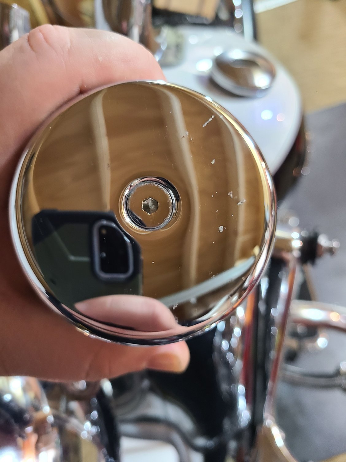

If anyone knows of a mount that would fit my current tach or a replacement tach that has the same three wire setup I would greatly appreciate it
some measurements
outer face 3"
glass 2⅜
length 3¼
can width 3.
