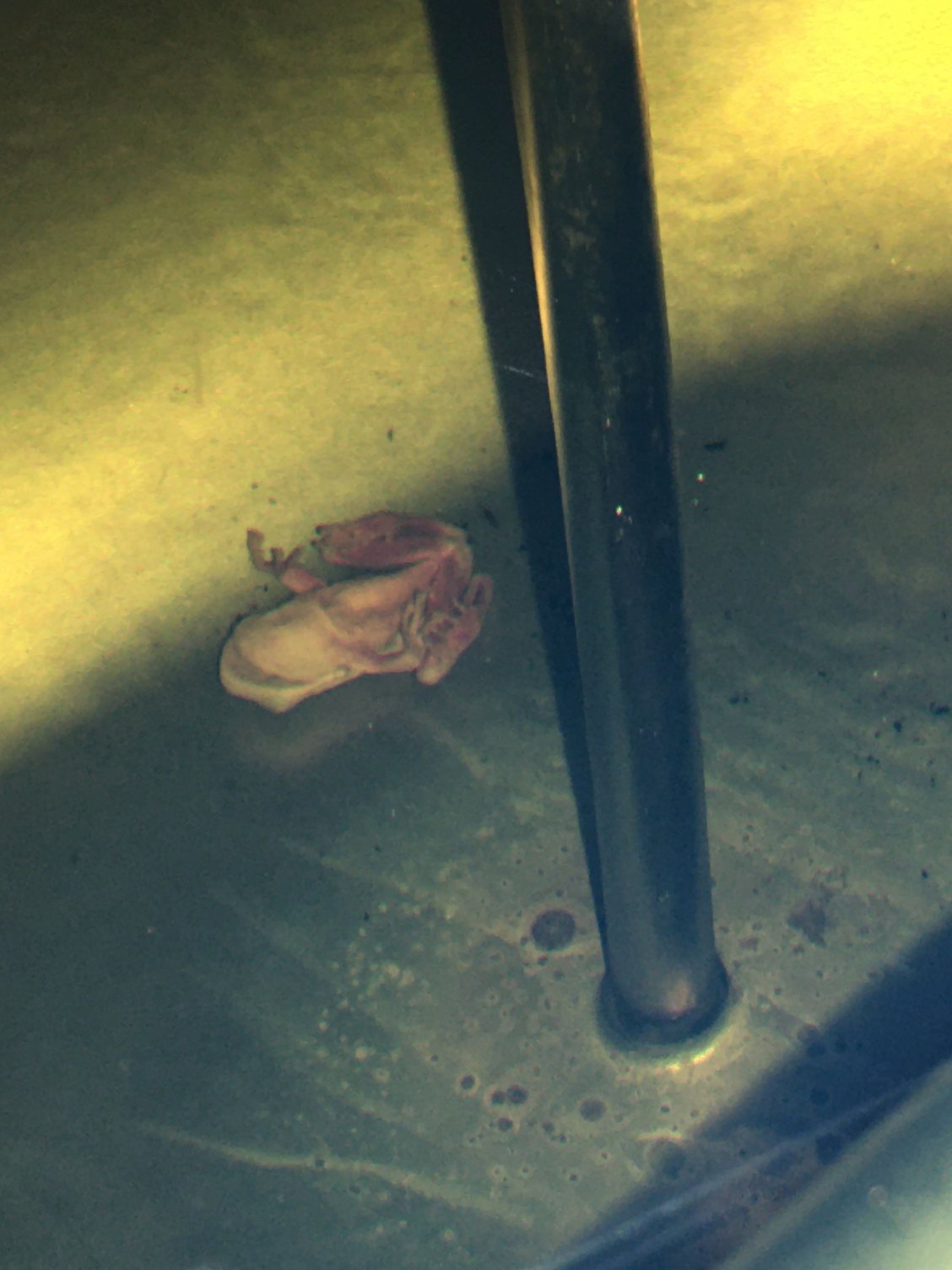

Originally Posted by Gordo1
seen it all . I got one here was pasted flat on my tractor solenoid. Was likely sitting there when the juice came through to start. Too crazy!. Mount the sucker and use em for a desk paperweight!😅😅👍😎

I have pulled the intake manifold off to clean and check everything, and to replace both injectors and flush the fuel system. My local mechanic feels that the frog issue my have caused trash to get in the injector , even though I cleaned them once I did not flush the whole fuel system . There was quite a bit more trash in the number 2 injector again . Number 1 had some in it but not as much as #2 . In the process of doing this I found that both manifold seals/ gaskets where split and had some dirt/rust/corrosion on the flanges where the splits are. And also my butterfly valve is sticking closed ?? I have the injectors already just waiting for the seals to come in . Once I get it all back together and running I’ll test the charging system to let y’all know . Thanks again for all the suggestions I feel like I am slowing making some progress! 🤞🤞✌️
