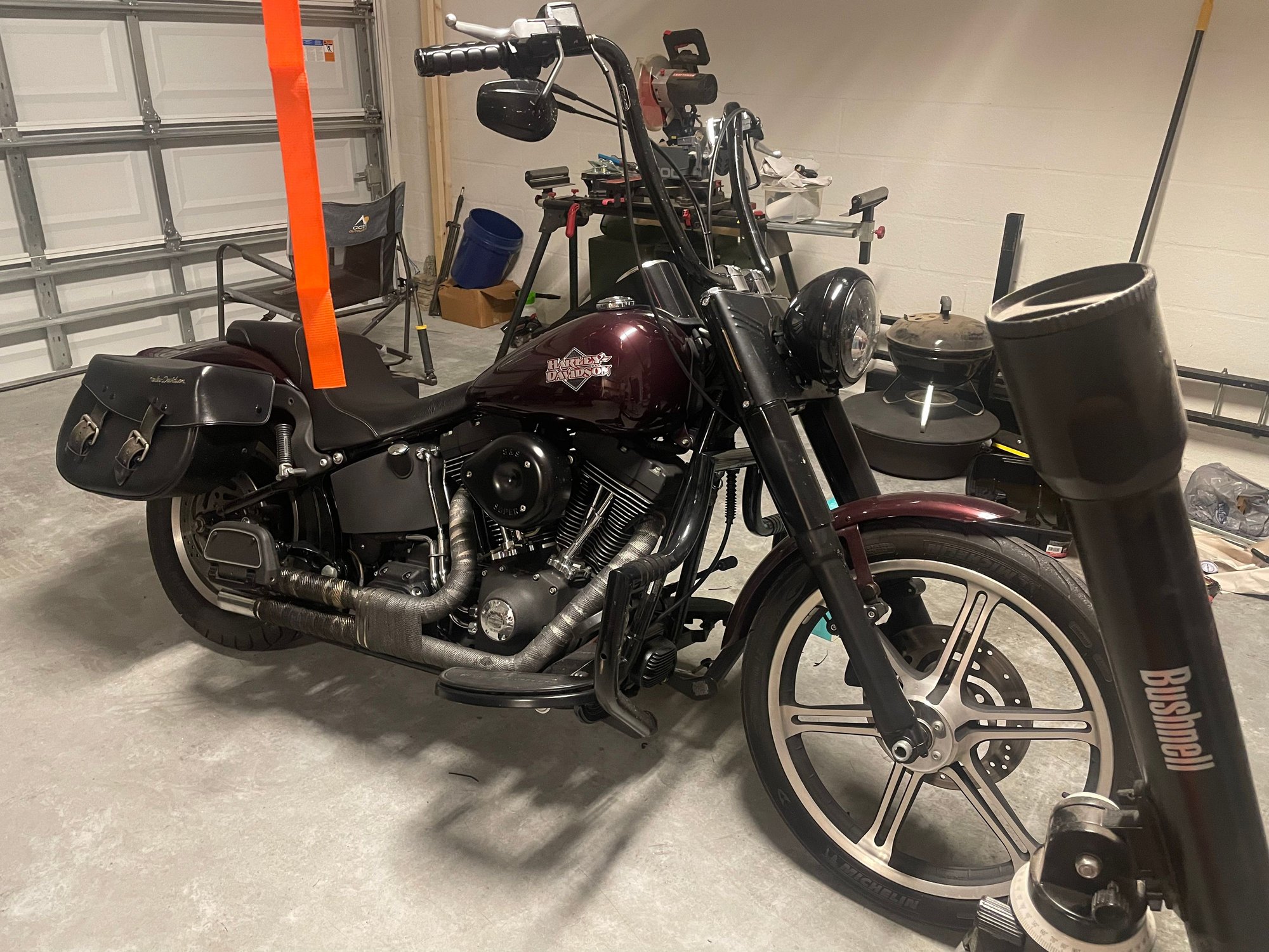

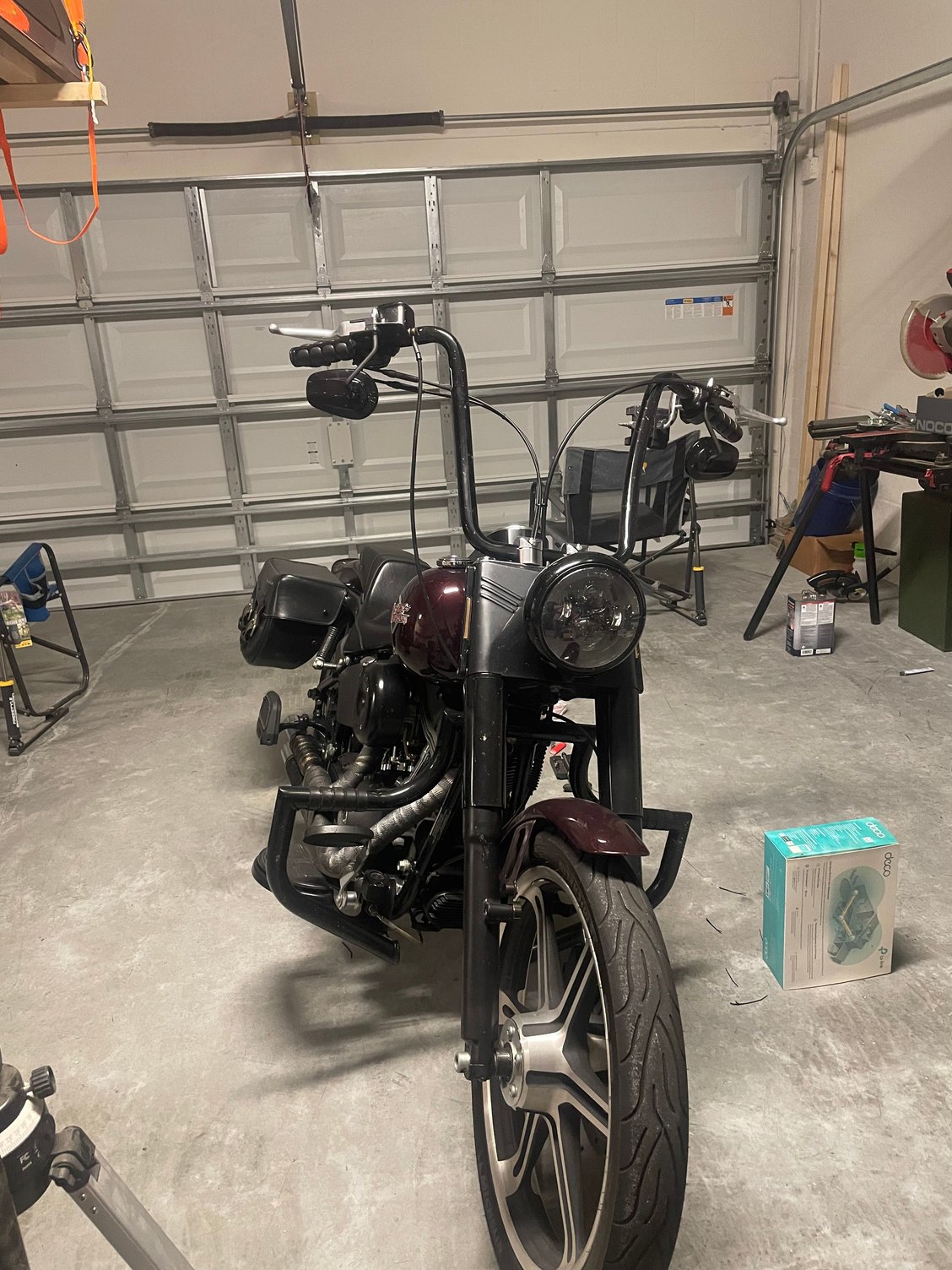

O7 night train lookn for drag bars thinkn 9in rise curved I'm 5'6 170lbs any tips on what bars send pics. it's my first bike and it don't take long fire my right hand to go numb

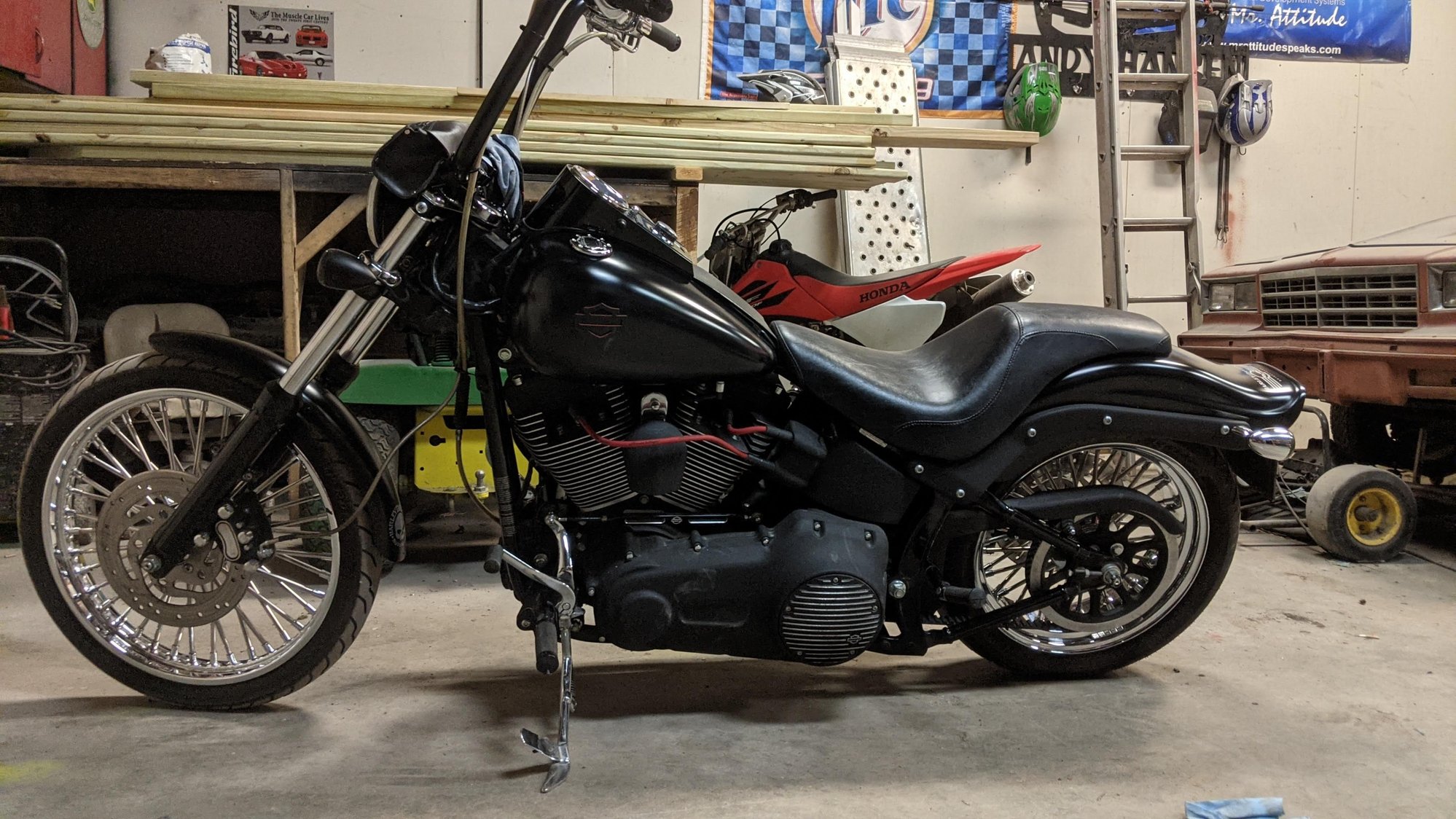

before and after pics .. bars and a lot of other things i did

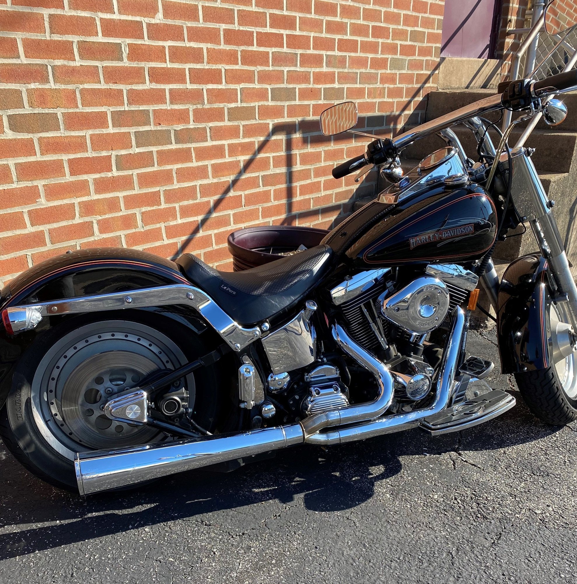

I like drag bars... I put Wild 1 Chubbys on my springer...
They make two sets for softails;
WO501 Chubby 8" pullback Drag bar- 30.5" wide, 8.5" center, 7" Pullback, 25° wrist angle
https://wild1inc.com/browse-products...s/wo501-wo501b
WO507 Chubby 10" pullback Drag Bar- 30.5" wide, 8.5" center, 8" pullback, 25° wrist angle
https://wild1inc.com/browse-products...s/wo507-wo507b
The ones for my Springer mount differently than a normal softail, but they are- 7" tall (shorter than the softail 8" & 10" options), 30.5" wide, 8.5" center, 6" pullback, 25° wrist angle..

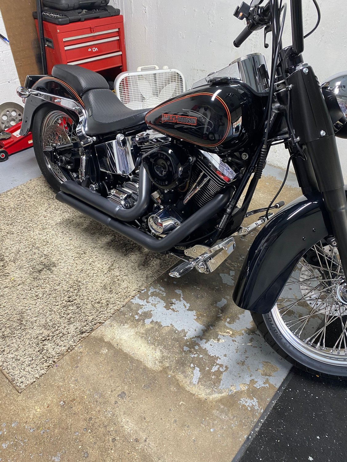

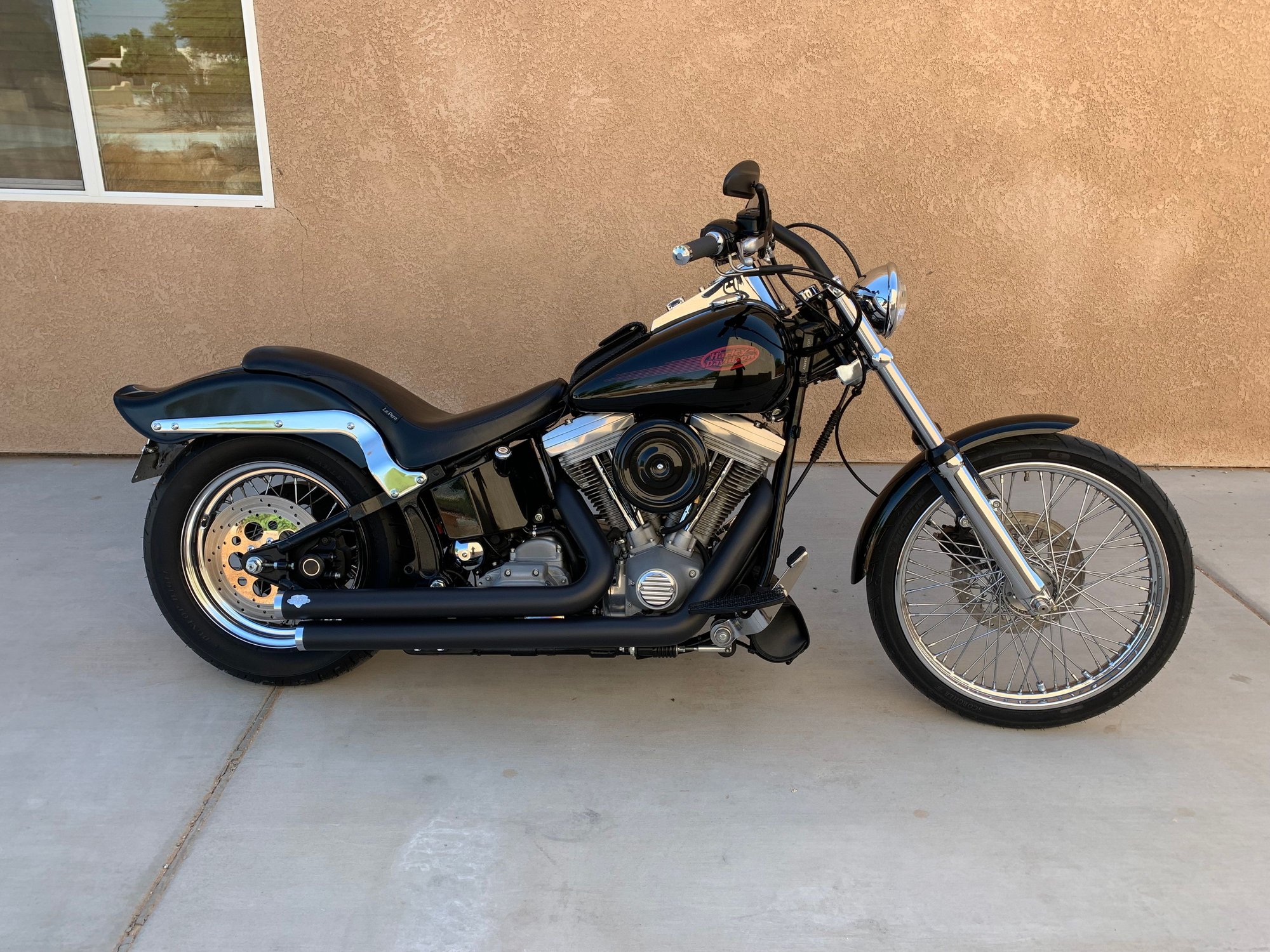

Just put the Wild 1's with 6" rise ( actually measure out closer to 7")on my Standard. Very neutral position which I really need right now post neck surgery.
