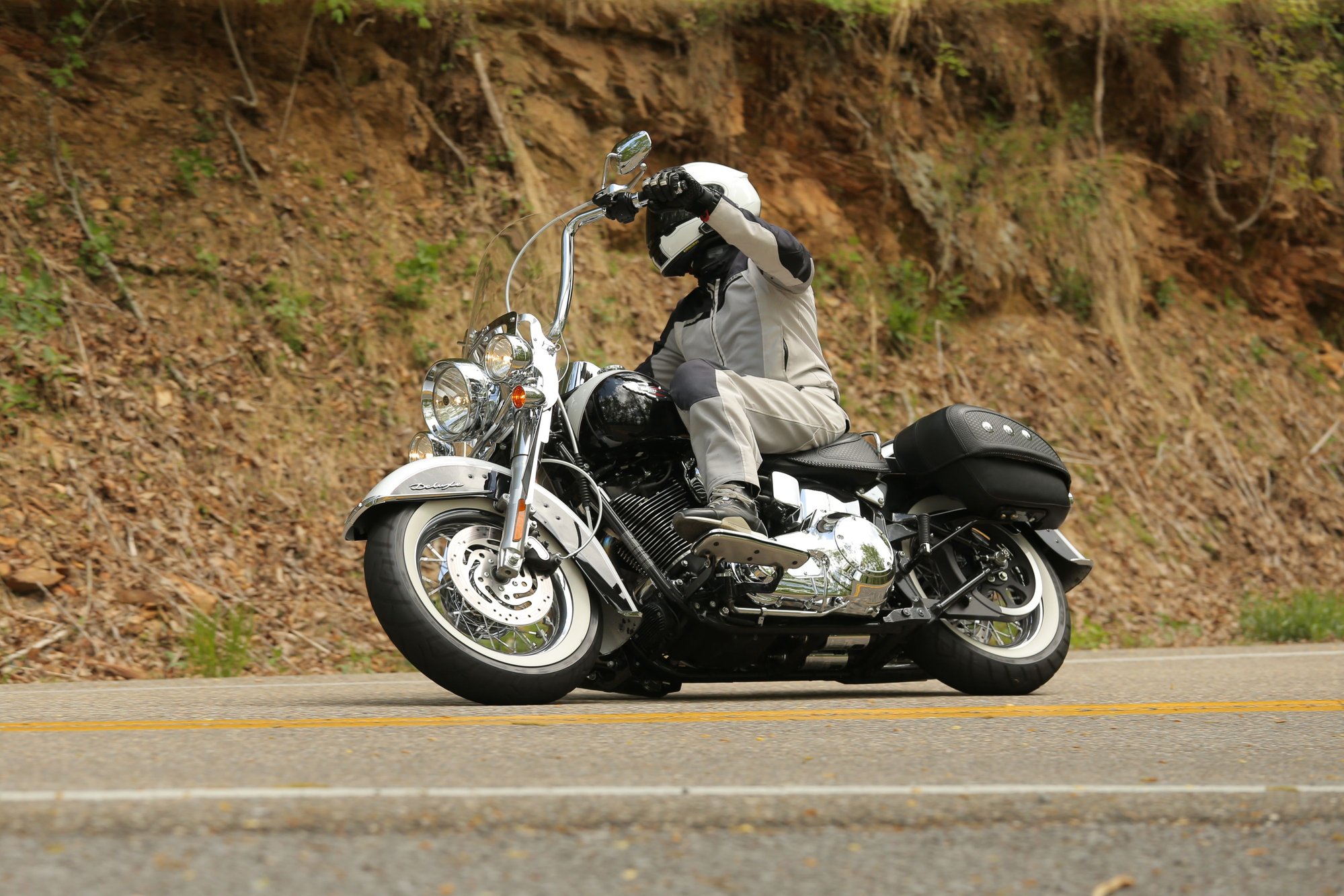

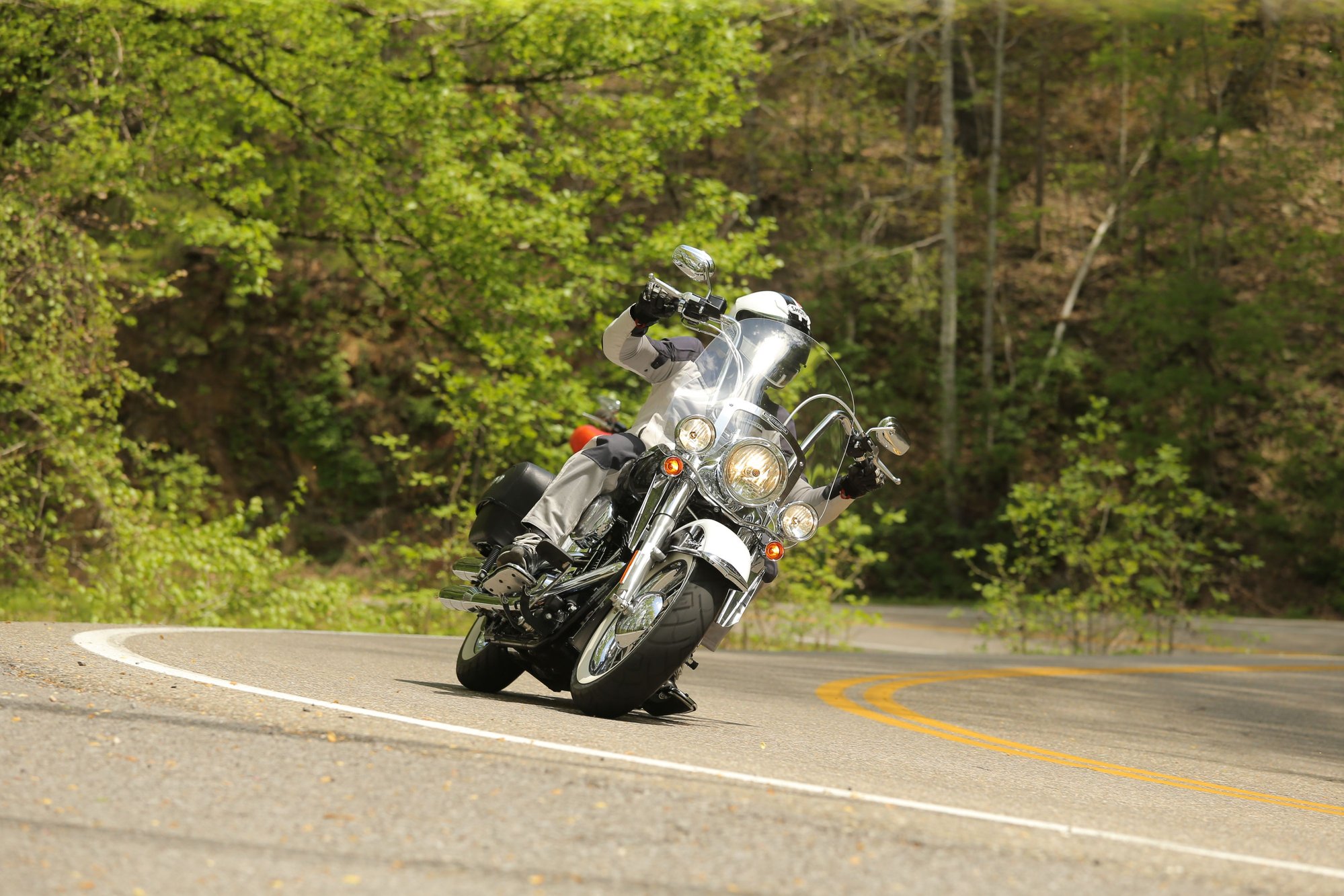

Old May 1, 2022 | 07:49 PM
badaim's Avatar
badaim
Joined: Apr 2021
Posts: 84
Likes: 49
From: MN
Default Progressive 422 shocks - scraping some pegs
Just came back from 1200 miles in the Southern Appalachians roads in NC and TN. Bike behaved well, the front and back suspension are quite compliant. The increased rear also helped with cornering clearance, although I was scraping the pegs quite often and hard... pictures at the dragon attached...
