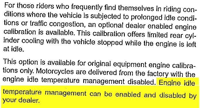

I have a 2012 Heritage as well. The excerpt below is directly from the 2012 Softail Owner's Manual (page 90).
You cannot enable or disable EITMS. The dealer must do it.
