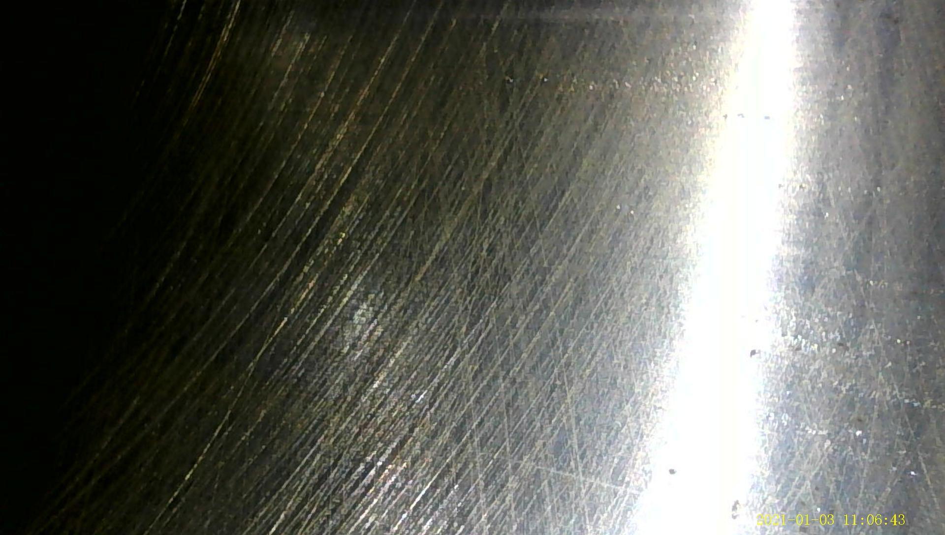

Thanks for that info. I did a cold engine (I know that a warm engine test is better and would yield higher results) compression test on mine, 39,000 miles and got 148 front and 149 rear. Thought it was odd to get more on the rear than front, but one pound difference isn't worth worrying about. Ran a bore scope down it
and both cylinders looked exactly the same.

Looks good to me, I believe you are just fine...
And will be for quite awhile with good maintenance habits..
