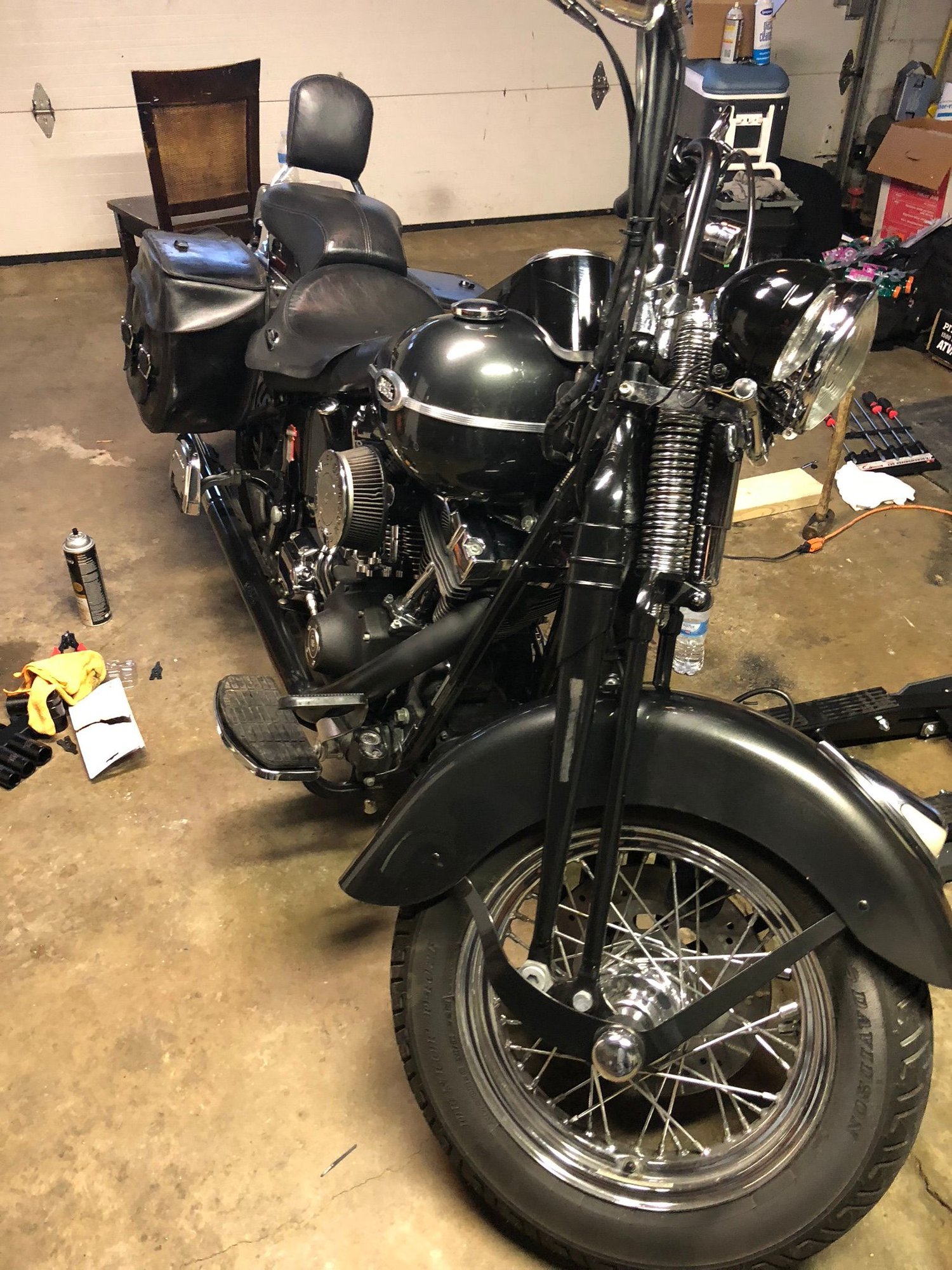

05 heritage springer. Recently replaced both tires steering neck bearings rotors brakes and rear wheel and my bike is still experiencing a wobble. I have 3/8 belt deflection at 10lbs everything is tight and lubricated accordingly. Tires inflated to 50psi. Running out of ideas..
