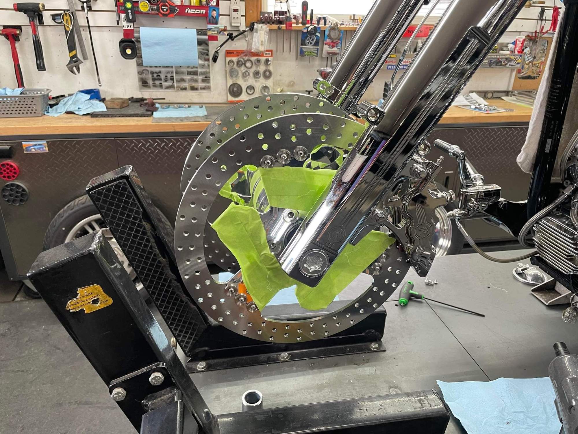

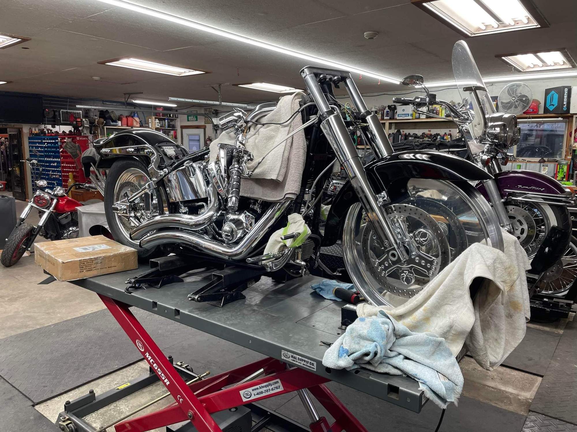

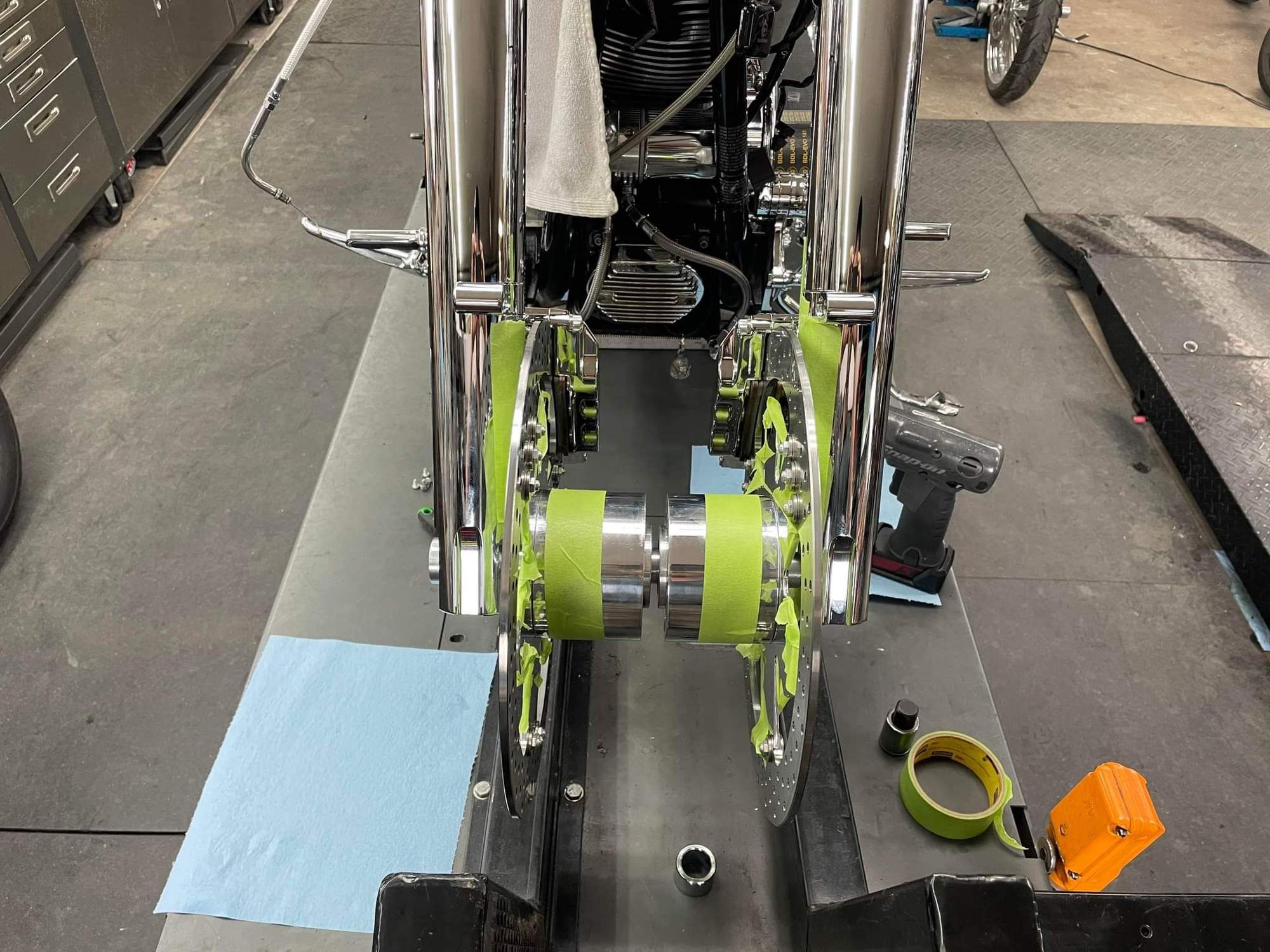

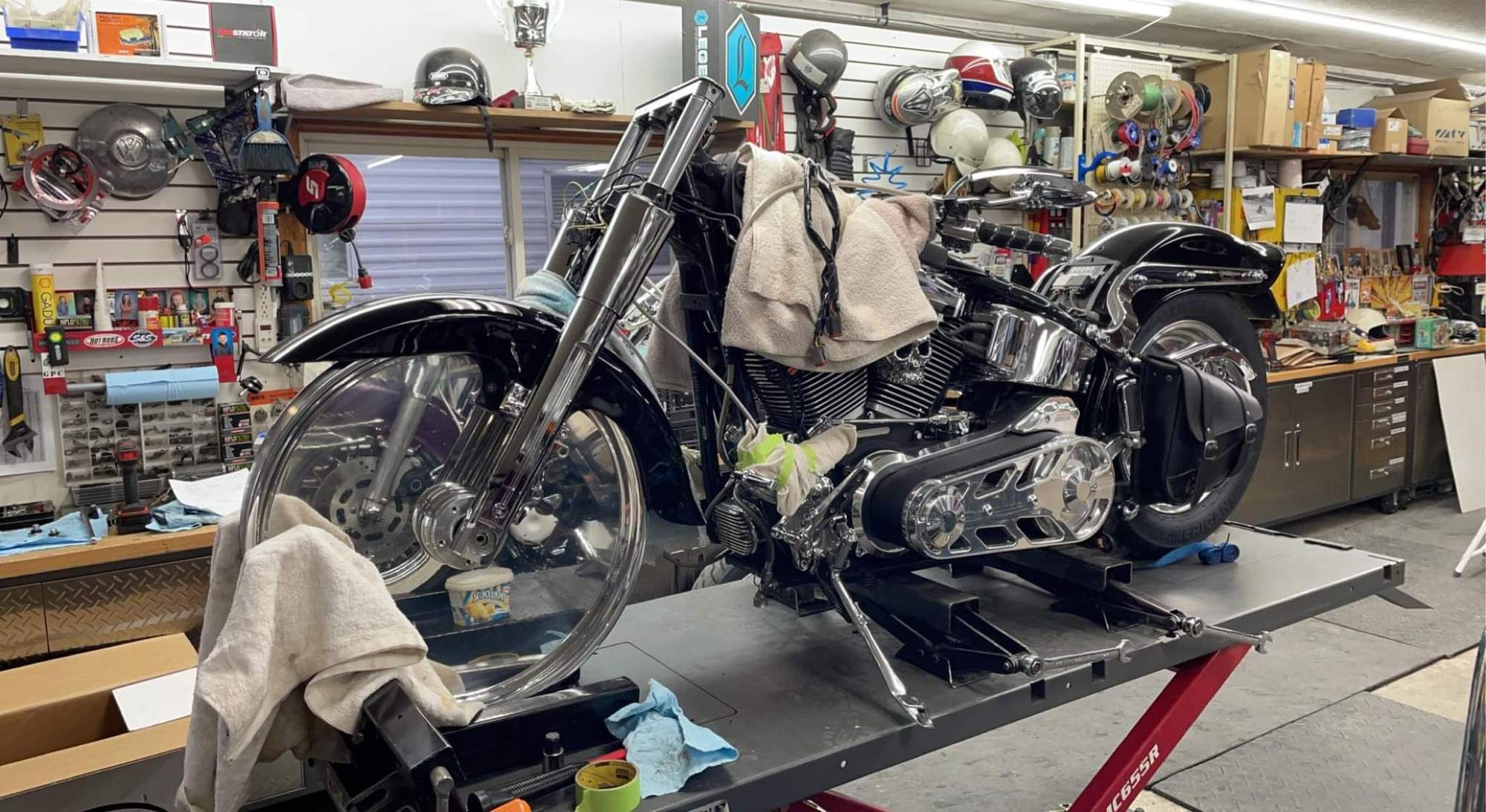

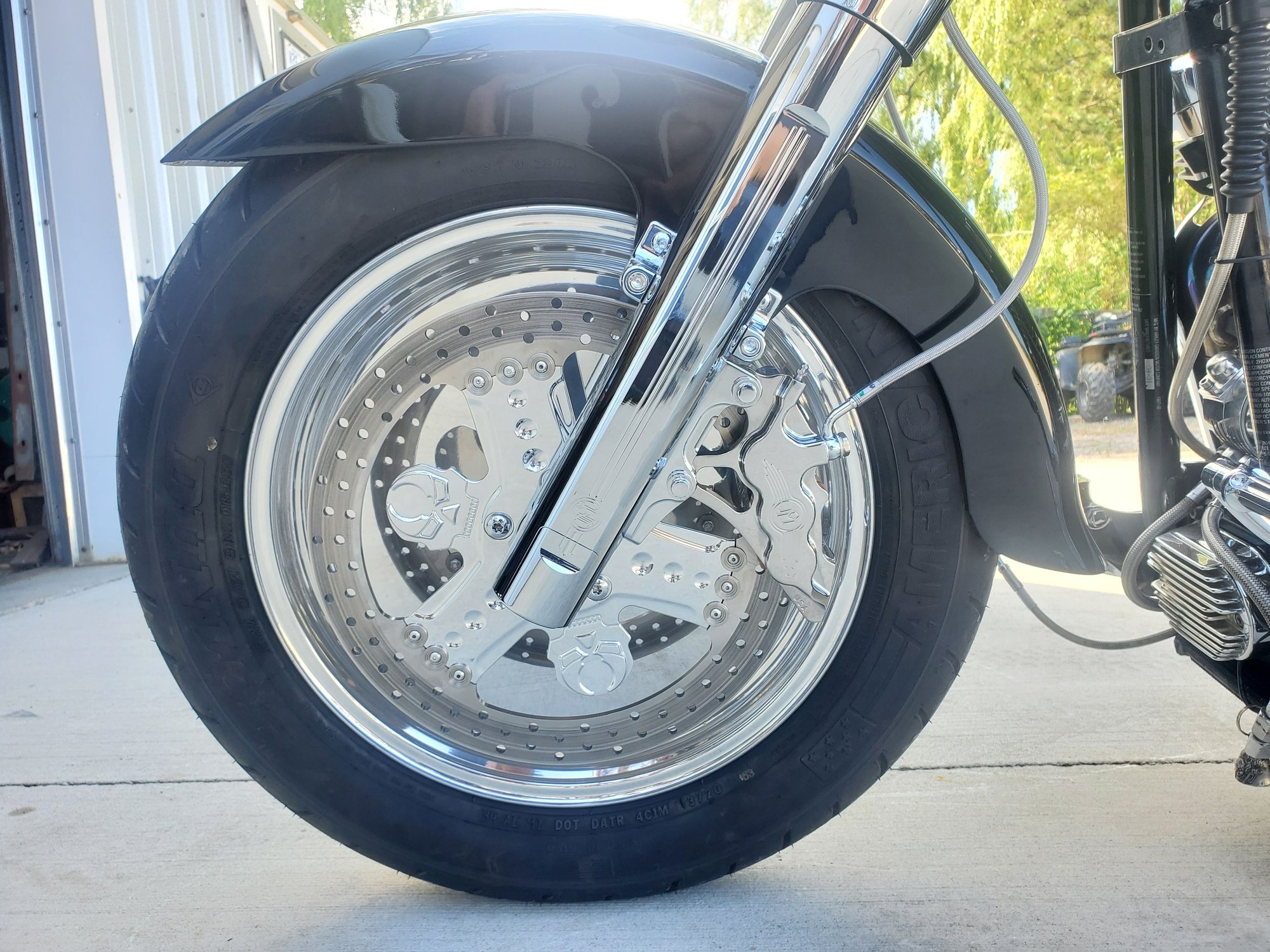

I did the dual discs on my '02 Fatboy, there are a number of approaches based on budget and styling. For myself I used PM lowers to give the caliper mounting ability, master cylinder (11/16") needs replacement (PM in my case), a tee for brakes lines. Since this deep I also did the PM 6 piston calipers and a set of 13" floating rotors. In my case my hubs needed to be machined to properly center and fit the calipers.
This winter is the install of a 21" solid billet wheel (that will start conversations LOL).

Woah, that's a great looking double disc fitment ! Here in France, I have put an Arlen Ness Big Brake conversion on my 2012 Slim and I have to say that it's already a great improvement for a lighter cost. Even though it's not as efficient as a double disc, it's a good solution too

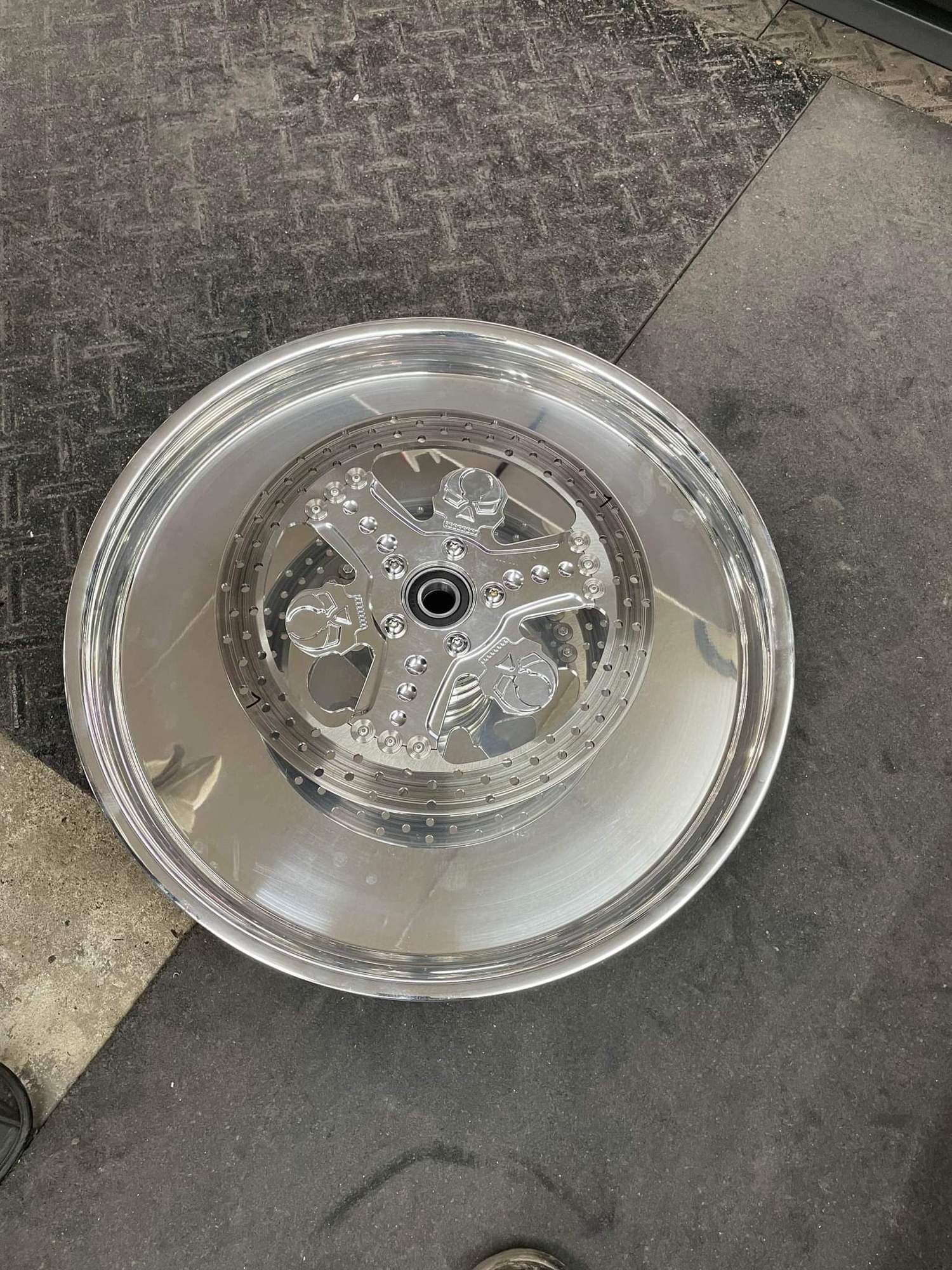

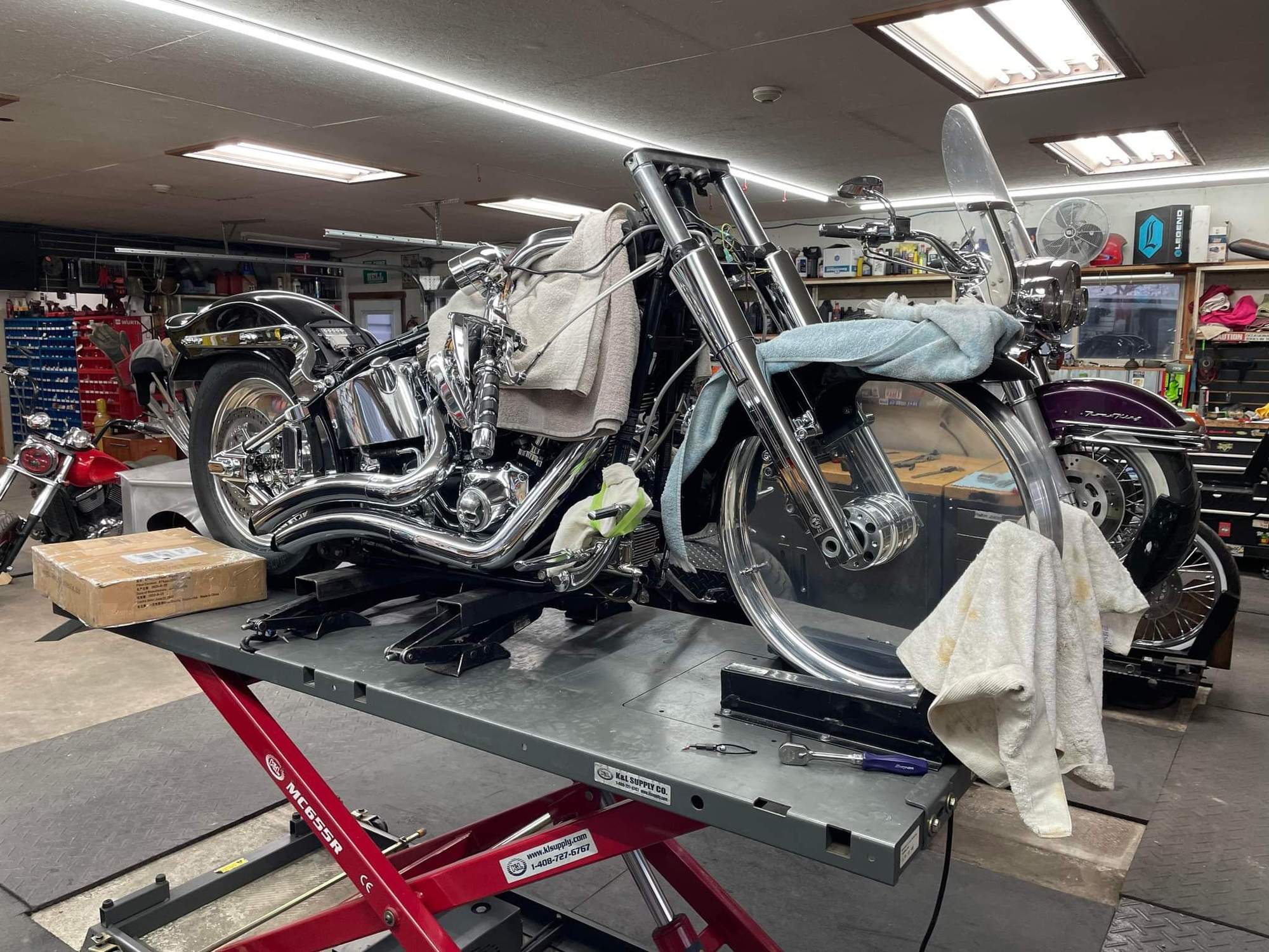

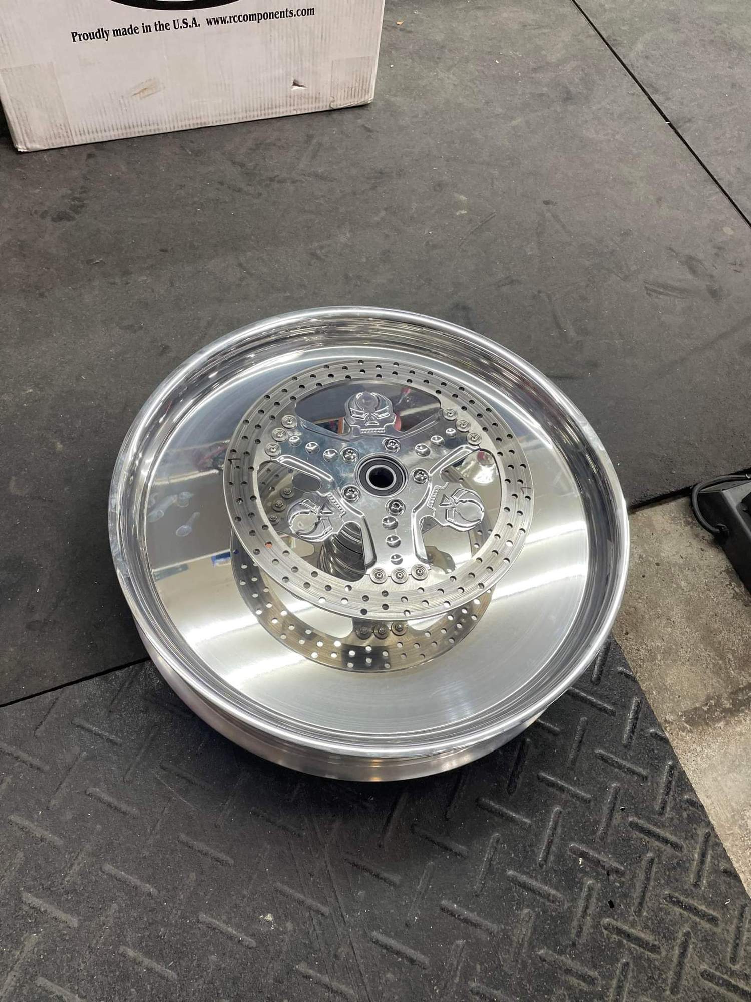

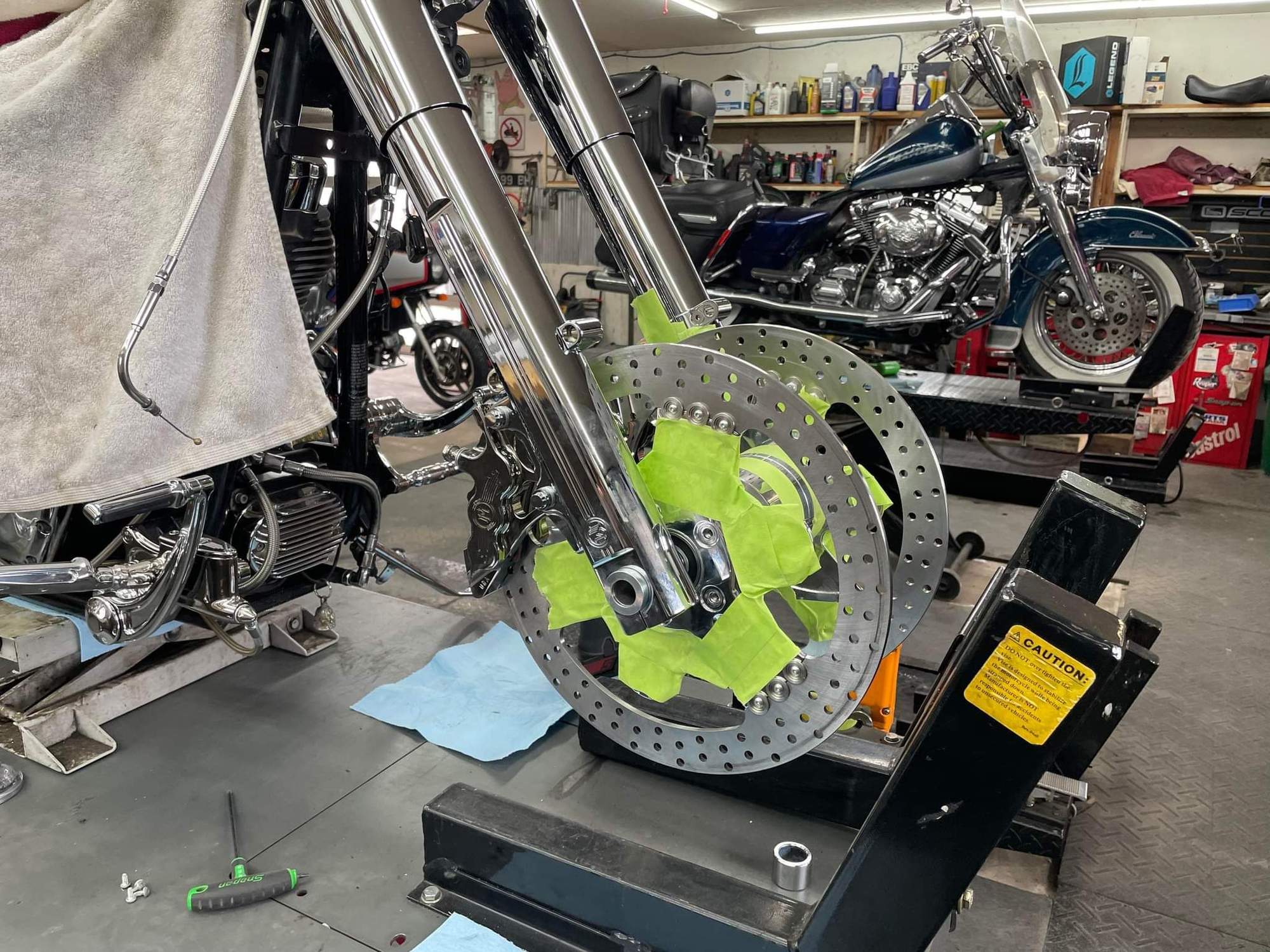

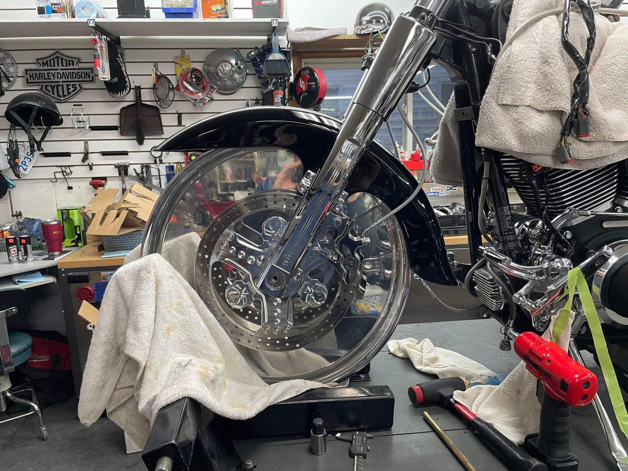

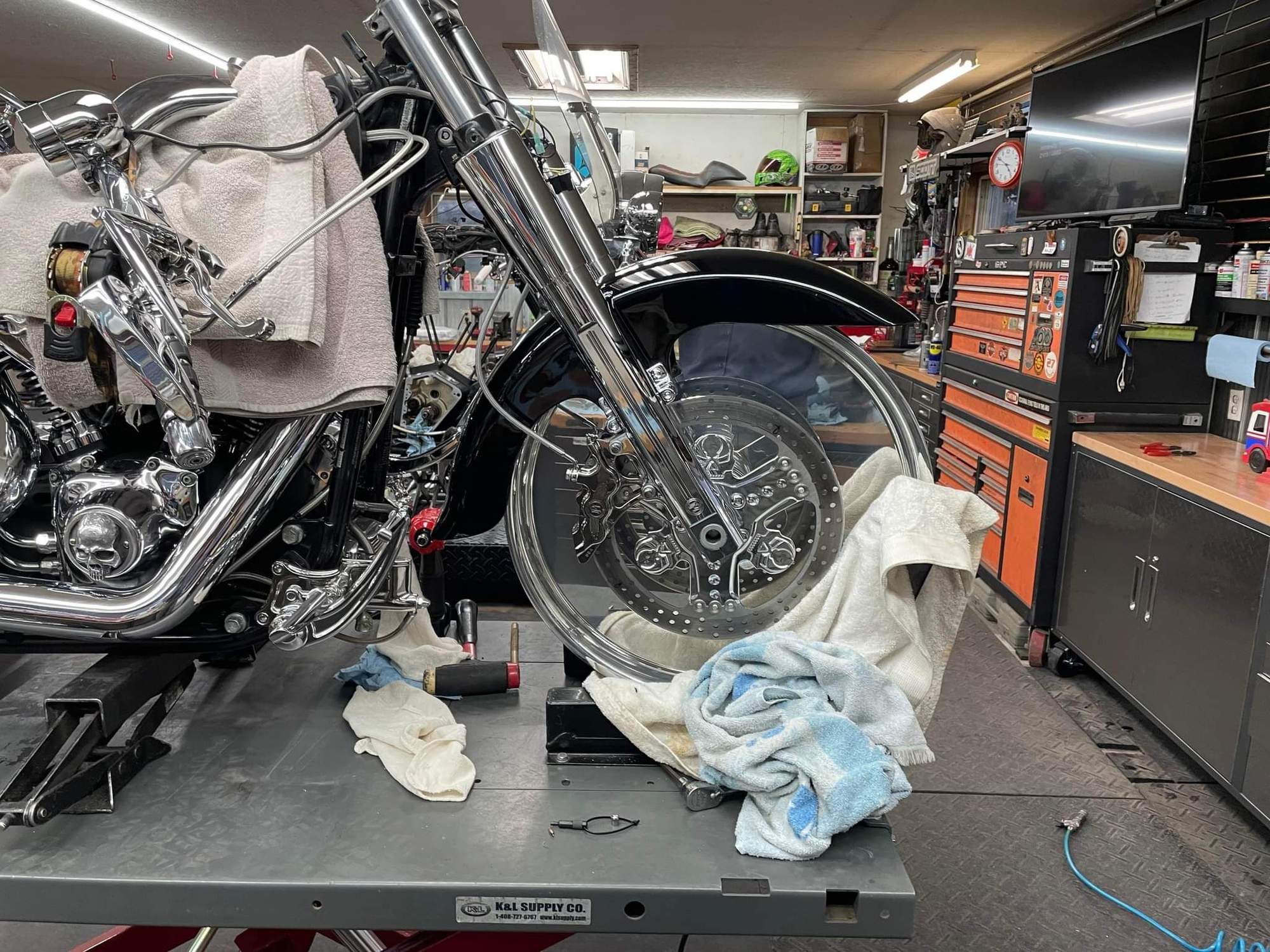

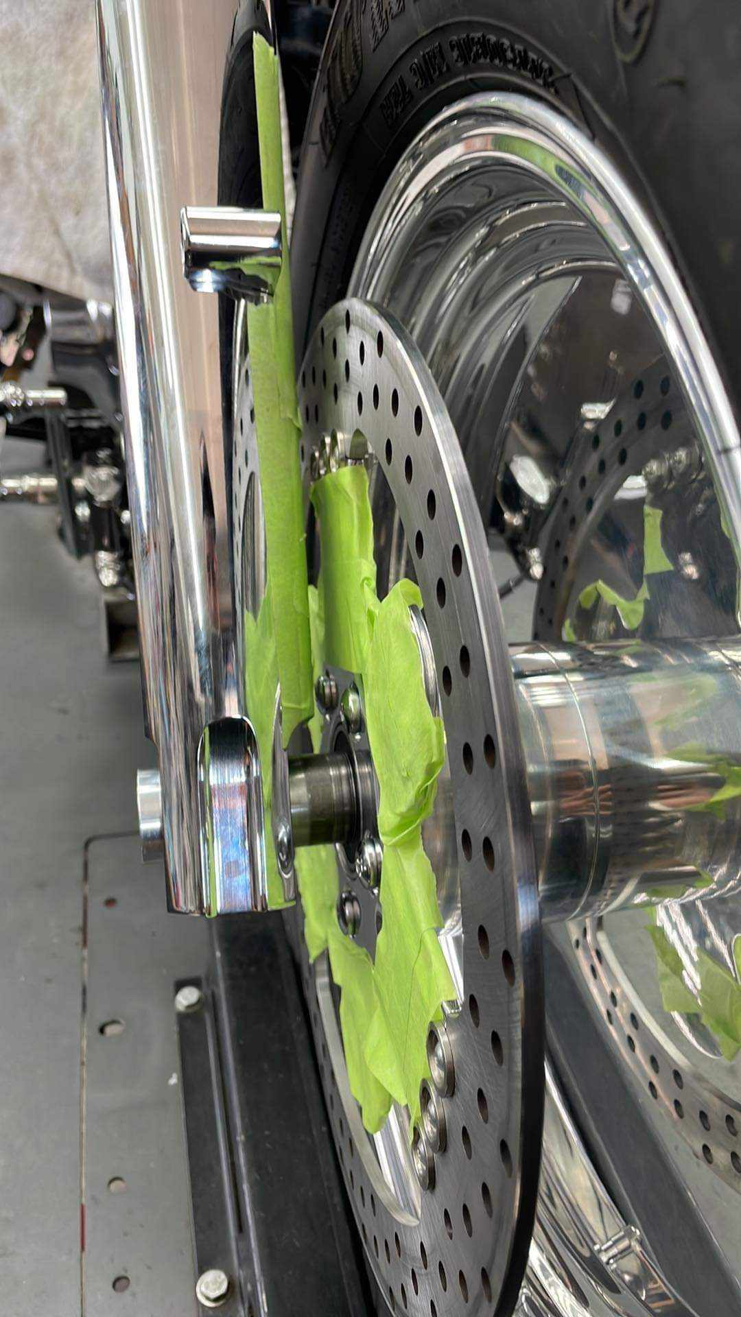

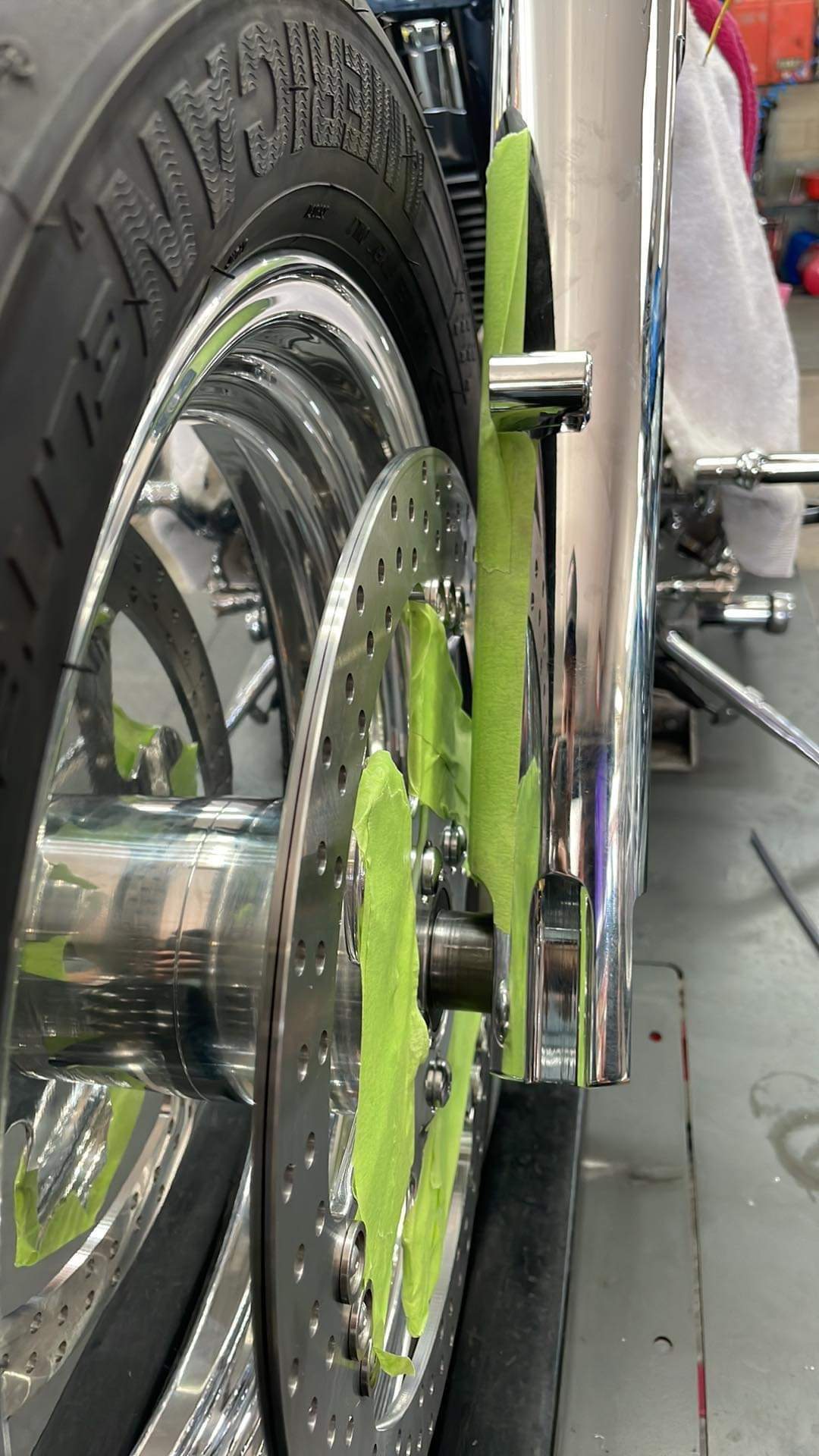

The 21" front rim arrived, I'm keeping the 16" in the rear. A 4 degree triple tree is going in at the same time. Hubs previously machined bolted up and just a change in spacers to get everything aligned.
