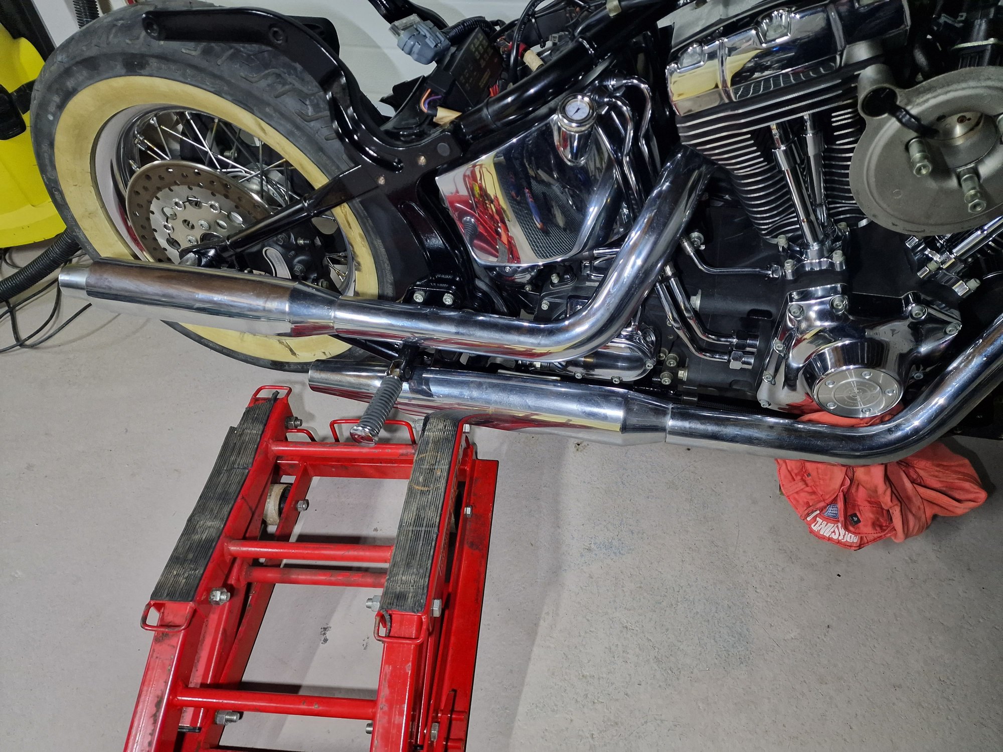

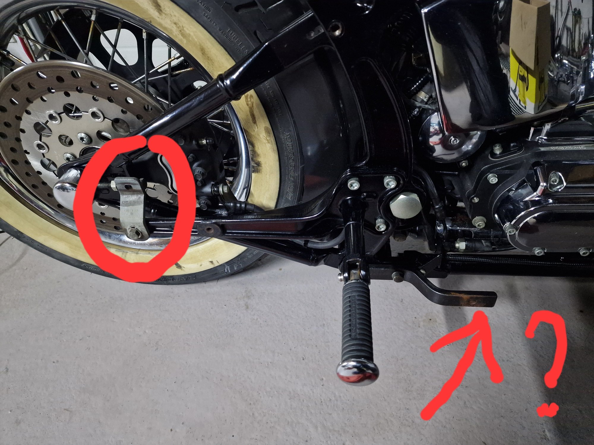

Hi ,help, need a photo or bracket part number, that holds front exhaust. Rear cilinder exhaust bracket is in place.

Originally Posted by Andriusa
Did not find exhaust like mines🤔🤔
Not stock, note the bracket you circled clearly says "Cycle Shack"
They are out of business

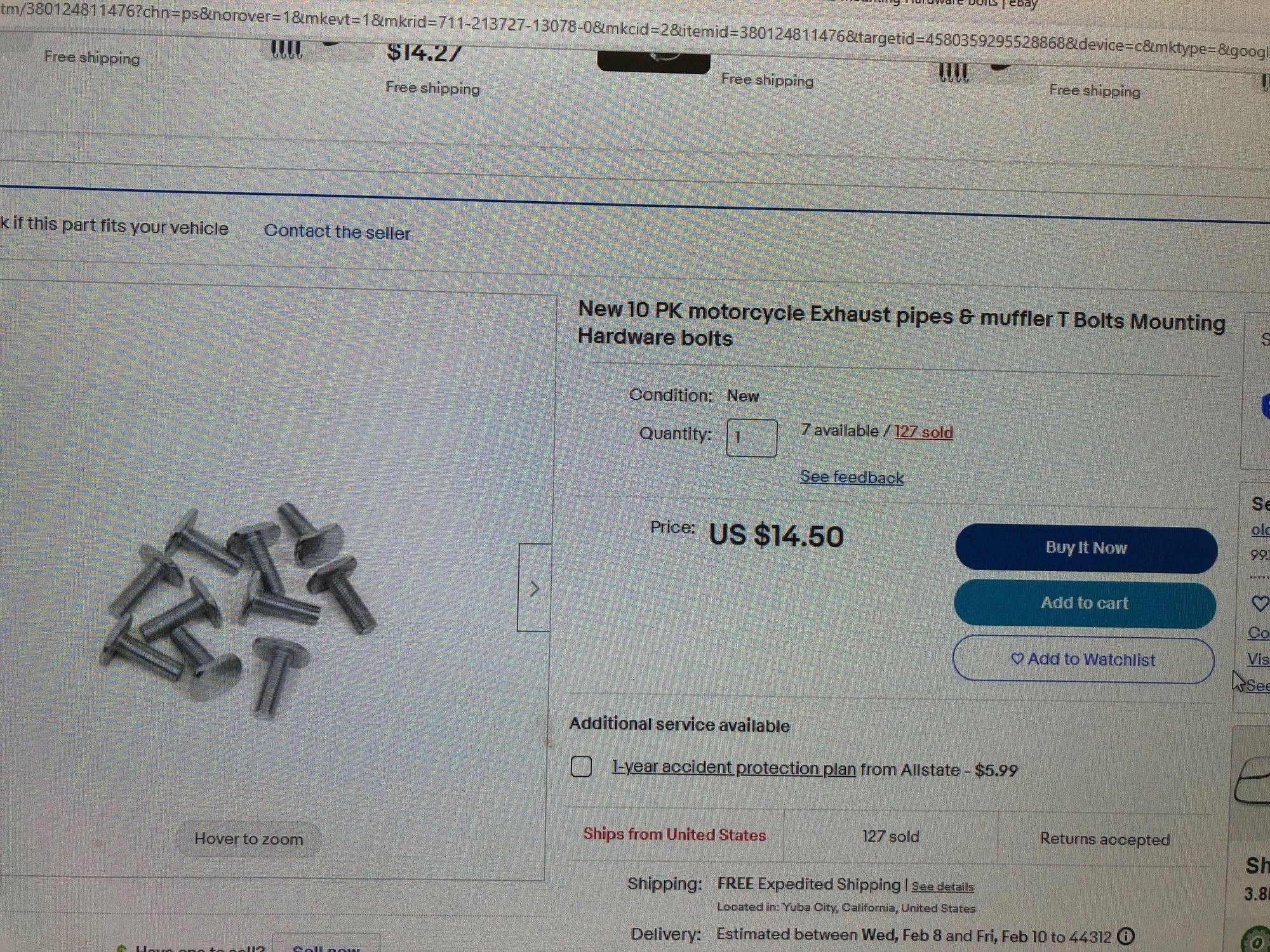

Are there T slot brackets on the backside of mufflers ?
thanks then, thout they original

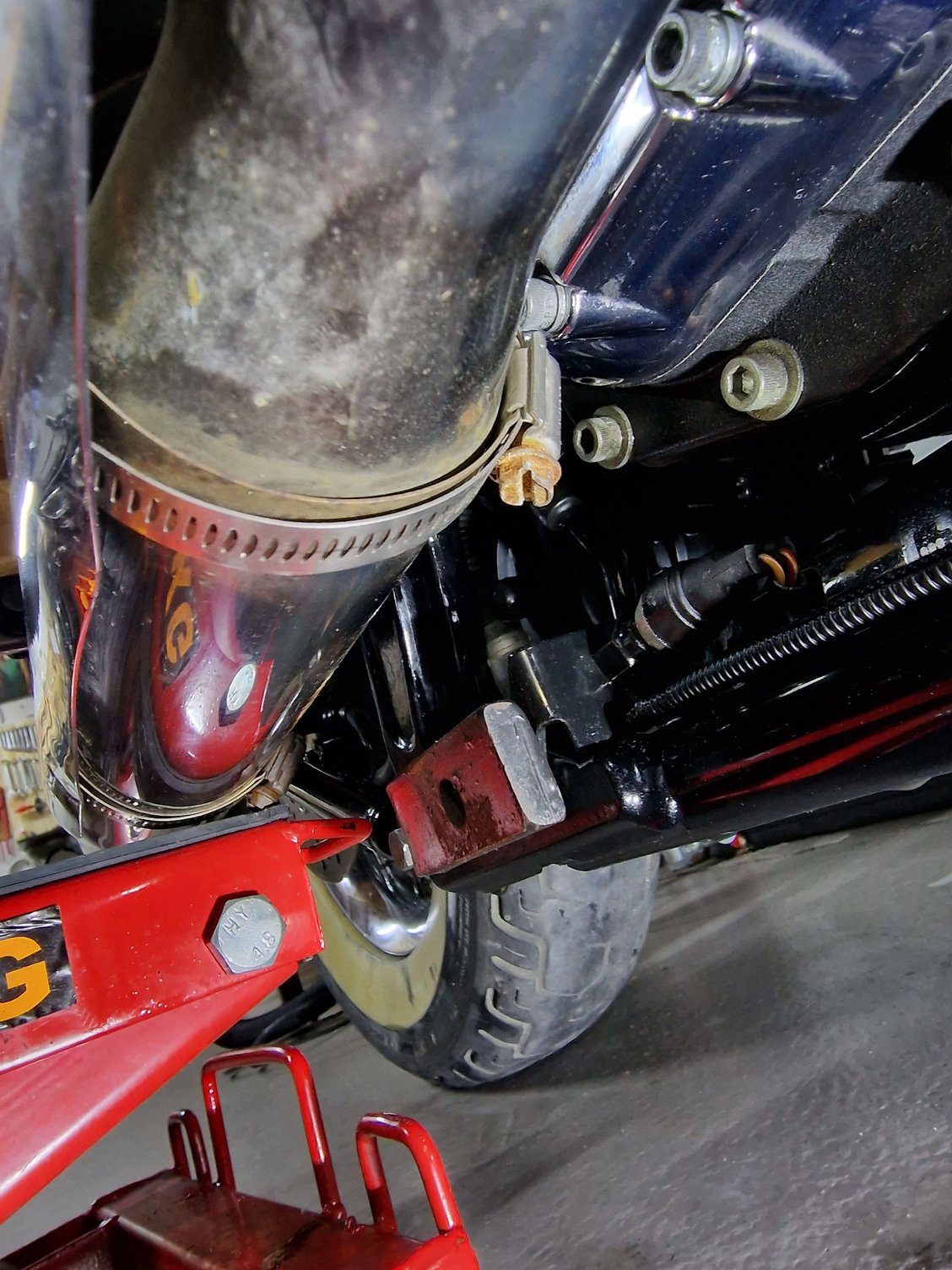

So now you need to fab a bracket
I `m picturing a a simple piece of bar stock with a hole at each end
Bolt up tight to mufller at top
Then perhaps a longer bolt with a round spacer in between the bar and the lower mount
Easier than bending a piece ( at least for me)

I assume you have a similar bolt in the rear muffler now ?
