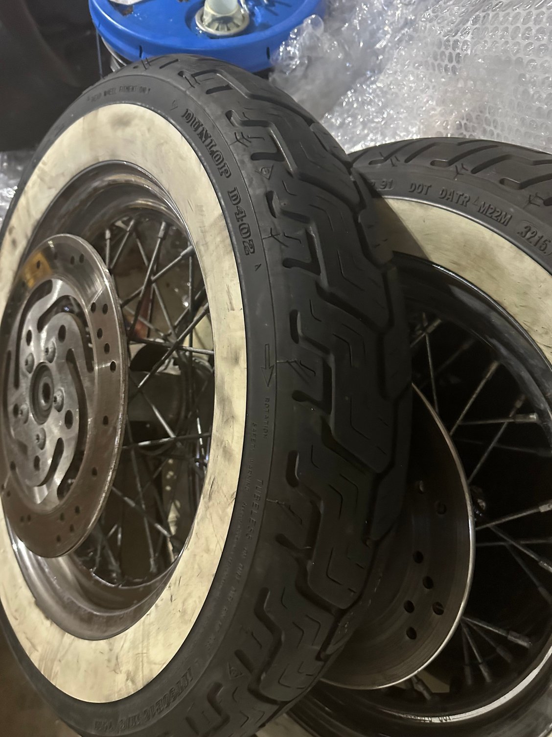

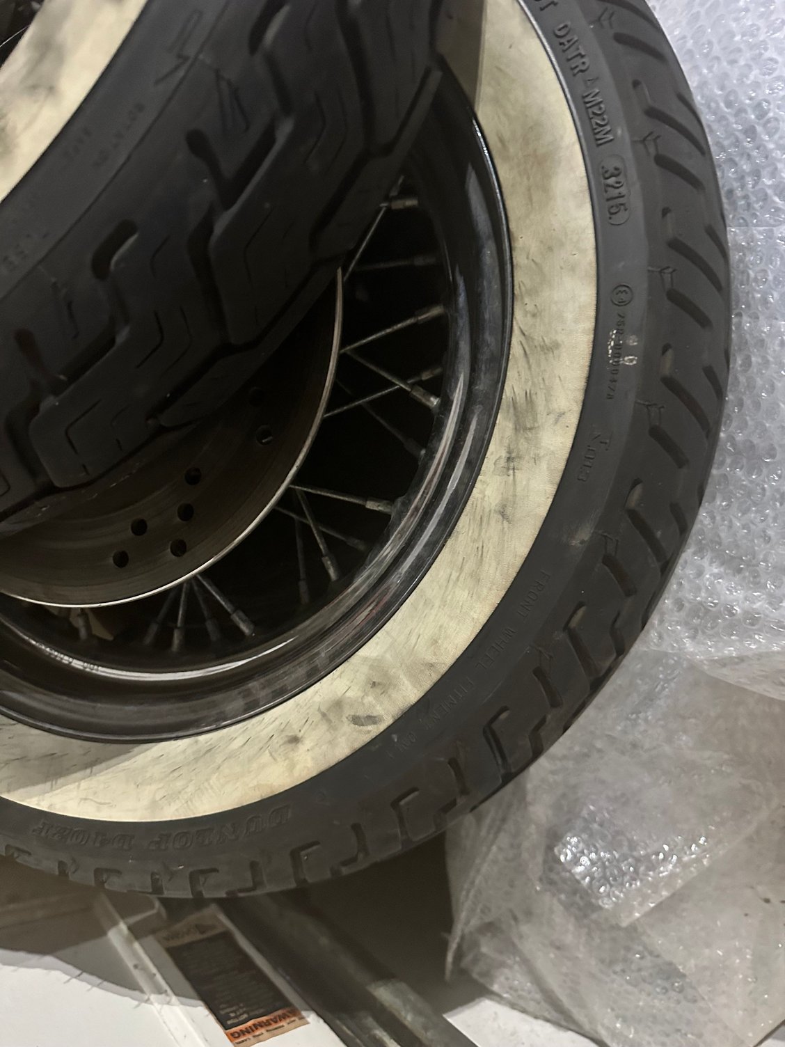

Originally Posted by matte
Note shipping not likely cheap. But the wheels are authentic.
Not to throw a stone on this, but you may want to give him a mfg date code on the tires.
Old May 17, 2023 | 11:13 PM
Hog Augie's Avatar
Hog Augie
Joined: Apr 2020
Posts: 101
Likes: 77
From: Central Okanagan BC
I saw in first pic that date code is 3215. Bit old for the rubber
took the words right out of my mouth...
Old May 18, 2023 | 01:15 PM
hattitude's Avatar
hattitude
Posts: 14,225
Likes: 11,350
From: San Diego, CA
I don't usually comment on for sale items, but since this is not the for sale section, I will offer my opinion...
OP, those wheels should fit. Per the online parts finder, the two bike years use the same rim (#43085-97) and hubs (#43672-00 front/ #40976-00 rear).
However, with a date code of "3215", IMHO, those tires are unusable. They were manufactured in April of 2015. They are just over 8 years old. I would not run them, I don't believe they are worth any money, and they will just needlessly add to the shipping charges. Once received, they would need to be demounted and disposed of.
To the seller, unless you have a a cheap, easy way to demount those tires, I don't see you being able to sell them for a fair price to both seller & buyer if you need to ship them with those tires mounted.
Just offering an opinion, you two need to work it our via PM...
Good luck to both of you...
