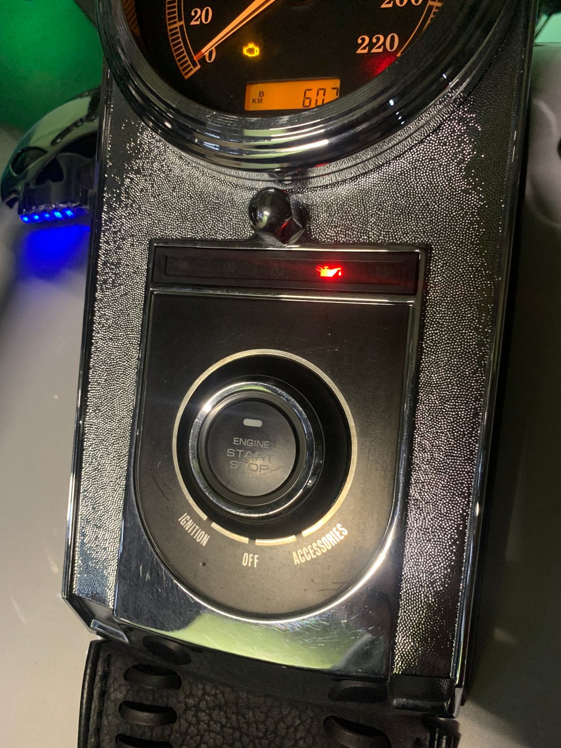

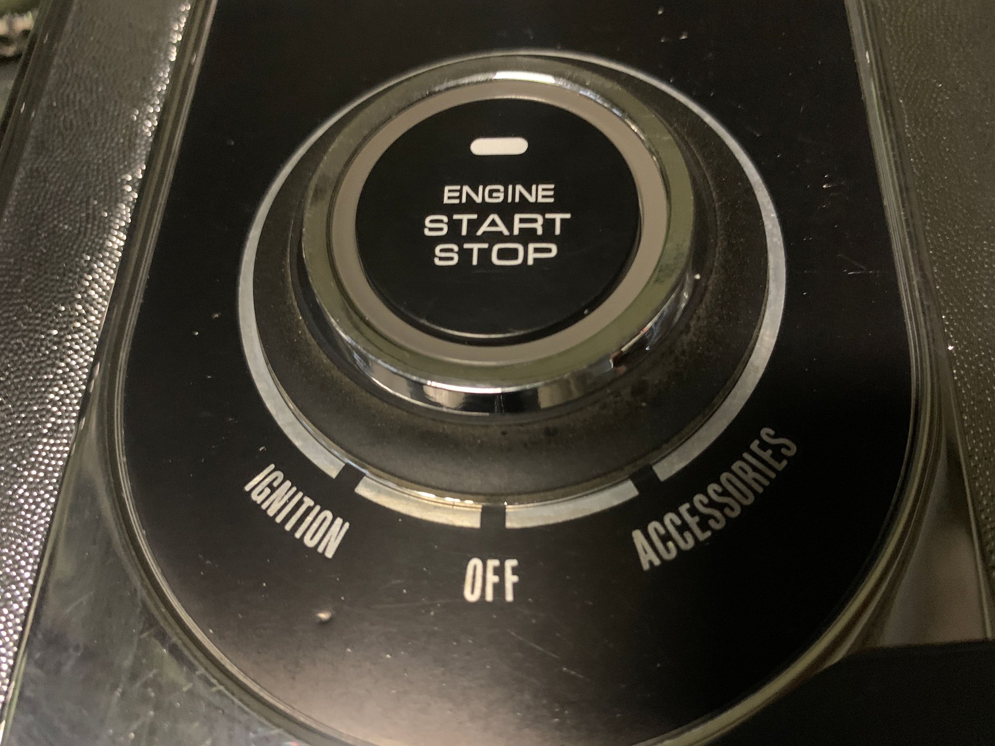

Hello everyone Here's what I did instead of the rotary switch .
Everything works well.
But one problem remains, I want it to work like this when I come up with a key
automatically, when the alarm was unlocked, the start button could also work.
If I leave the alarm is blocked and, accordingly, the button should not work.
The next question is where can I find in the circuit a ground point that turns off when the alarm is blocked?
Is there such a point at all? If there is, where? Can you give the coordinates ?
If anything, sorry for my English !
Here is a link to a Youtube video showing how it works https://www.youtube.com/shorts/ZBOnvBynZ8E

ontrols it all. I have driven 6000 km (3728.227 miles) already and everything works great. Moisture does not get in, of course I additionally worked with this.

Originally Posted by Stinger1
My question is, Why?
While I like having a key switch... the new thing is a keyless ignition.
There are many threads on this forum alone about how to accomplish this very mod...
From what little I've read on it, since I'm not interested in going that direction, if you have the proximity FOB/alarm system and a BCM, it's pretty easy to do...
The OP has proximity alarm, but no BCM... so it appears he found a good way to accomplish this mod...

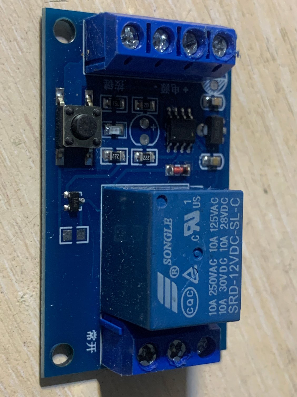

Not sure about ground.
Love that idea though.
Where did you get the board?
Looks slick.
Looks slick.
on aliexpress
"5V 12V Single Button Bistable Switch Bi-Stable Relay Module Car Modification Switch One-Button Start-Stop Self-Locking"
