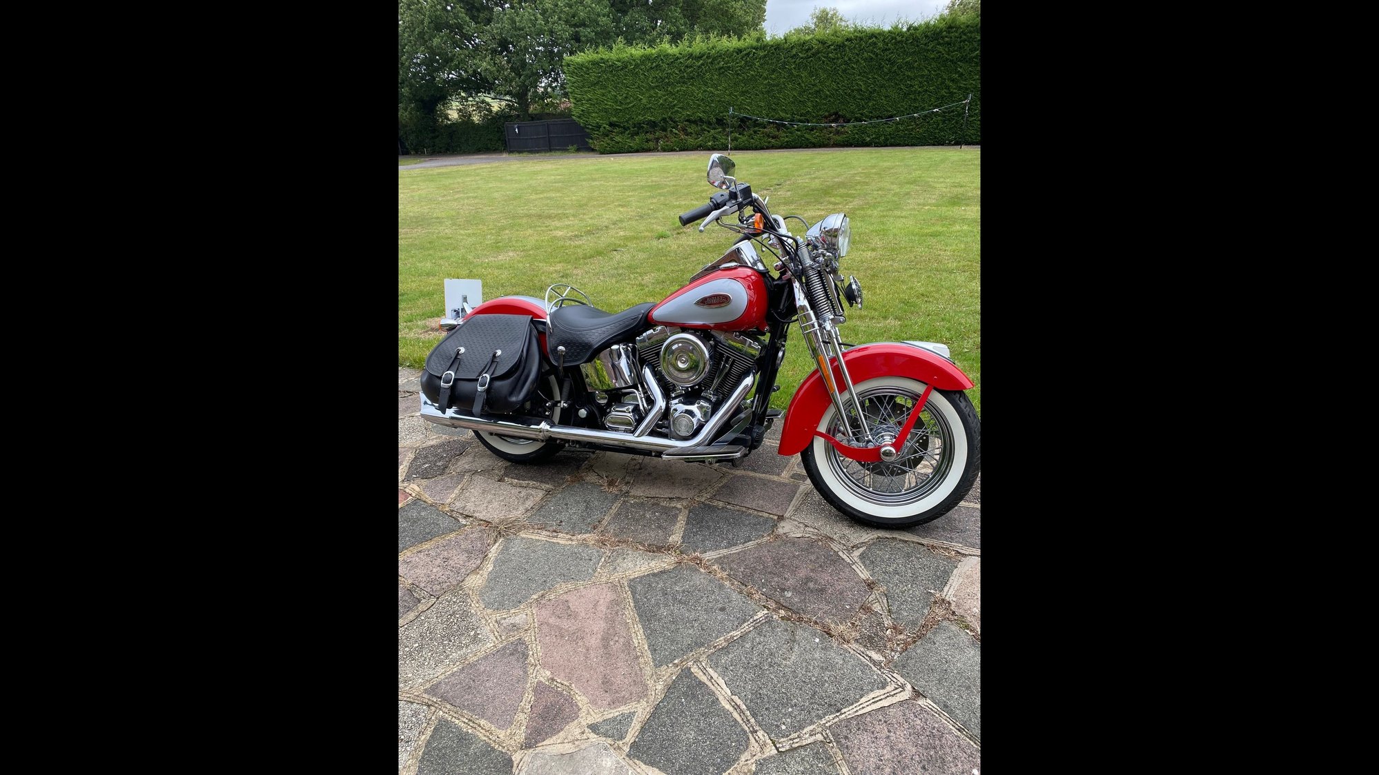

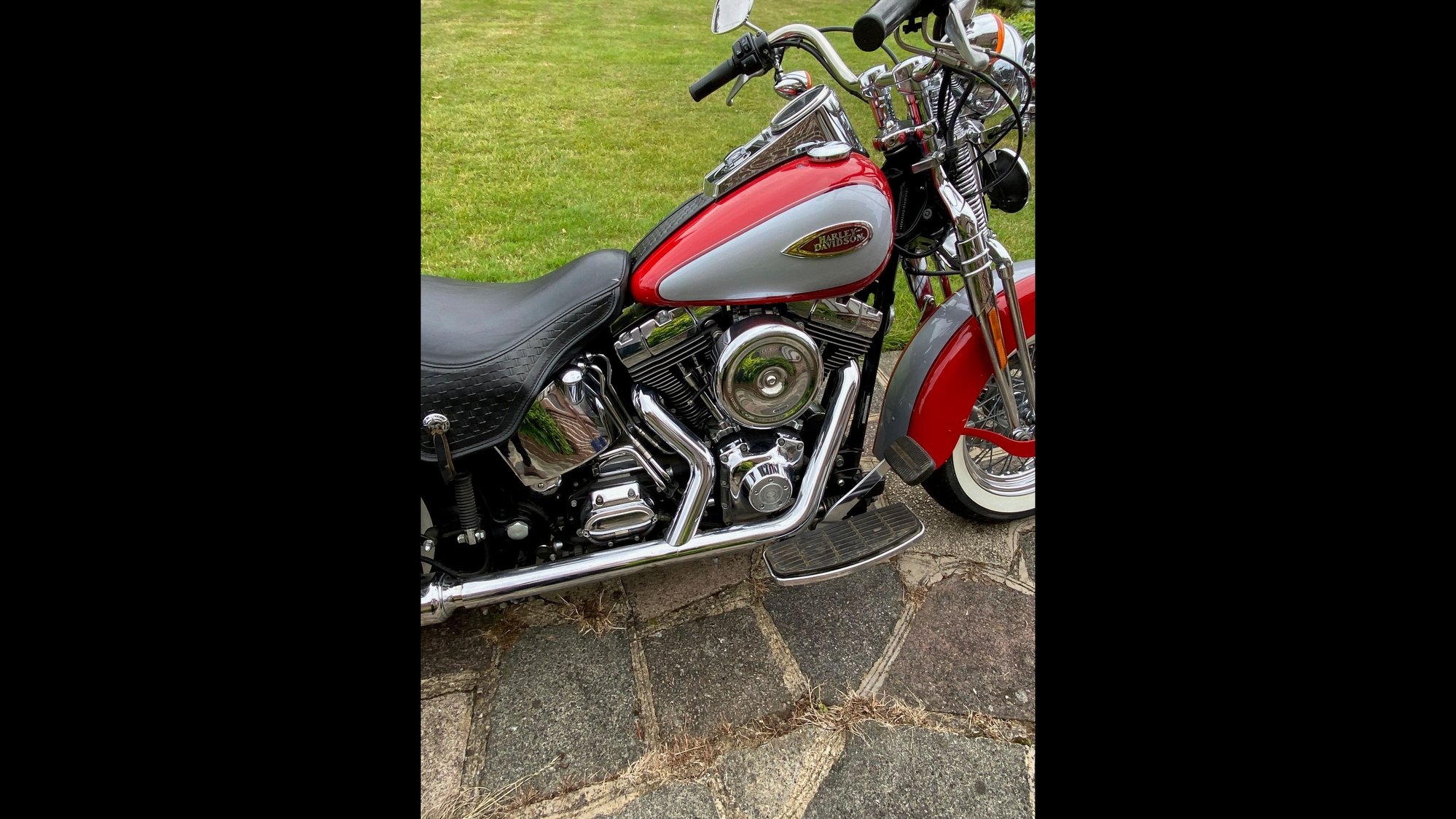

Taking ownership of a 2002 Heritage Springer here in Scotland. She has 18,000 miles only on a 21 year old machine and has been regularly serviced (mainly fluids and consumables) by both dealers and experienced home mechanics. I am aware I need to check cam chain tensioner wear and the rockers on the forks. I do not believe she has been 'beasted' as both previsous owners are elderly gentlemen and shes just too heavy for them now.
Any guidance you can give on other tasks / jobs that you would suggest? I am told she has had a 'big bore conversion to 1550cc and a new uprated carb. I cant confirm as yet as Im still awaiting delivery. Once shes at home i will post some more pictures. At this stage Im just building a master list of 'to do / check'. Regardless I will service her and sense check all the manuals (coming with the bike).
1st post of a new member so be gentle please.

Great looking Springer and congratulation on your new ride.

I agree and check the date code on the tires. If more than 5 or 6 years old. Get new rubber. Change the fluids, check the air filter ect. Enjoy, that nice looking Springer.

That looks to be a really clean bike.....
Update the cam tensioners and check the springer rockers and you should be good to go for many miles, and many smiles...
FWIW... I have a 1550cc (95") big bore kit on my 2003 Heritage... It runs very well...
My '03 is EFI, but my 2001 Springer FXSTS, has the OEM Keihin CV40 carb. I think it is a very good carb, underrated by many, and suffers from the bad reputation of the Keihin butterfly carb that preceded it.... Even if the "new uprated carb" is just a re-jetted OEM CV40 carb, that will be all you need for the big bore kit....
Enjoy....!!!!

Welcome. There are a lot of knowledgeable people here that can answer questions you might have, or many Google searches will bring you right back to this site. That’s a nice looking ride. Grats!

"Looks like" a Mikuni carb in pic
Bike looks great

Very sweet looking Springer, gotta love that seat. Enjoy the new ride
