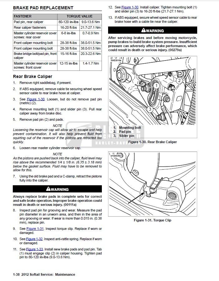

So I am looking for torque specs for the rear caliper mounting bolts as well as the pad pin bolt! Anyone have a service manual for 2012 softails? Can you help a bro out? I am getting many different answers!
