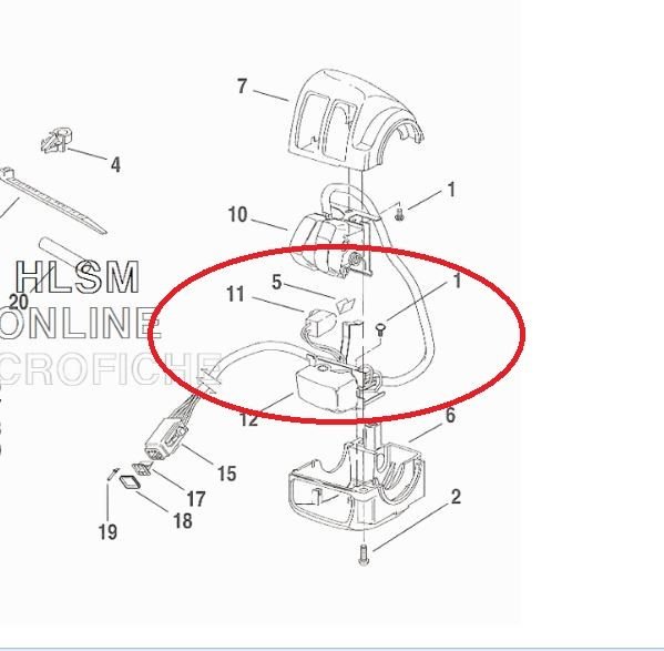

My money is on the V clip that BFREE pointed out. The same thing happened on my '08 heritage classic and the dealer didn't have the clip. I ended up cutting some clear plastic tube in half to replace the clip and it's held up for years.
ETA: the clip goes where arrow 1 points.

Originally Posted by BFREE
Not sure what year or model your bike is. They used to have a wedge (V clip) in the front switch housing that held the brake switch in place. If that wedge broke the switch would move back in the housing and the brake light stayed on. The link is for a 2005 Heritage but might give you an idea about what I'm talking about. When you open the housing you're suppose to put a certain size wedge (3/16 I believe) between the brake lever and bracket so as not to put pressure on the switch which can break the V-clip. #9 in the diagram.
https://www.harley-davidson.com/us/e...OFTAIL_CLASSIC

This is the picture you need.....
# 5 is the wedge
# 11 is the brake switch

Pretty sure this is the part #: 71587-04

Picked up the switch today but they didn't have that little wedge in stock so he had to order me one. Probably take a week he said.

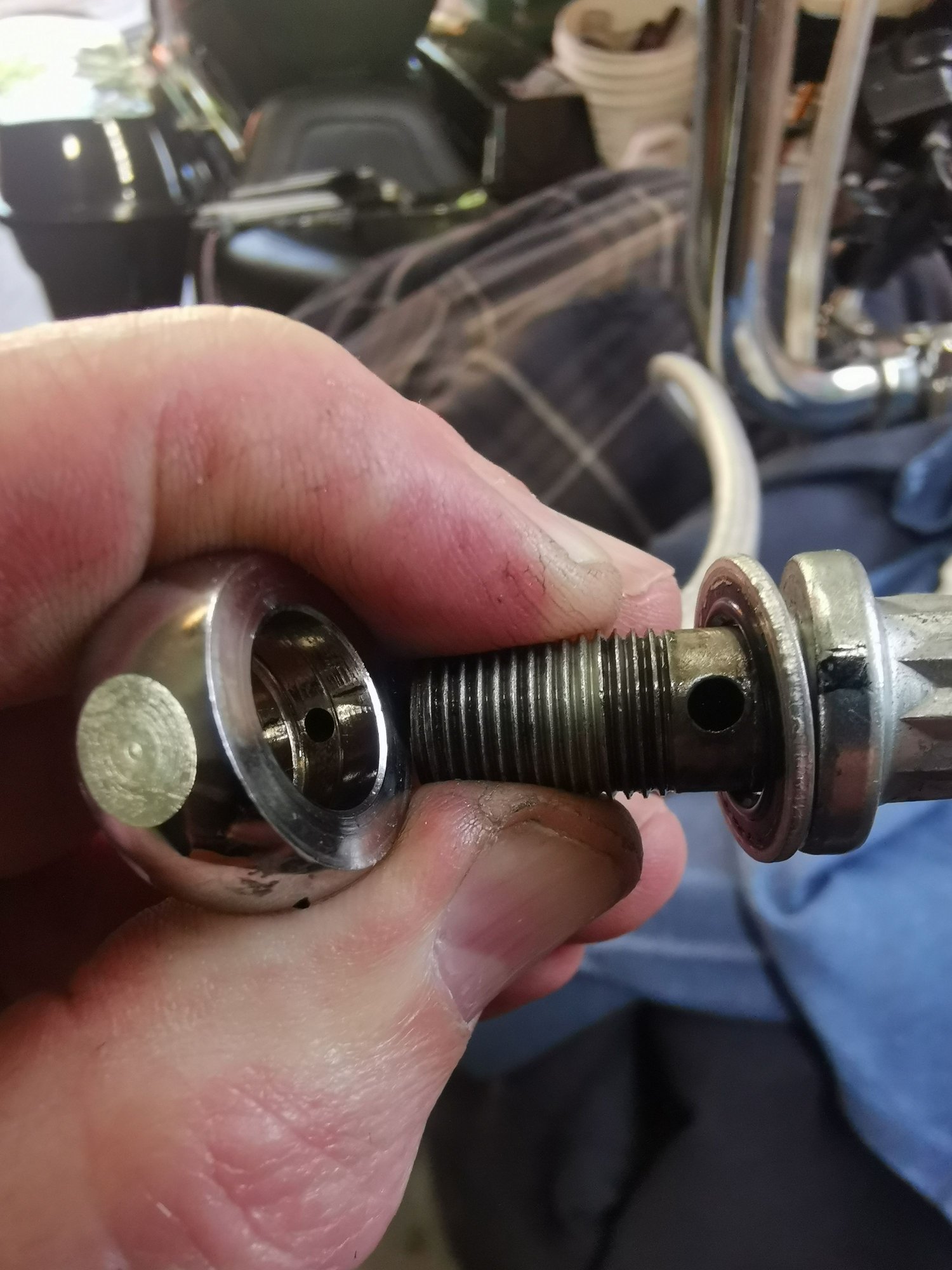

Well I have a new front switch soldered in and I'm in the process of installing the new chrome front master cylinder and chrome levers. At this point the rear light is still stuck on but I don't have any fluid in the new master cylinder as of yet. Now my question is does the hole in the banjo bolt have to line up with the hole in the Chrome brake line fitting when tightening the banjo bolt or does the fluid just float around the bolt regardless of where the hole lands when tightening?

The holes do not need to align. There is a channel in the fitting on the line that allows brake fluid to flow without the holes be aligned.
Paul

Excellent thanks so much. I assumed as much but I just wanted to be certain before I crushed the washers.
