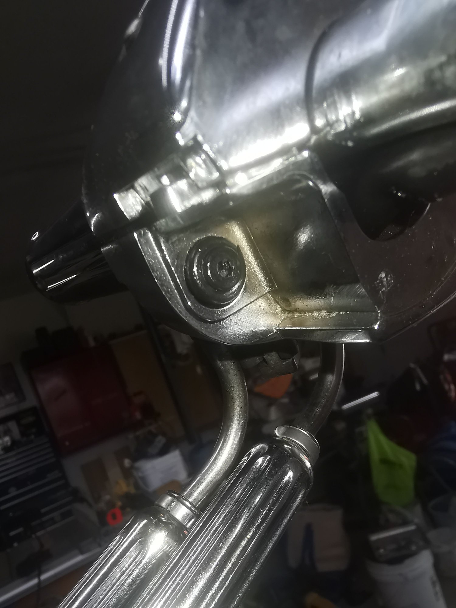

So after my issue with blowing engine oil all over the place on Saturday I noticed on Sunday before getting out for my 1st ride of the season that my rear brake light was stuck in the illuminated position. I pulled the plug for the rear brake peddle and the light still did not go out. Proceeded to remove the front brake lever assembly so I could actuate the plunger manually but the light still would not go off. When reinstalling the brake lever ( too late to watch a YouTube video about breaking the tip off the plunger ) I did in fact break the little tip. Either way the light is still on. Is it possible I just have a faulty switch regardless of the broken tip now. I'm gonna spray some stuff in the switch as well just to see if that works but will have to replace the switch now anyway I guess. Not sure if I can glue that tip back on.

Technically if I remove the brake lever it allows the plunger to the switch to extend all the way out which in turn should turn the tail light off if that's the problem correct? It wouldn't have anything to do with the master cylinder at that point if the master cylinder is not being used to engage the plunger. With the lever completely out of the equation I can use my little finger to push the plunger to the switch in and out yet the light still stays on. Perhaps I'm missing something.
