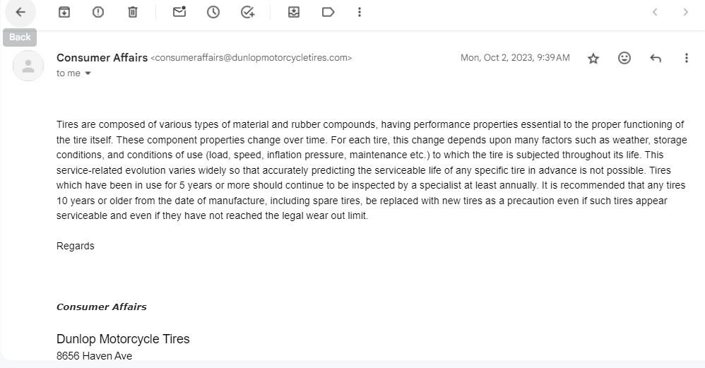

This is from Dunlop's Consumer Affairs Group. They sent this to me in my asking them for their official stance on length of motorcycle tire life. They state up to five years no problem, just ride. Then they state that after five years to ten years they need to be inspected at least annually by someone that knows what to look for. After tens years, no riding.
Me personably, I won't run a tire after it's five years old. I've seen several that just disintegrate at highway speeds. My life is worth the price of fresh tires.

Like Ohio, I go by the five year rule. It helps that the bike was stored inside, and people look for cracks and do the thumbnail test to judge the tire’s condition. But it’s only two little patches of rubber keeping the shiny side up. It sounds like you’re enjoying the bike and riding it, and I bet you will love the way the bike feels with fresh rubber. Tires have improved over the years. The statement from Dunlop, with their corporate liability concerns, giving a 5-10 year window for tire life, speaks to that.
