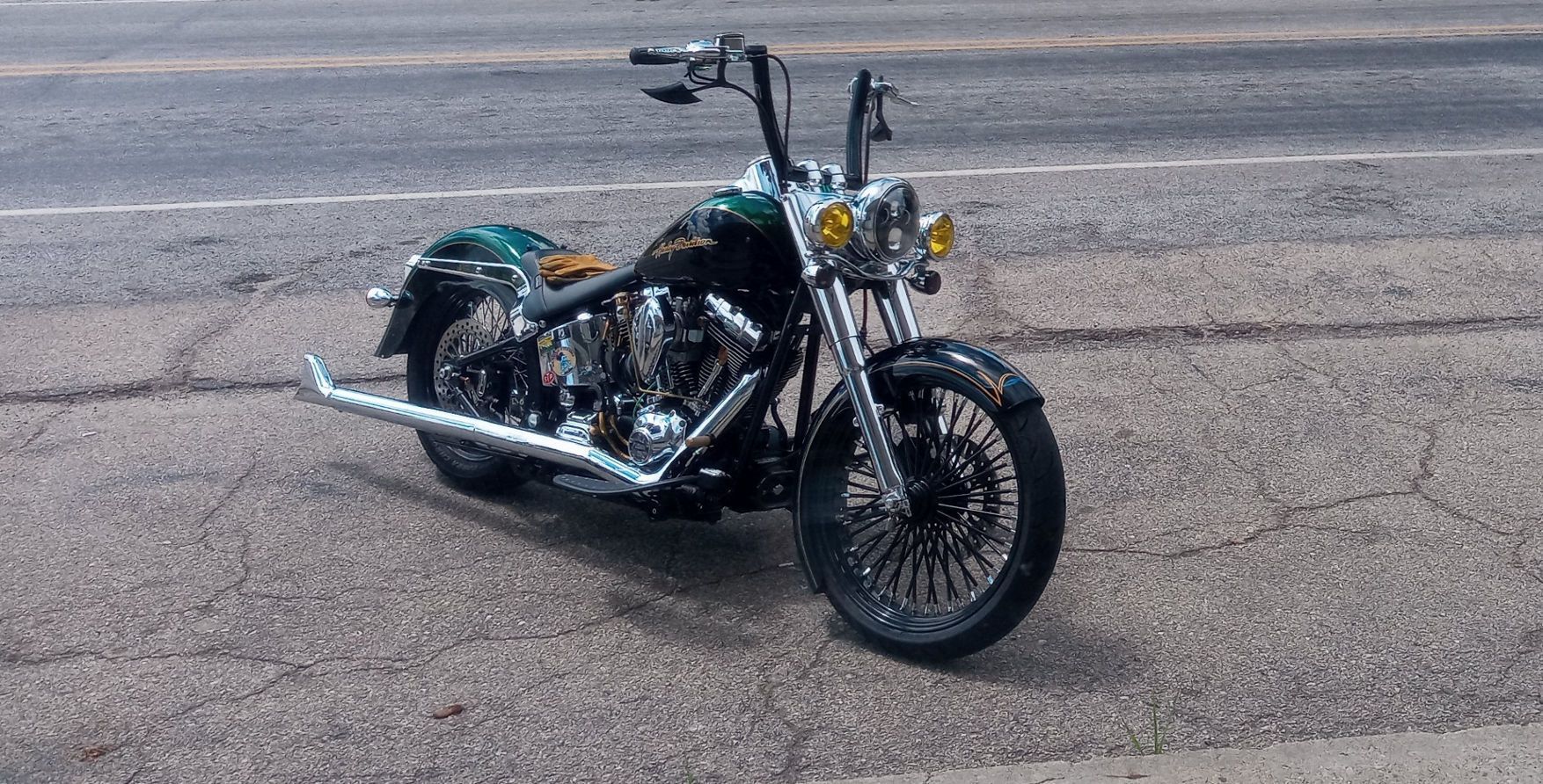

As I said above I lowered my rear 1 1/2" but I also installed a 21" front and a 18" rear so that's why it sits great on the kick stand. Yeah I called it a kick stand and always will.
