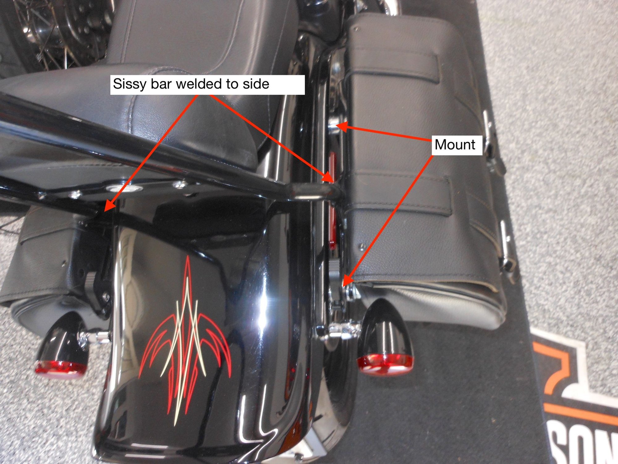

My bad, I accidentally misspoke.... The luggage rack having it's own mounting pegs is on my bagger.... I confused it with my Softails...
I just remembered that my '09 CrossBones has the quick detach sissy bar. After inspecting it, I only see two quick detach mounts, unlike the four available on the bagger. The sissy bar is welded the quick detach side plates with no internal screws to "tack on" a luggage rack...
So I have to back track and say I'm not sure how the luggage rack will attach to the softail models with quick detach..

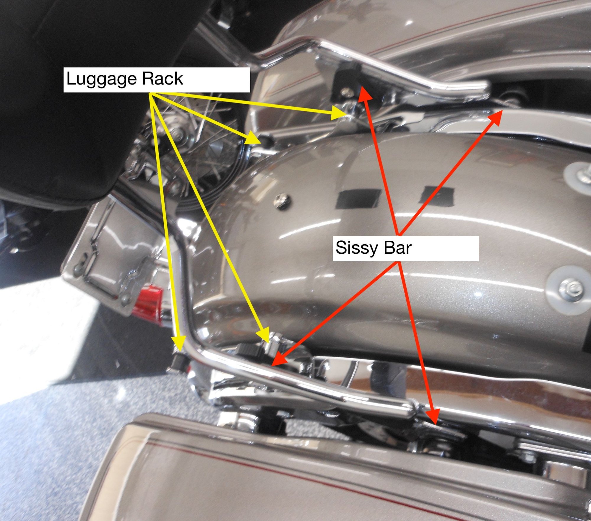

I decided to consult my 2010 Parts & Accessories catalog.
I found the info below. It shows two different detachable sissy bar side plates. One round and one square. Both with the internal screws to tack on a luggage rack as with the earlier Softails. One of the sissy bars pictured has a luggage rack attached.
Looking throughout the catalog, there were a few sissy bars that were welded to quick detach side plates (like my Crossbones), but most were bolted to the quick detach side plates like the earlier Softails.. That would allow a luggage rack to added to the rear of the sissy bar..
I will have to conclude that the type of detachable side plates will decide if the bolt-on luggage rack will fit...
If it has bolt-on sissy bar side plates it should be easy to fit a luggage rack (size dependent).
If it has a welded on sissy bar, I do not know how to attach a rear luggage rack.
Certainly not difinitive information, but I hope this info & the pics help...

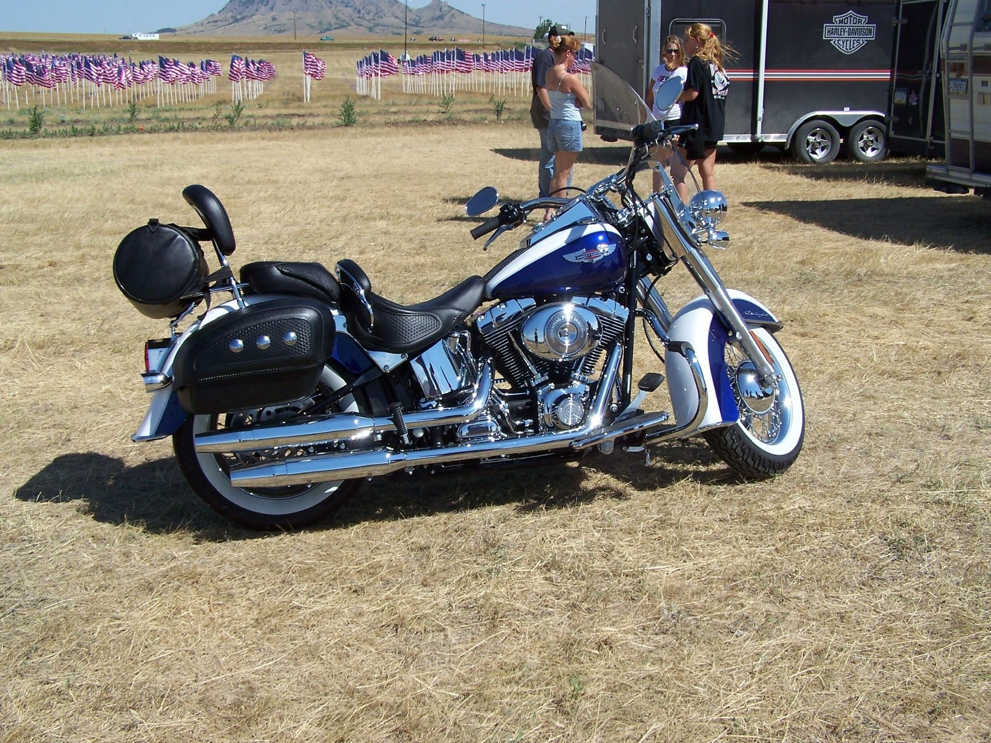

Going by memory, the Deluxe had a matching round tube sissy bar. Here is a pic…
Ooohh, Thank you. Thats what I think she needs. Thanks Strat
