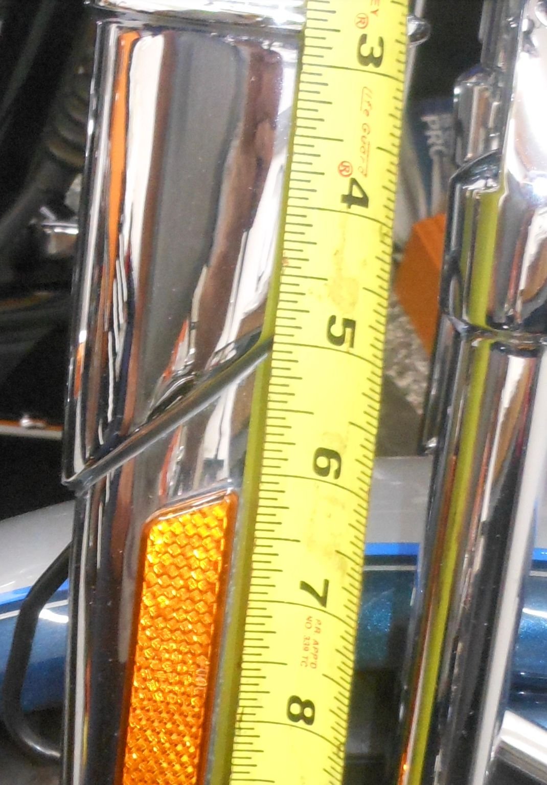

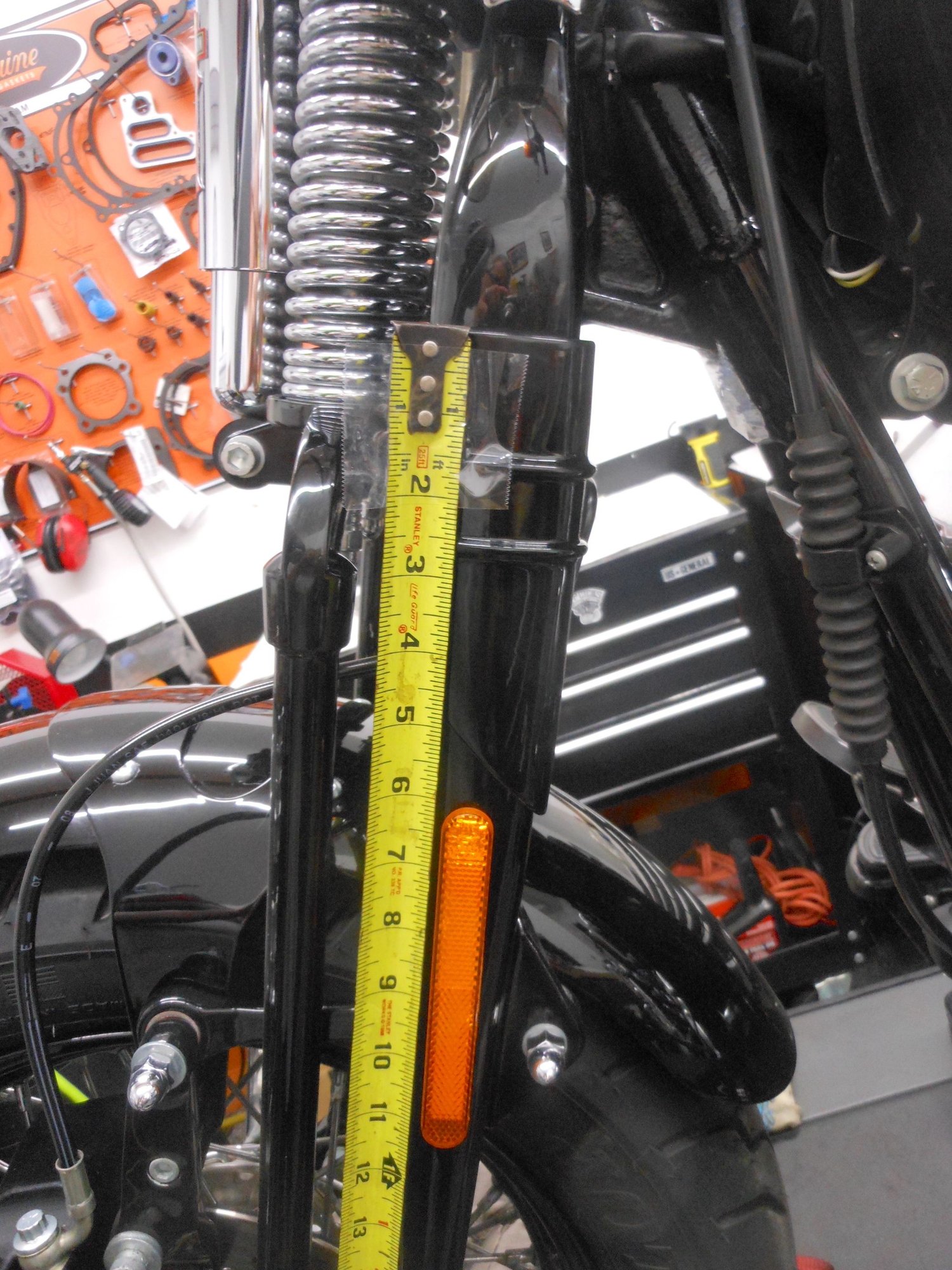

Want to install left and right front fork reflectors that are missing anyone have the measurements of how far down they are from the top?

See for yourself....
I have two Springers:
2001 FXSTS
2009 Cross Bones
I hope these pics help....
